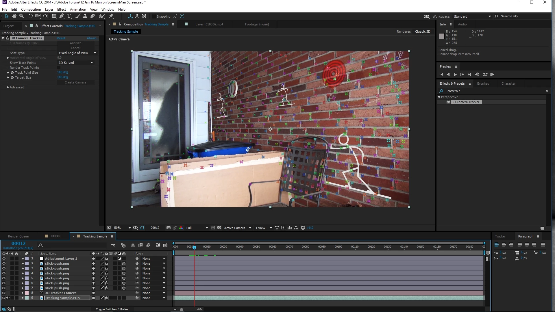

If that example shot is what they are kind of going for, I'd agree with Szalam, no markers needed, not to mention you'd then have to remove the markers.
There is some decent camera movement in that example, but it is smooth which helps.  The AE tracker works amazingly well though.
The key is having many features to track. Again, in the example video, there's tons to track so I'd say, have good lighting, steady and smooth movement preferred, no track markers.  Then use the AE tracker and I think it will do quite well.
Since I had some time, I did a quick test for you.  I literally, shot this, did the tracking and rendered in less than 15 minutes with pretty darn good results.
Let me know if this helps. The screenshot shows the how the tracker looks with one target and the finished product at the link.
https://youtu.be/wYQL94lCsRA
PS:  I suppose it goes without saying that I added the little stick figure guys.
Eric
