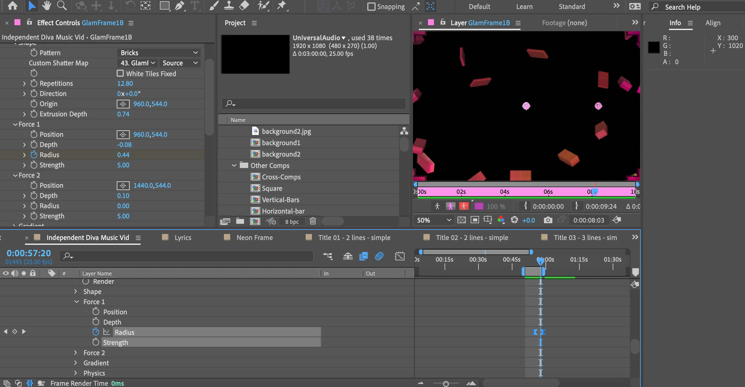

Raising my Mass Variance Percentage
Successfully
Removed the Graham Crackers,
from Even Being In Frame.
Joost van der Hoeven
December 10, 2021
Try to fix this by making the Extrusion Depth higher.
More info: https://helpx.adobe.com/after-effects/using/simulation-effects.html
One&DoneAuthor
December 16, 2021
0.74 is a fairly realistic brick size via extrusion depth, yet there are a couple graham crackers that linger. It goes so fast that I may be able to get away with the remaining couple though. Would be nice to select the blocks I do not want and simply delete. Perhaps I have some randomizer on or something...
One&DoneAuthorCorrect answer
December 16, 2021
Successfully
One&DoneAuthor
December 10, 2021
+They seem to appear towards the end of the keyframe segment when they do
