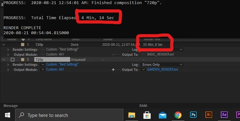

UPDATE: Now here's the kicker.. A friend advised me to try out RenderGarden to utilize the multi thread/core aerender advantages. So i installed the script. Loaded up the same project i did originally, and set it to 6 cores (as advised by rendergarden for a 12 core processor) and hit render!
That same 4 hour render took less then 30min. ?!?!? So obviously there's something wrong with AE and its standard rendering process with my machine. I'd like to solve this issue and not have to rely on a $100 script to do it.
here is another project i tested which was only 2 minutes in length. As you can see, Standard AE took 38 Minutes to do what Rendergarden did in 4 min. So either AE has the most inefficient rendering out of the box in history, or something else is up.
