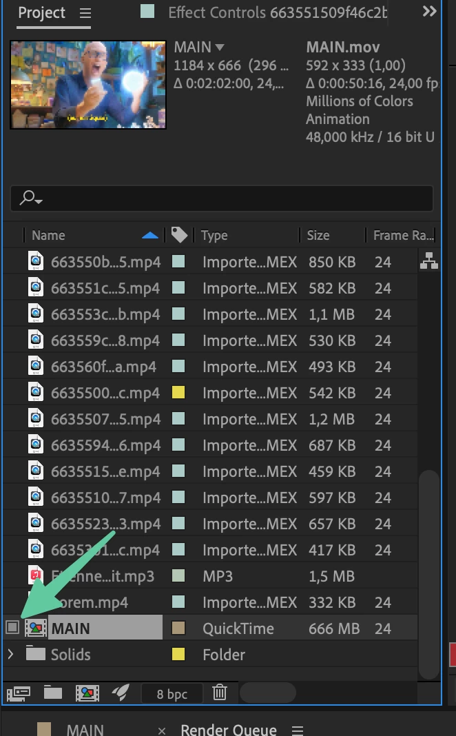

I've got the same issue on Windows. I've opened the file on my mac and it works back.
May 5, 2024 11:13 AM UTC
Ok, It was because I've render a proxy on my mac. Try to press that square to disable it.

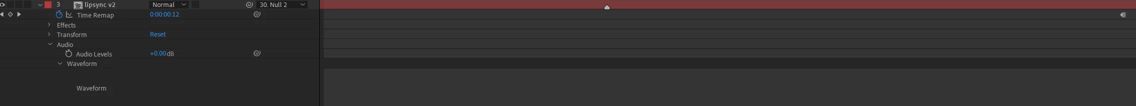

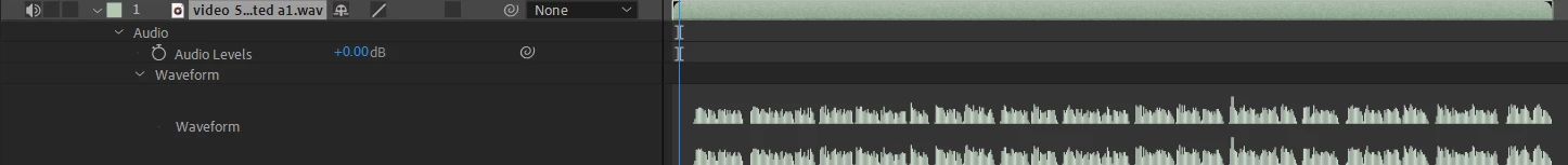

Sep 14, 2021 11:15 AM UTC
Hi, so here's two screenshots of two compositions.
The first one is the first composition in which I have the sound (the character composition I have in the example):
The second screenshot is of the second composition. I only have a time remap to keep the last frame (the pre-comp in the example):
Sep 14, 2021 11:16 AM UTC
Oh I muted that layer just before the screenshot by accident. It still won't play audio if unmuted.
