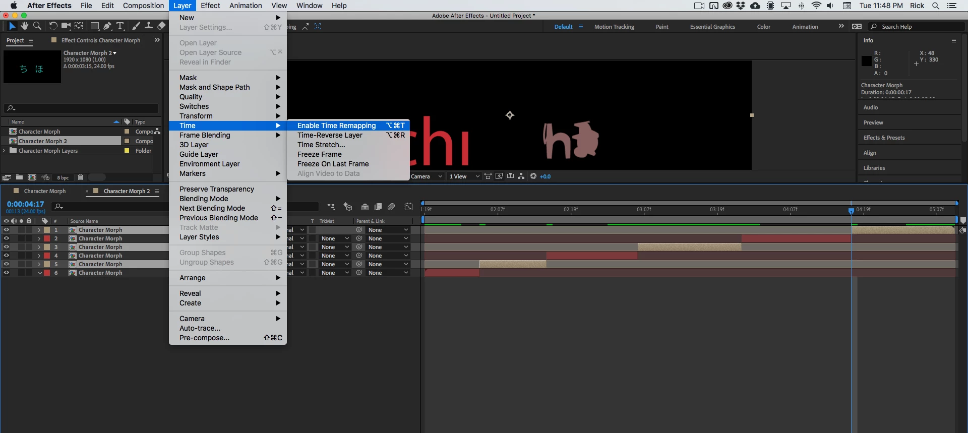

The easiest solution may be to just put a cut every time you want to speed change in Premiere Pro, then do your speed changes there and forget about AE. If you want to ramp up to speed changes just split the layer in AE every time there is a speed change. You could then set a time remapping keyframe at the end in the air point of each split. Drag the last keyframe around to change the timing and then ease then both.

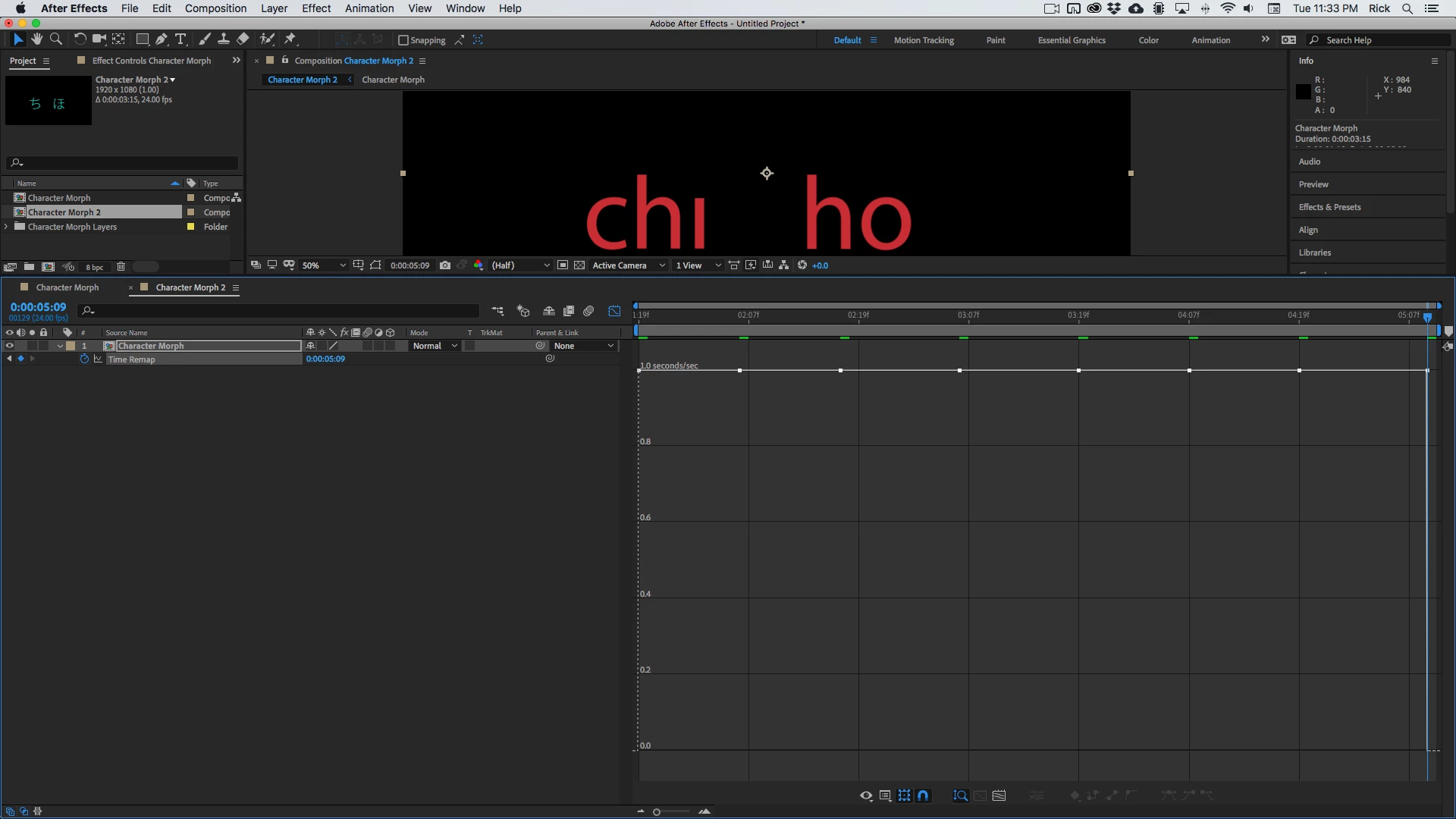

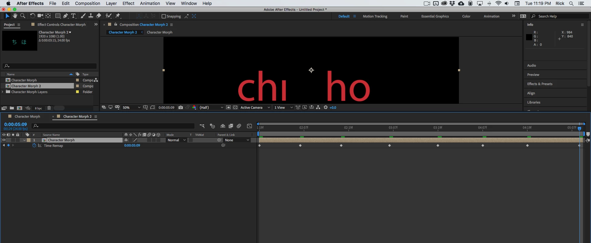

This is what doing everything on one layer looks like. You start with keyframes set for every spot where you want a speed change.
The little diamond in the timeline is used to add keyframes without changing the timing of the shot.

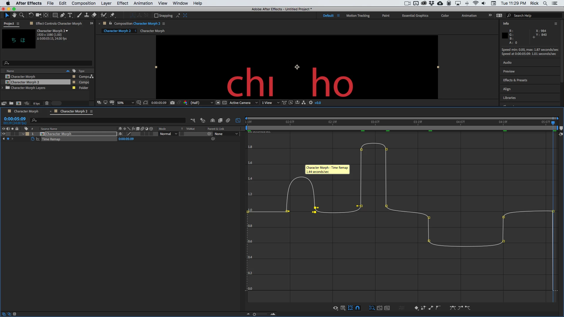

The speed between all keyframes is 1second per second or real-time. Now you start moving groups of keyframes around to speed up sections and slow others down.
Moving a pair closer together makes the speed go up. Farther apart and the speed goes down. You can tell how fast the clip is playing by looking at the ratio in the graph editor. The top part of the second pair of keyframes is at about 1.4 seconds per second so the clip is playing back about 150% faster than normal. This can get really confusing really fast.

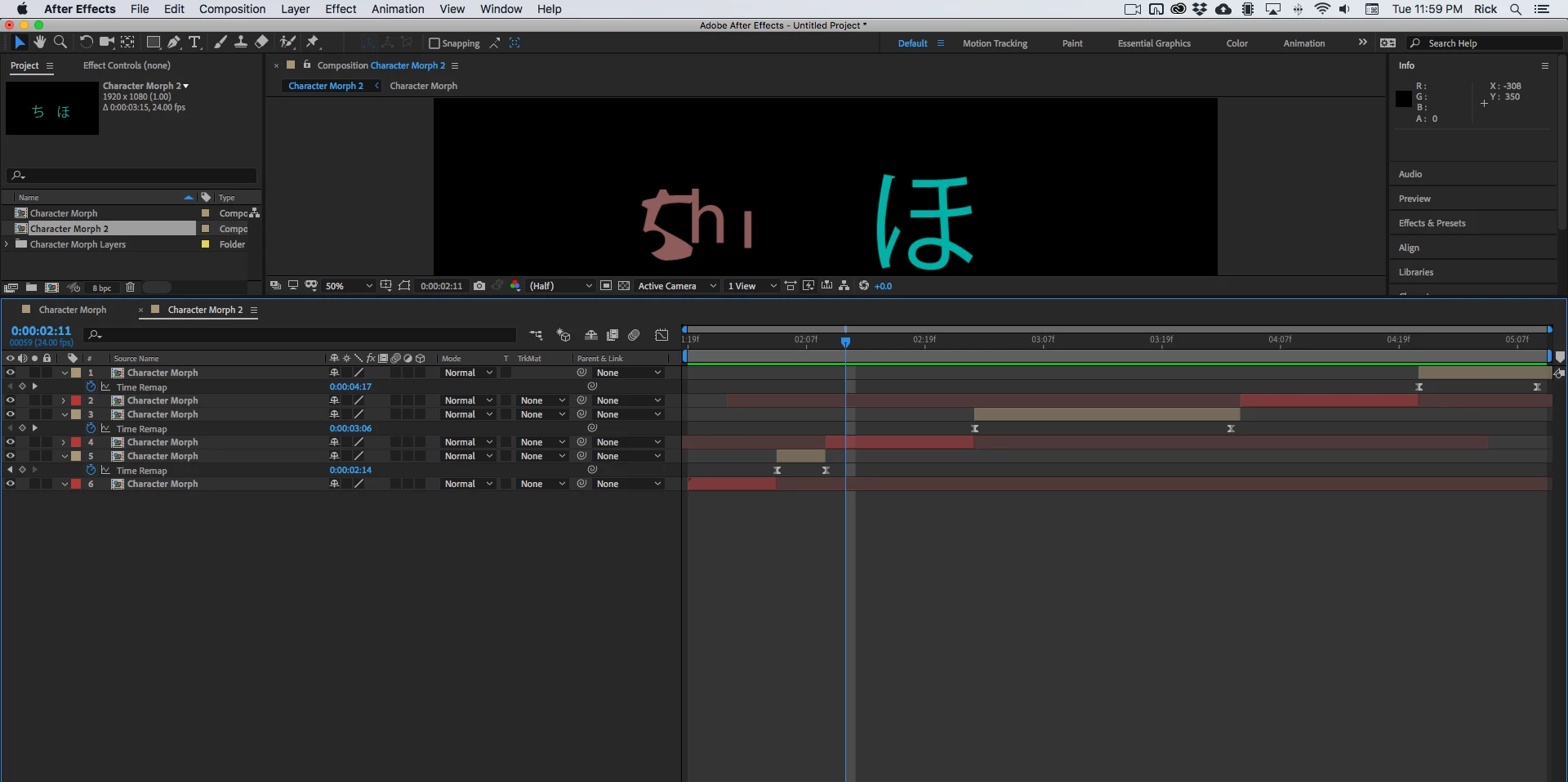

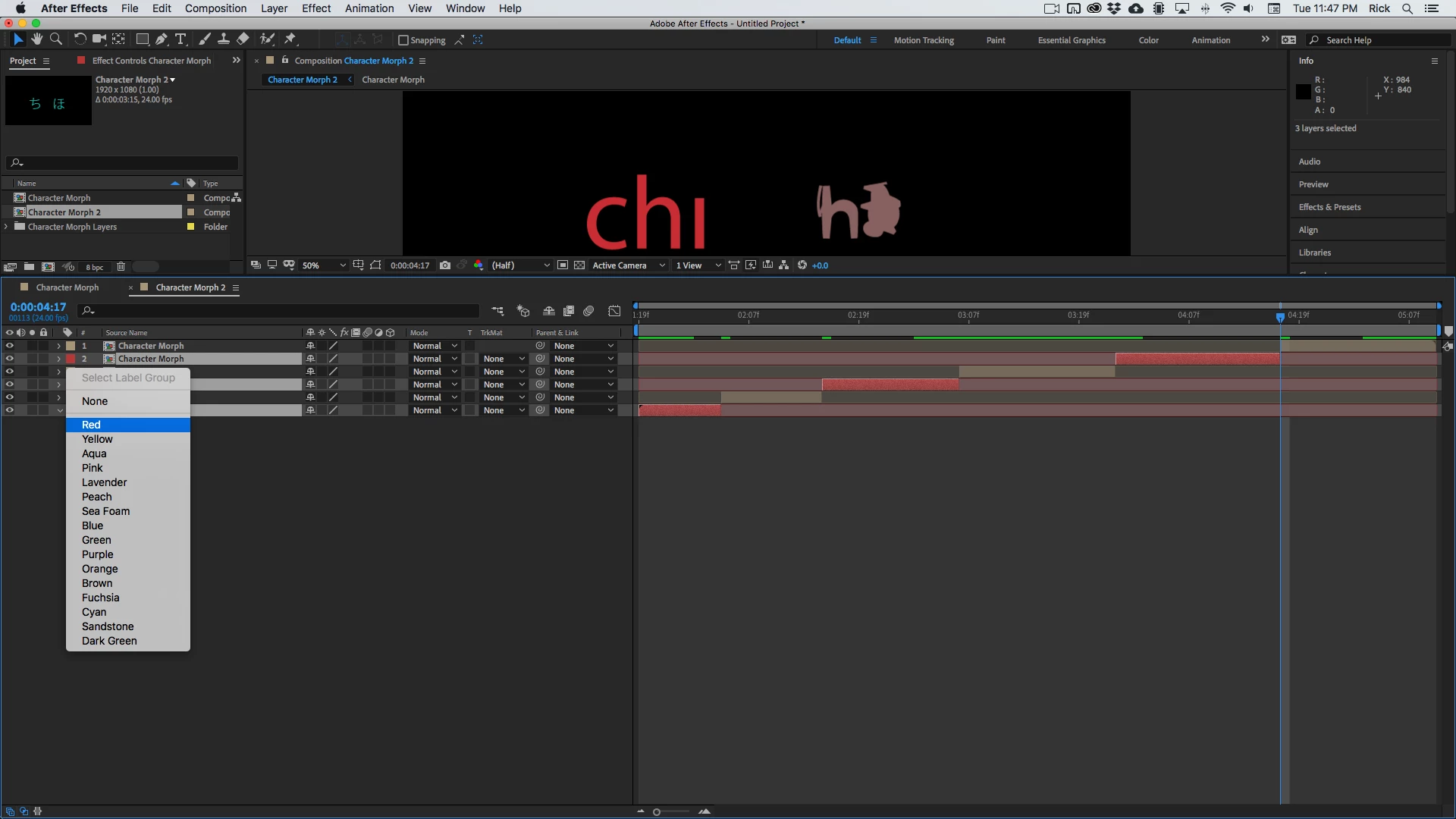

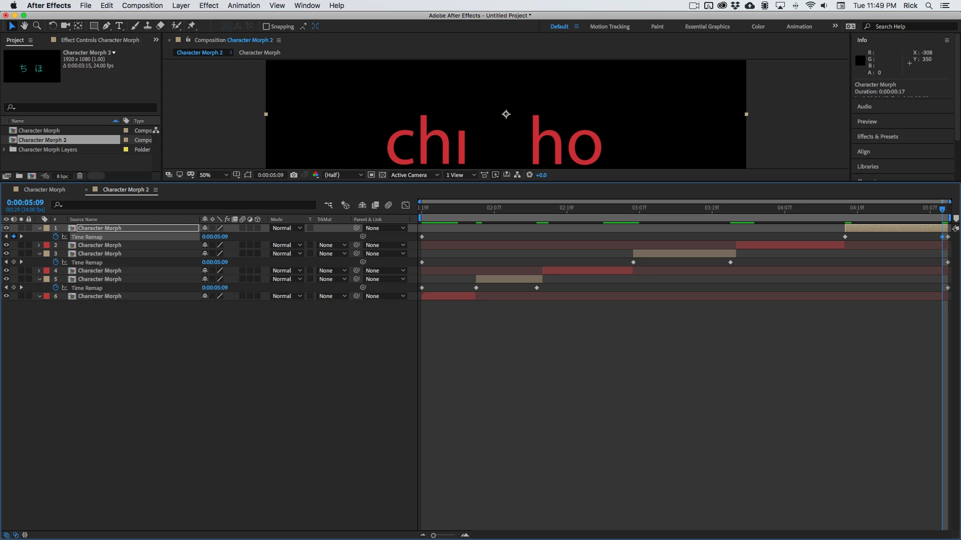

The other workflow is to split the layer everywhere you need a keyframe, pick the layers that you want to change, assign them a label group, add time remapping to just the clips you want to change, set a new keyframe at the in and out point of each layer, then just drag the last keyframe around for each clip to get the playback speed you want. All that is left is to adjust the out points of the layers you edited and line up the cuts. Personally, I think this is an easier workflow and you never have to worry about the real-time sections playing at a different speed. That workflow looks like this:
All you have to do is add a little easing to the time remapped layers and you have a nice transition from real-time to slow or fast-motion.
