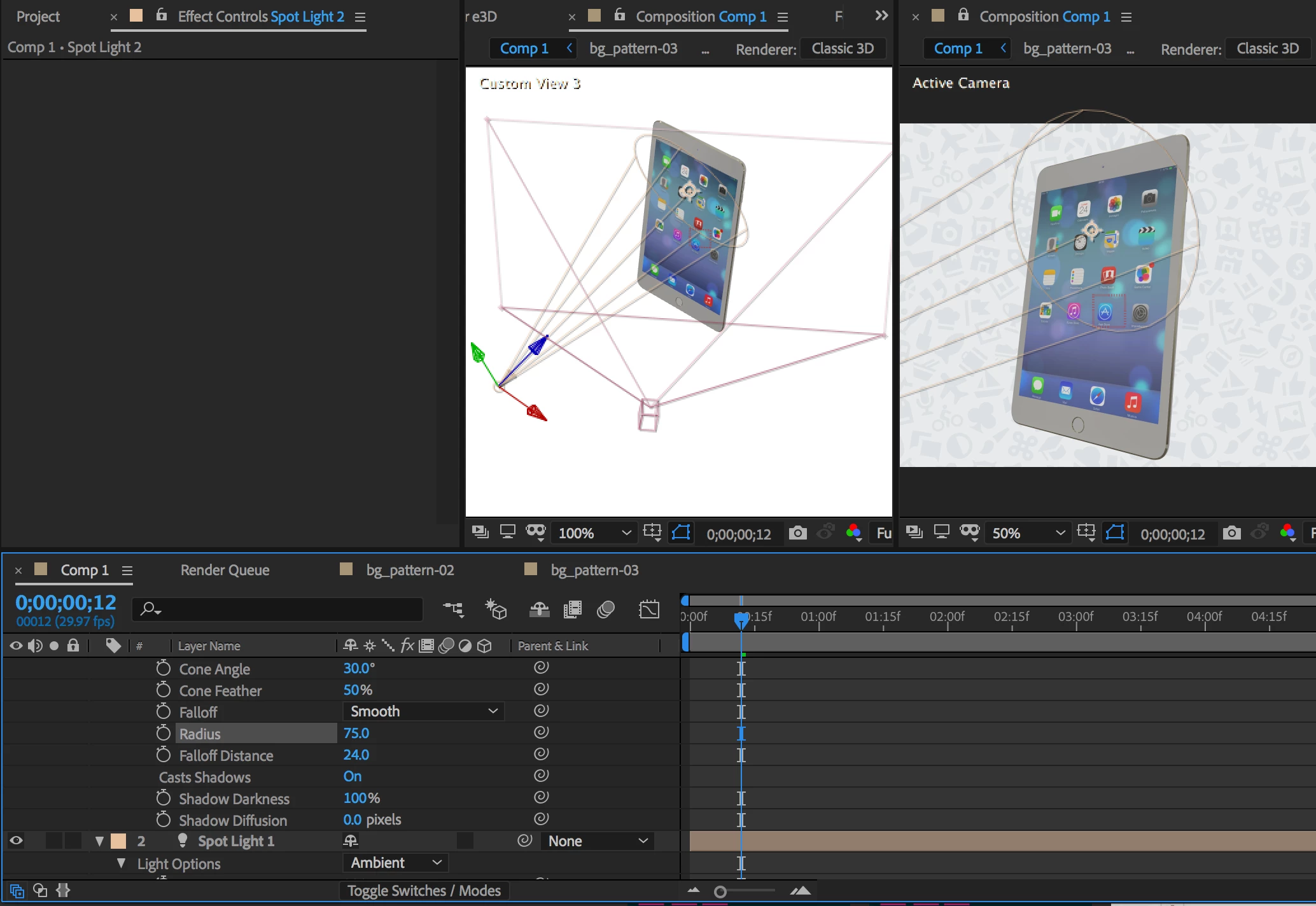

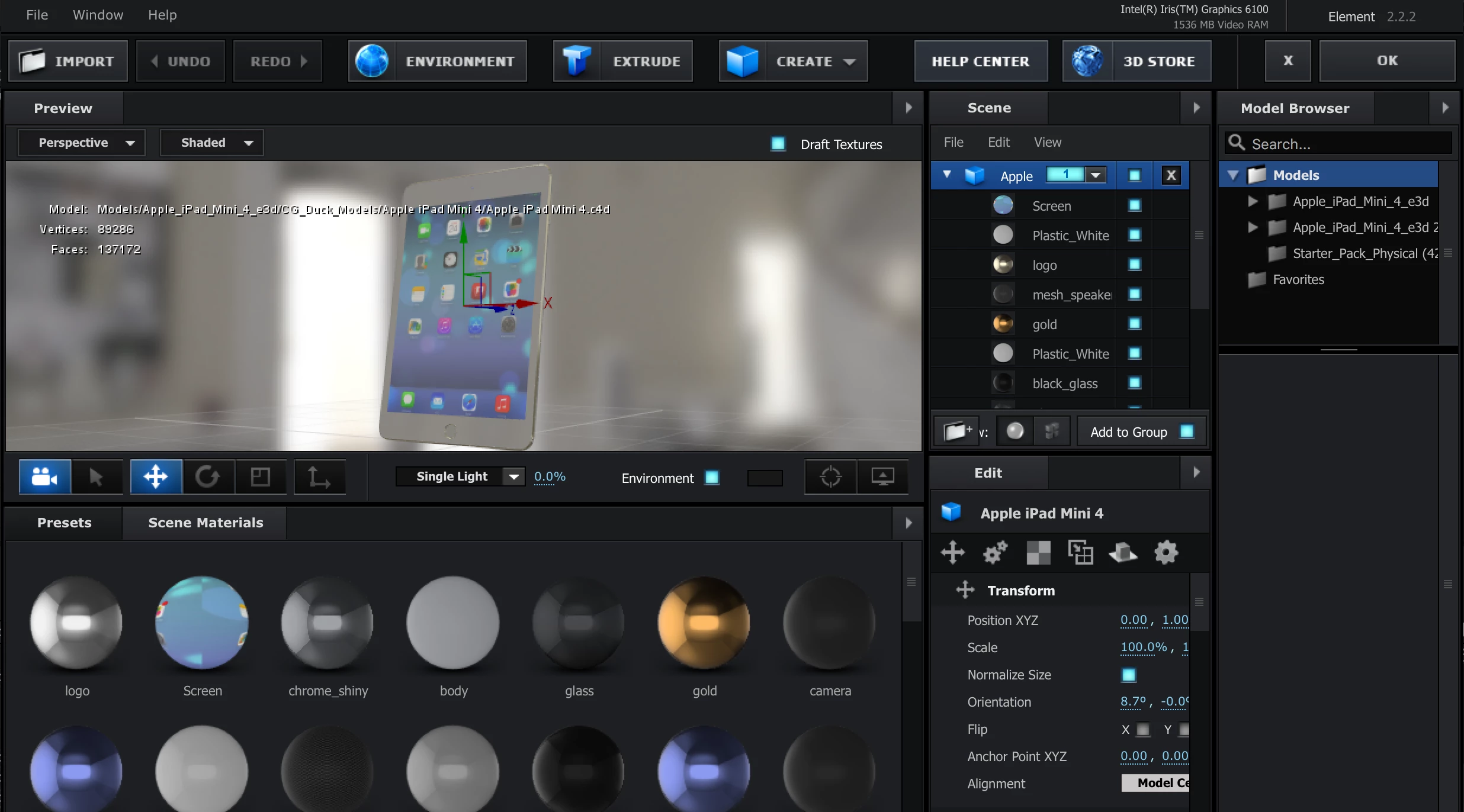

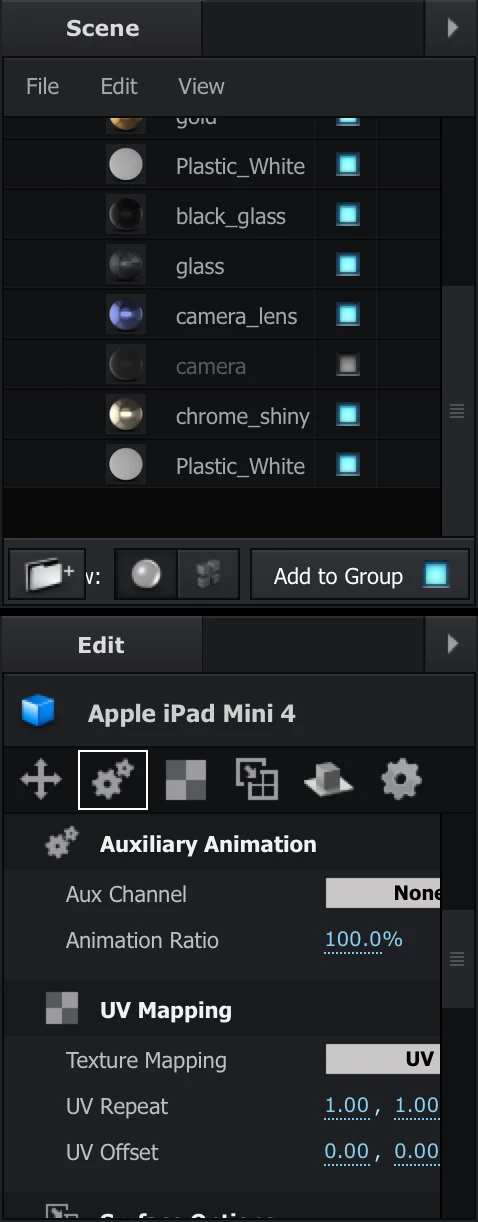

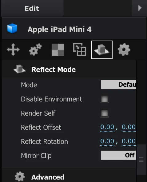

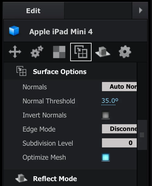

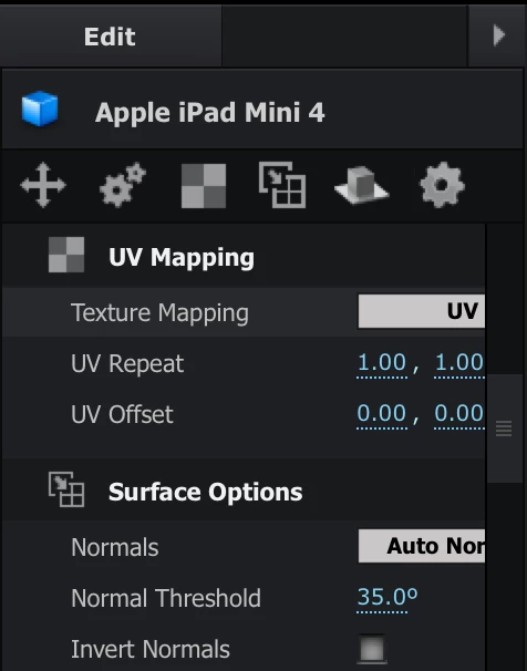

    Hey guys. I post my Element 3D screen shots. Do you see any mistakes? Thanks for the help!

    It would be helpful to see your element 3D settings too

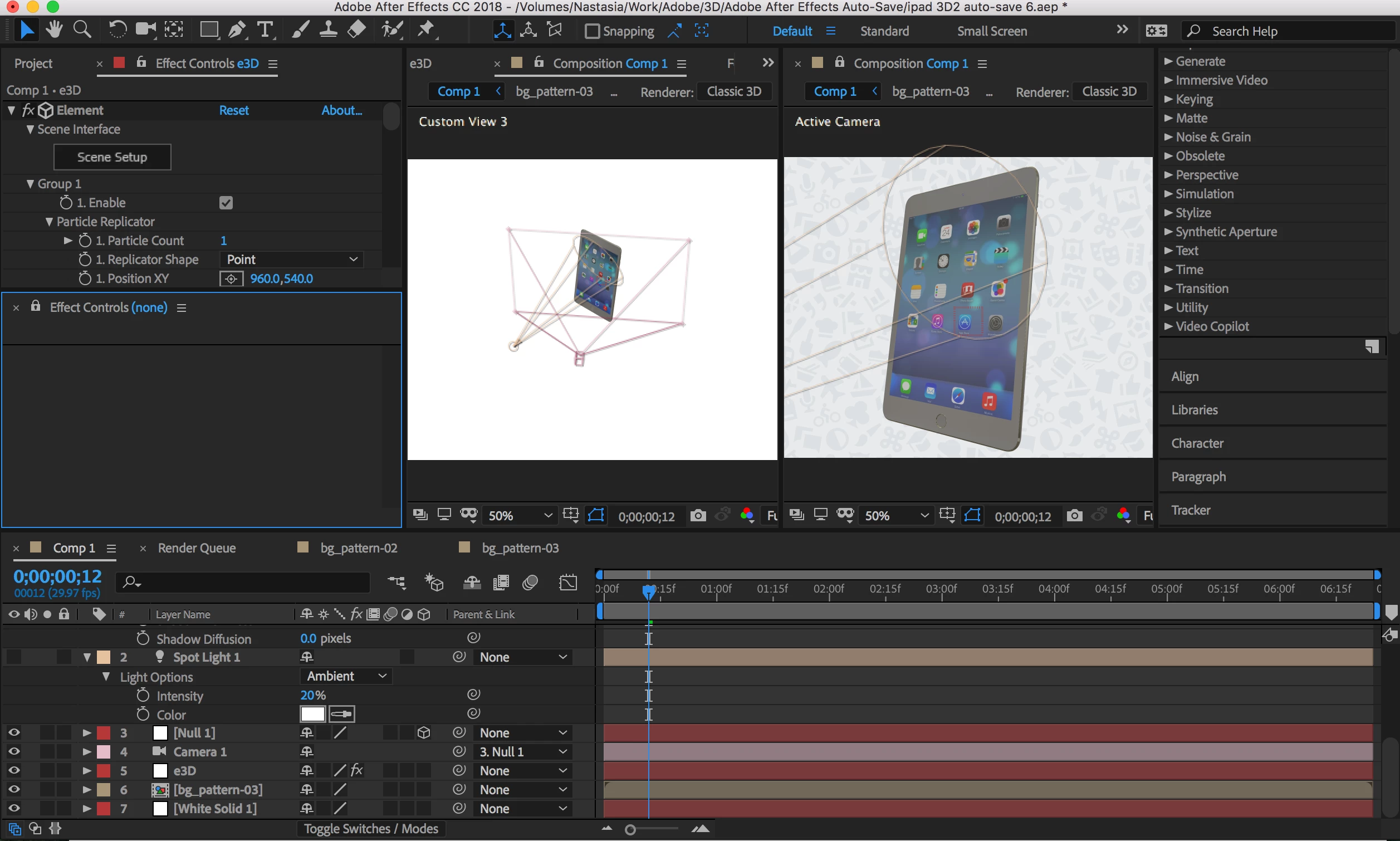

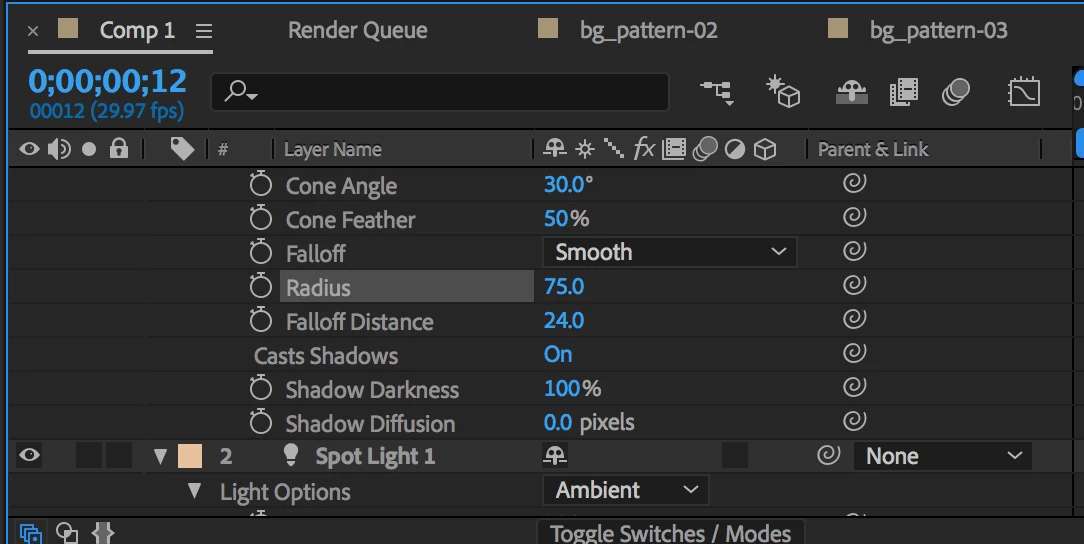

    Turn off "Spot Light 1," which is really an ambient light and see if that's overpowering your actual spot light. Otherwise, do what Angie suggested and post your E3D settings, as well as a full screenshot of your interface.
    September 17, 2018
    Here is a screen shot with ambient light off
    Here is with an ambient light on:
    Ambient light affects the overall lightness. I cannot get the spot light working
