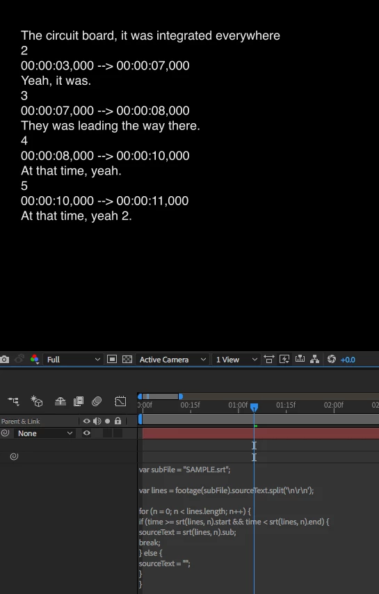

Hey there, i'm not sure what i'm doing wrong, but when I apply the script, it's displaying the entire contents of my SRT file minus the first two lines. Any ideas?

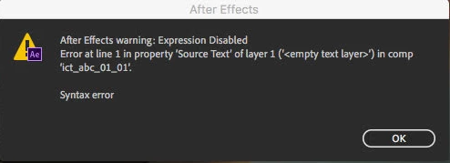

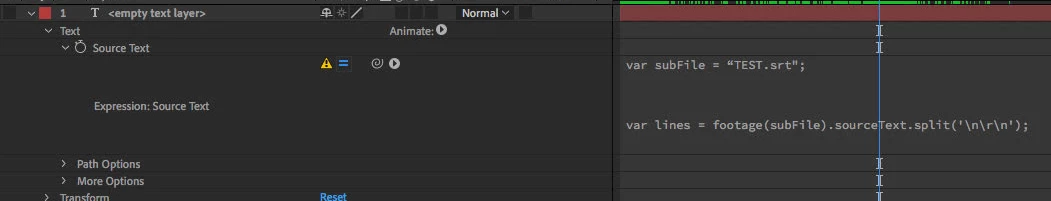

This looks great, but i am getting an unexpected expression error, any ideas on this would be helpful,
1 var subFile = “video-1.srt";
Oct 3, 2018 7:52 AM UTC
Hi jonothonrossi,
you might want to look at the text formatting of your code. When I paste it into N++ the first quote symbol looks to be wrong. Check my screenshot.
hope this helps!
