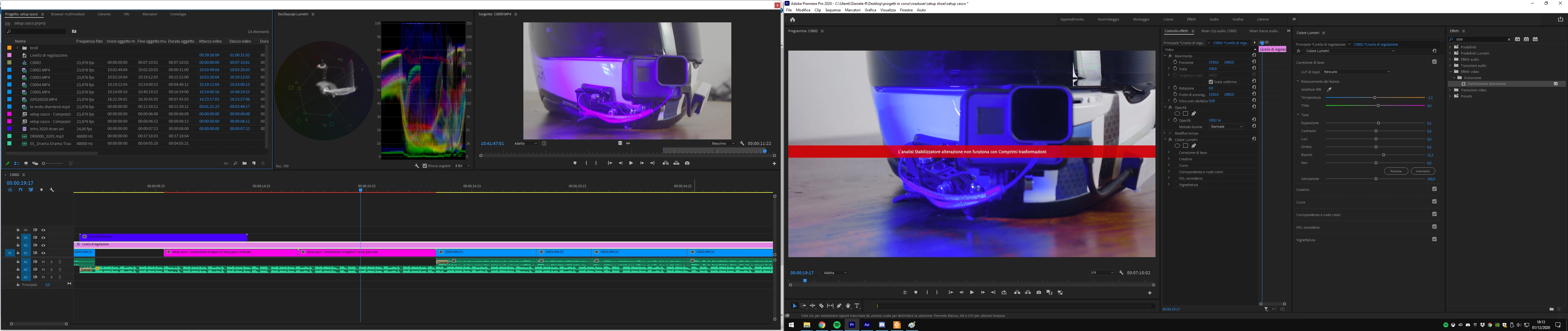

Hi everyone, first post here.
I have this issue that's driving me mad and i don't know how to fix this or why it shows up, i'll try and explain (also, i'm italian so sorry in advance for any language barrier related problems):
I have a clip in Premiere Pro, i need to stabilize and ad 3d tracking for some text.
No issues about stabilizing in premiere pro, same for 3d tracking in After Effects, everything works smooth without a problem.

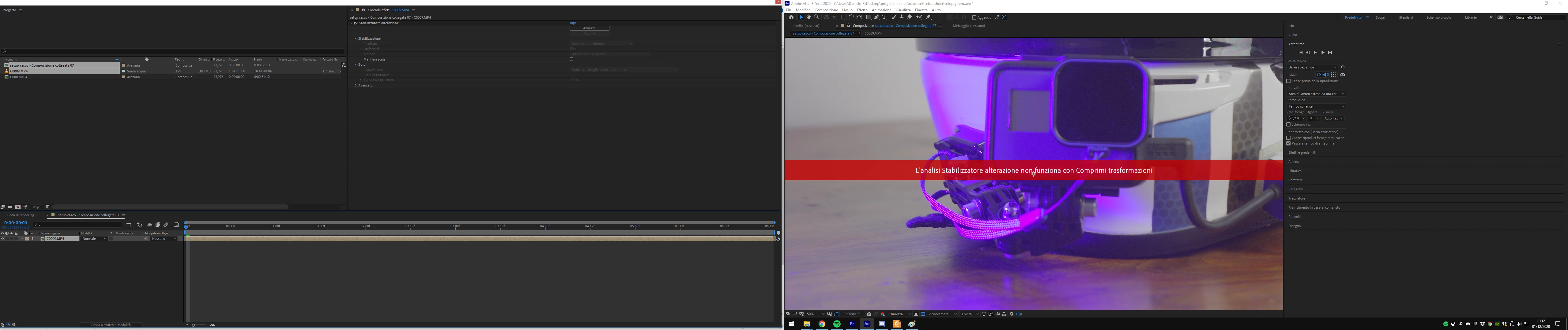

The issue pops up when i try to stabilize in PP, then right click on the clip and select "replace with After Effect composition". As soon as AE launches a red banner appears in both PP and AE which says
"3d camera tracker analysis does not work with collapse transformations" or "stabilizer analysis does not work with collapse transformations" (here's the italian version if the translation isn't correct and you want to give it a try "analisi tracciatore non funziona con comprimi trasformazioni", "analisi stabilizzazione e alterazione non funziona con comprimi trasformazioni" )
How do i fix this? Why does this banner show up? Thanks to whoever can help me!
i'm using the latest versions of both software
