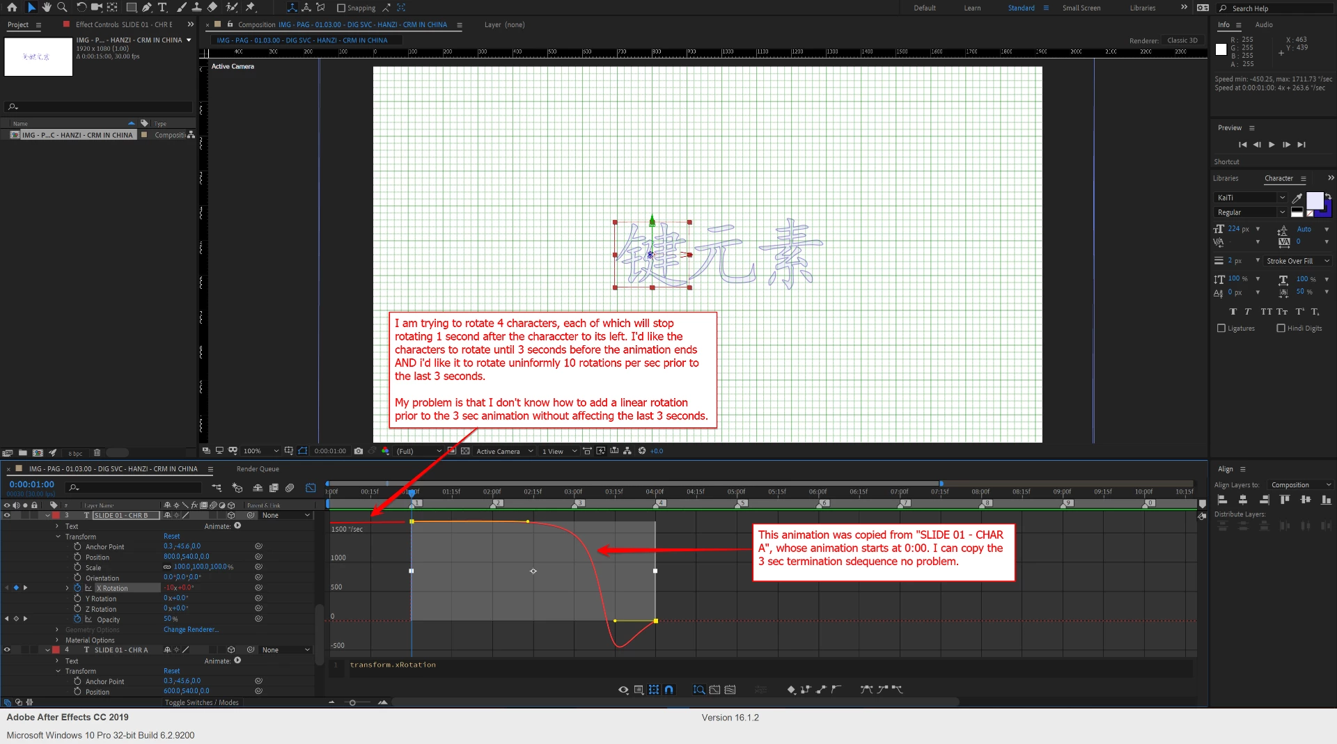

I have 4 (Chinese) characters, each in a separate layer, horizontally aligned over a 15 sec timeline. 3D turned on for each character. I'd like to:
- start all 4 characters rotating at a constant 10 rotations per second and
- terminate each character's rotation on a staggered basis (character A stops at 4 sec, character B at 5 sec, character C at 6 sec and D at 7 sec.
The termination curve for each character should last 3 sec and should be identical (as shown in the attached screenshot)
-  to accomplish this, I've copied the termination sequence (a 3 sec keyframe) from character A and pasted it onto the rotation attribute for each successive character at 1 sec, 2 sec and 3 sec, respectively.

I'd now like to add a constant rotation prior to the 3 sec terminating animation for each character so that all characters start spinning at 0:00. However,
- when I add a keyframe prior to the 3 sec termination keyframe, it distorts the 3 seq keyframe curve.

Here are the settings for the second character B with a red line from 0:00 to 1:00 where I'd like to have the constant rotation
    Correct answer Martin_Ritter
    Motion always happens between 2 keyframes. So, what you need are 3 keyframes as you can see in the example from Rick of letter C. There is no linear rotation keyframe and no curved keyframe but a motion between two keyframes which is linear or eased (curved).
    Key 1 to key 2 is a linear rotation, you are using linear keyframes. From key 2 to key 3, you apply ease-keyframes making this to an non-linear motion. Play around with the speed editor to get used to it how to edit speed graphs. It's a bit confusing at the beginning but makes sense after a while.

    I admit it was a bit unclear explained.
    Usual, you start with linear motion, put in all keyframes and values and make a rough timing. In the next step you change the motion style to a more living, characteristically one by applying ease and editing the speed graph. So, in the end you'll have KF1 as linear (because that is what you want there), but KF2 and 3 as ease. Just like in Ricks screenshot - the letter C.
    To get to smooth transition from linear to ease (KF1 to 2), play around with the speed curve editor until you get used to it.

    For some odd reason, I thought that a keyframe was the begin point, end point and motion in between. I now understand that each point is a keyframe.
    so...I was grabbing both the beginning and ending keyframes (K1 and K2), but in so doing, I affected the motion between K2 and K3.
