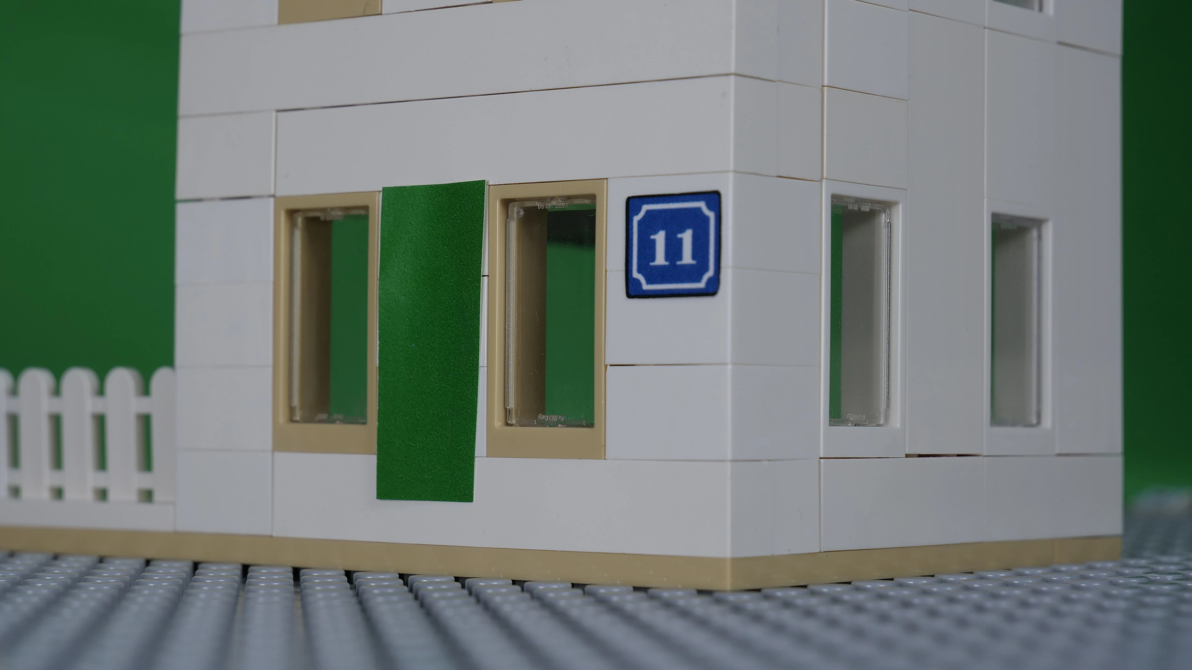

Question from a newbie:

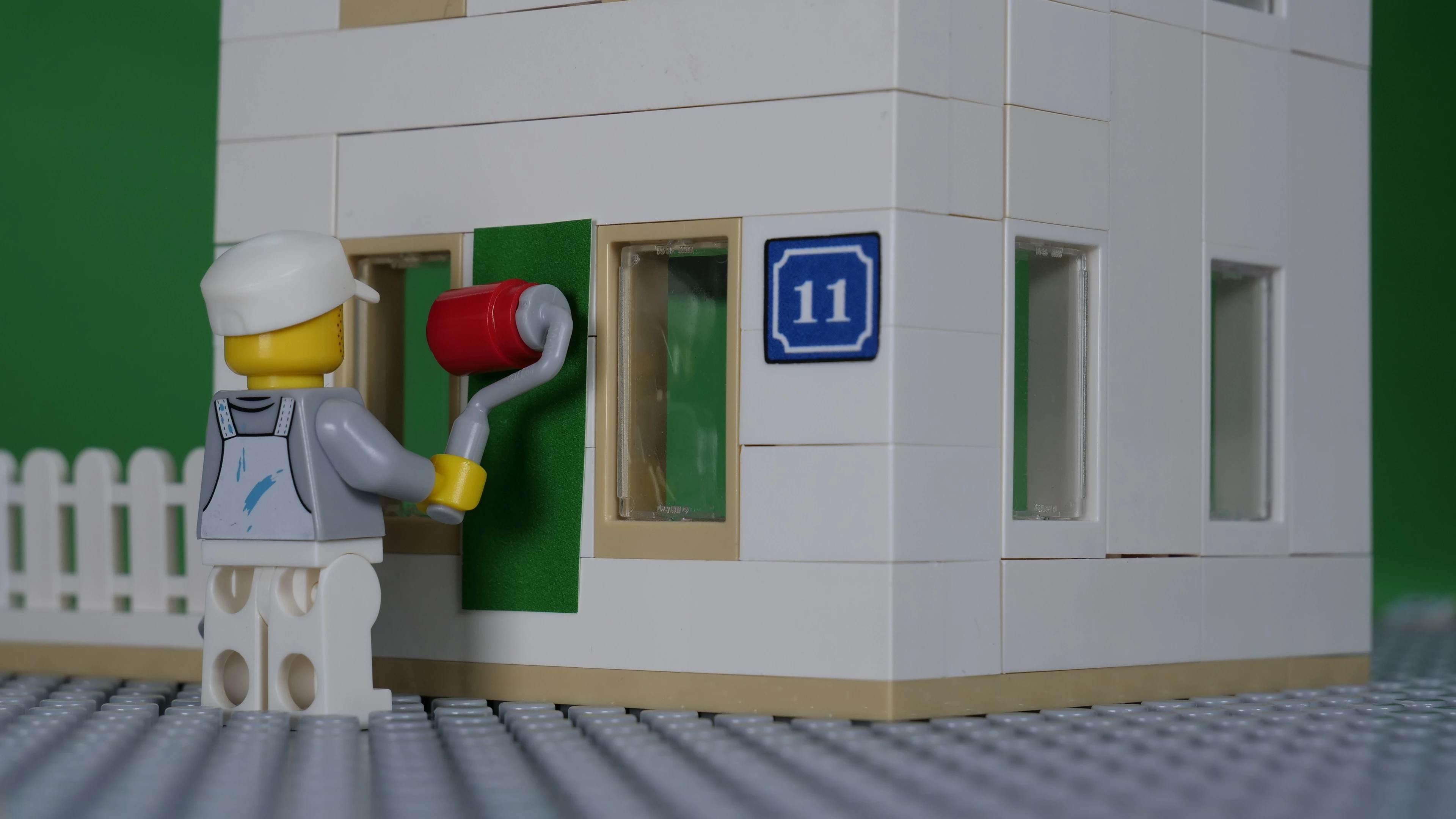

I am doing some stop motion and about to make a short sequence with a decorator painting a wall with a roller. For each roll up and down the colour should get more and more saturated until the colour of the roller is matched.
I have tried a few different things but none create good results and workflow is not elegant to put it mildly.
Thought using green screen would do the trick but can't get my head around how to do it somewhat elegantly.
Any ideas or pointers much appreciated.

Use a different color for the tape to be able to generate a separate matte for the roller streaks. Also White is not a color, it's just brightness/ luminance. In an ideal scenario one would build the model in a controllable color (Bright Light Blue, Pale Yellow) and then desaturate it or crank up the color. That would also have the benefit that some of your painting could be done organically just by drawing a few masks and using those for color corrections to shift the hue and saturation.
