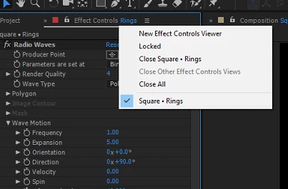

This is what it should be like. But if you choose to close the effect control for the current layers and then select the layer again.
It will turn into this.
Aren't they supposed to be the same?
Correct answer Rick Gerard
It looks like you have found a bug. If you view that menu once, then select any other layer you won't see the layer name selected at the bottom. If you narrow the ECP you should bet a >> icon on the left. Click on that icon and you have the ability to see the selected layer even if the ECP is locked. If you have locked an ECP and have opened up another one for different layers the >> icon will give you the option to choose between the two.
As I think of it I think this is less of a bug than an incomplete redesign of the UI. I've never used the list at the bottom to get to another ECP.

I have never came across this because I use the shortcut F3 to reveal the effect controls that a layer. highlight/select the layer in the timeline and press F3, this will save you much time instead of fiddling with the mouse on names and tabs. as I tested it here with F3, it seems it does not introduce this behavior and work as expected. note: you don't need to close the effect controls for a layer because they change as you select other layers. leaving effect controls panel open really isn't supposed to bother you (or if you have many effect controls panels open) since they are hidden anyway.
if you do want to submit a bug report, you can do it here: Feature Request/Bug Report Form

when clicking on the blue name of the item in the effect controls, you can see at the bottom all the opened effect controls in your project. if you closed them, you won't see them at the bottom.
April 25, 2017
Close them first. And then select your current composition. The Effect Control will again have the blue name. But this time when you won't see anything at the bottom.
