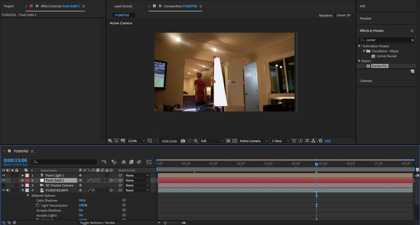

I was working on a camera projection thing, and I came across this weird problem. The plane I was projecting on had a white shape running through it, when I changed the rotation of the plane, it moved the shape, but messed up everything else. Anyone know how to fix this?

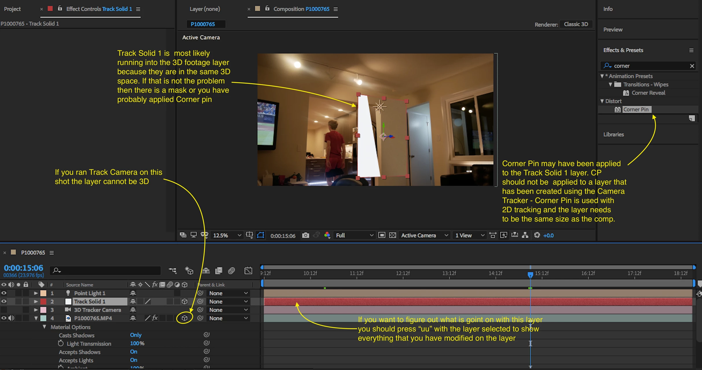

I see a lot in your screenshot that tells me you have not done much homework on the Track Camera tool. Here are just a few of the problems:

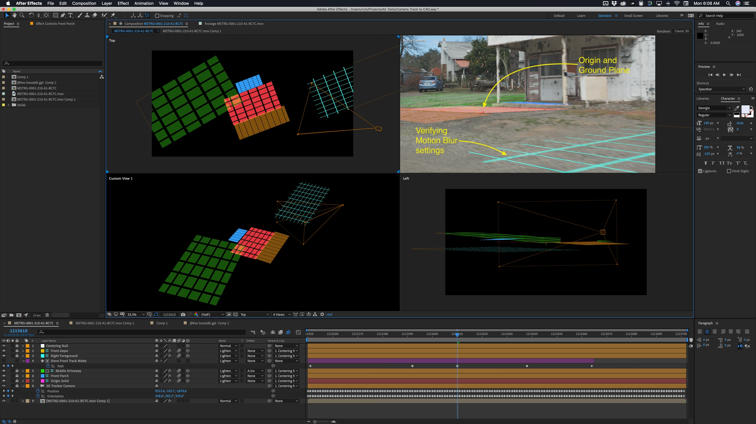

Here's a screenshot halfway through setting up a shot where I need to put a crashed truck behind this old building and add an actor to the front porch that we will shoot on green screen, and some additional 3D animated objects in the foreground. Note the reference layers. A track matte created from a shape layer for the edge of the building only needed a few keyframes. This Comp is ready to Export to C4D so I'll have some geometry that matches my scene. I also used the parent all the 3D layers to a 3D null at 0,0,0, then move the null to Comp Center to normalize the 3D working space. This is how you use Camera Tracking. I should do an in-depth tutorial. Oh wait, this shot is for my upcoming advanced compositing and visual effects workshop. (yeah, that was a cheap plug)
The production notes and the camera path will give me a reference I can use to shoot the actor so the perspective matches when we shoot that shot. The actor will be a simple 2D layer on top of everything and a simple animated track matte to put the actor behind the post on the screen left part of the front porch.
I hope this helps. There is nothing wrong with your project but workflow.
