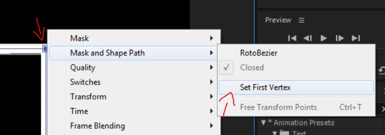

I converted the rectangle to a Bezier Path, then keyframed the position of two of the points.
when converting a parametric shape to a bezier path, there is a nasty bug that causes the first vertex not to be registered. once you register it (right click on the the square vertex, mask and shape path -> set first vertex) you should be fine.

This solved the problem for me!
