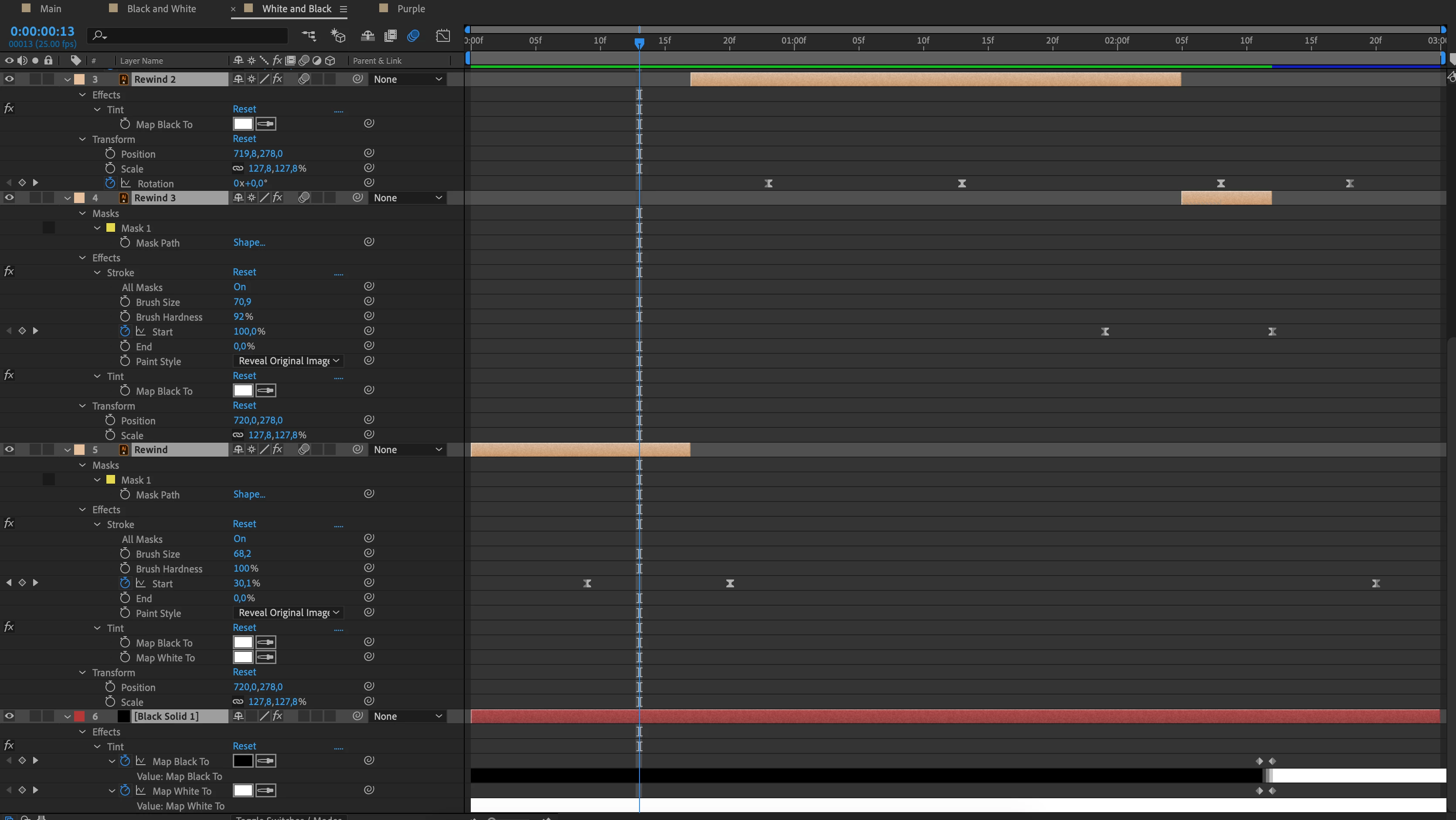

Hi Rick,
See the screenshots below.

Andrew Yoole
June 23, 2019
Is there a black solid in the background of your black background versions?  If not, try adding one.
I'm thinking that you're rendering to a format with a straight alpha channel, and thus seeing the unmultiplied pixel fringes of the white objects.  OR the mask you're using to reveal the stroked animation is affecting the alpha channel.  Please post the output setting you're using.
If the above is NOT the case, please post a timeline screen grab with all animated properties visible.

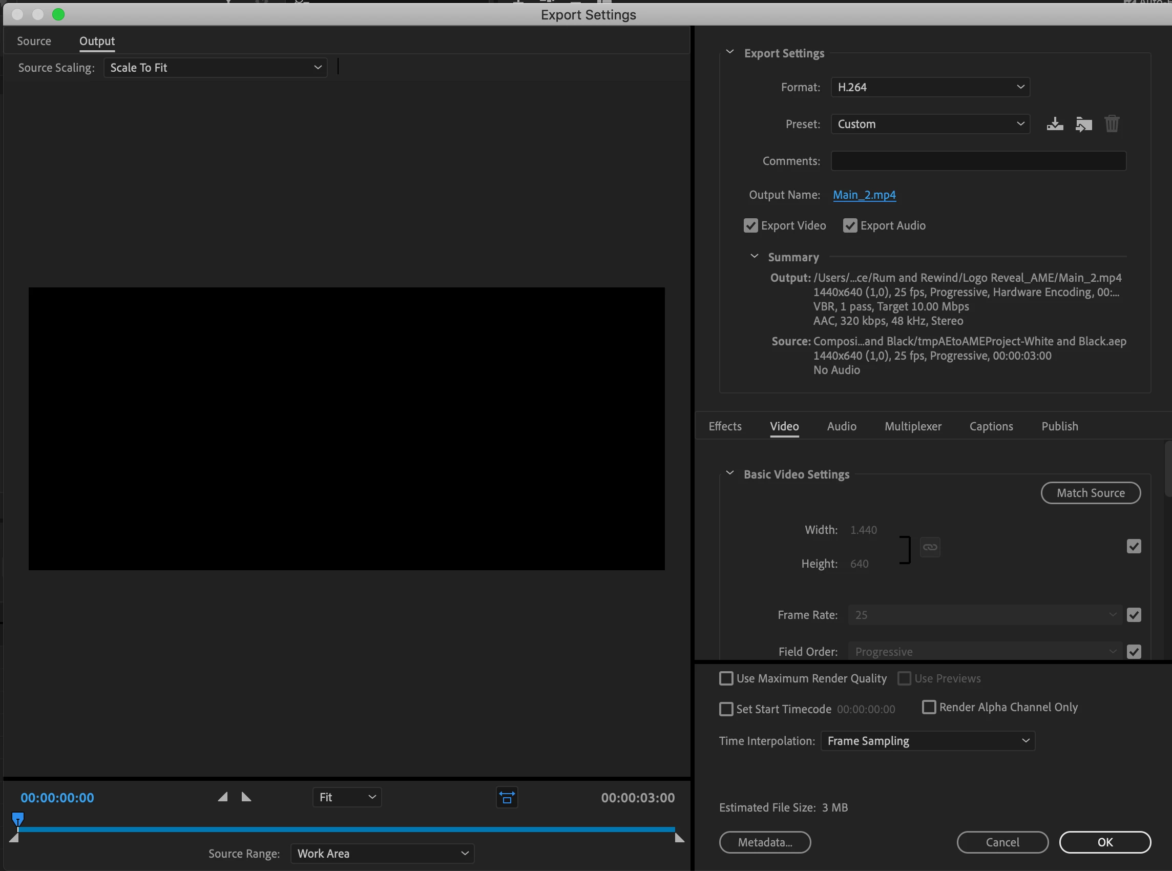

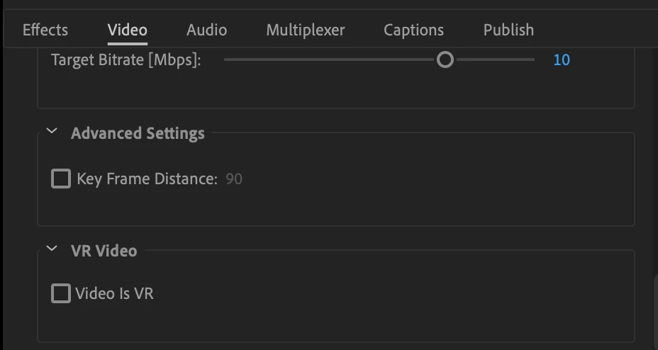

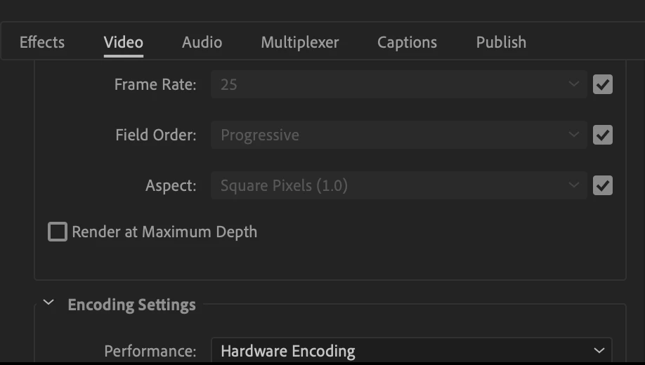

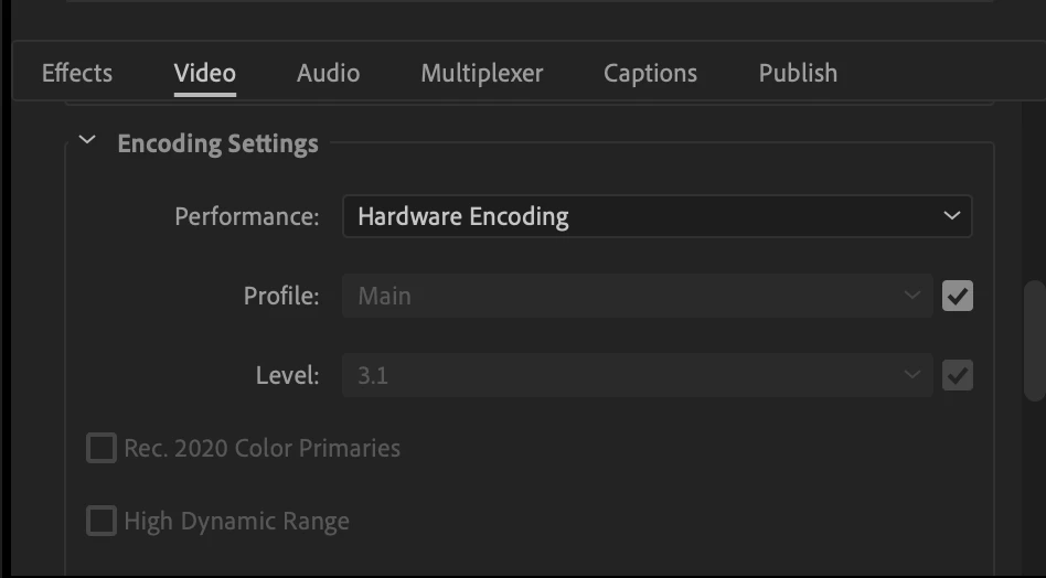

I've attached the output settings below. Thank you!

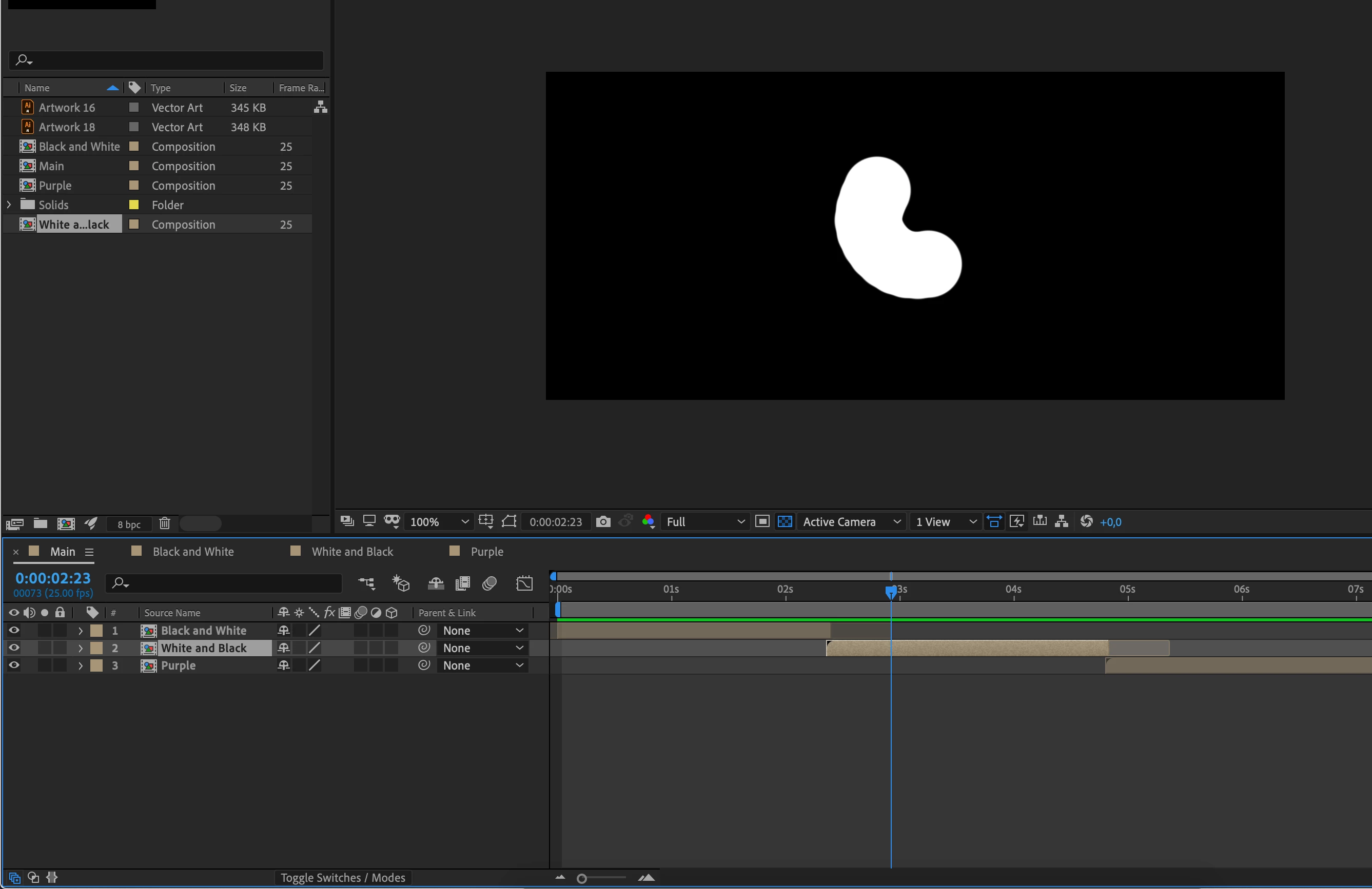

June 23, 2019

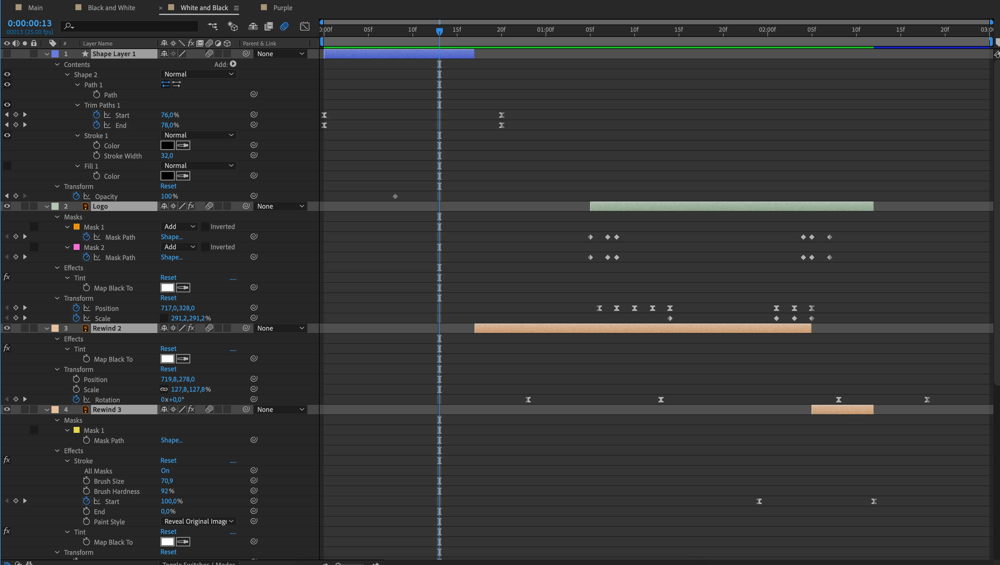

Hi OussK,
So another weird thing happened, the stroke looks off in the main comp, but within the comp itself is okay. See attached screenshots below. Both are at the same second, but appears differently. The effect settings is on the second screenshot and the layer itself is just a vector from AI. Thank you.
OussK
June 23, 2019
did you check if there is any stroke effect on the white and black composition in the main composition?
first screenshot
