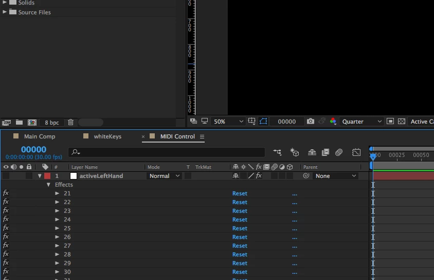

var midiControlComp = comp.layer("MIDI Control").source; // Set the 'MIDI Control' composition to a variable.
var leftHandController = midiControlComp.layer("activeLeftHand"); // Get the checkbox control layer for the left hand.
var rightHandController = midiControlComp.layer("activeRightHand"); // Get the checkbox control layer for the right hand.

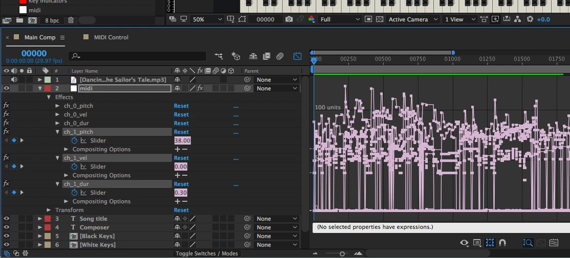

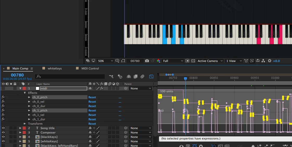

Still struggling with utilising all the data that's been provided in the midi layer.
Currently, the custom script is doing a great job, but I'm just not getting the key releases when the same key is being pressed again (such as the same chord being played 2 times in a row).
Here's the screenshot from the project:

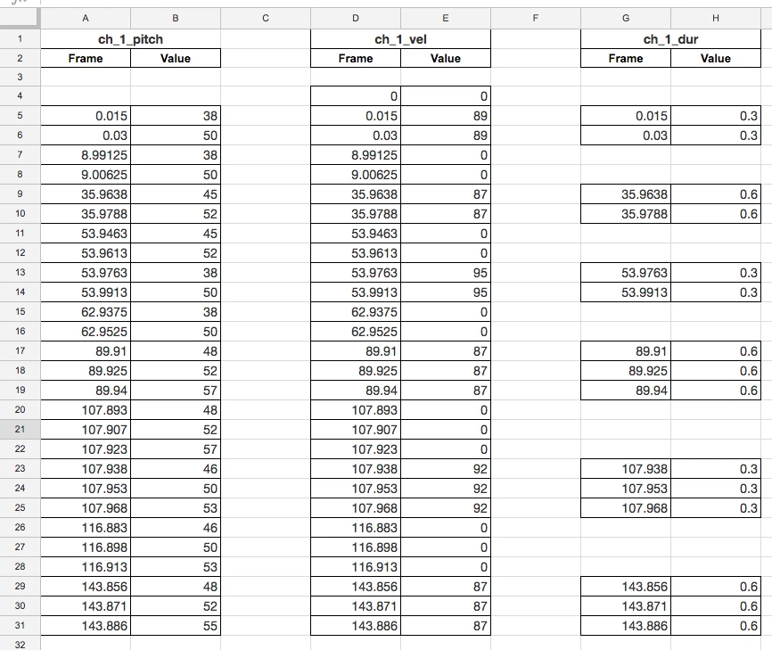

I've copied keyframe data for the highlighted sliders above, pasted it into a spreadsheet and aligned each data row with the corresponding frame to visualise the data better.
I can see that is has an 'on' state and 'off' state for each midi note, looking at the pitch and velocity values.
For example:
- Cell B5 is midi number 38. Since the velocity is not 0 (in this case it's 89), this is the on / pressed state.
- Cell B7 is midi number 38 again. This time it is showing velocity of 0. It would mean the note is in the off / released state.
I don't understand how the duration channel is working with the value given, but the values only appear where there is an 'on' state for a midi number.
I want to somehow make use of all this data and make the keyframes a bit more accurate.
Anyone able to help here?
Thanks.
