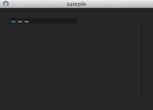

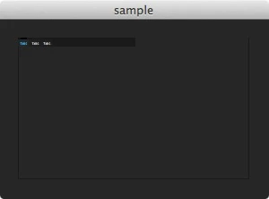

In AfterEffects CC(12.2) and CC2014(13.2), it comes out is a difference in the appearance of when I create a tab in the Panel object.
The test I have done in the Mac OSX 10.9.5.
TestScript
var winObj = new Window("palette","sample",[100,50,400,250]);
var tpObj = winObj.add("tabbedpanel",[20,20,280,180],"sample");
tpObj.add("tab",[0,0,0,0],"Tab1");
winObj.show();
result in AE 12.2
result in AE 13.2
Who AE13.2 display is now extremely small.
I'd like to the same result as AE12.2, What can I do?

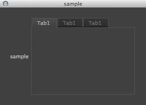

Correct answer Alex White
This works for me fine:
var winObj = new Window("dialog","sample",undefined);
winObj.preferredSize = [300,200];
var tpObj = winObj.add("tabbedpanel",undefined,"sample");
tpObj.preferredSize = [260,160];
tpObj.add("tab",undefined,"Tab1");
winObj.show();

May 22, 2015
Thank you reply, I also this post was already seen.
However, I will be changed to "dialog" did not result in resolution of the problem.
In my environment that's less than the script look like this result.
var winObj = new Window("dialog","sample",[100,50,400,250]);
winObj.show()
result in AE 13.2 "dialog""dialog"
Correct tab window is created in your environment?

Alex WhiteCorrect answer
May 22, 2015
winObj.show();
