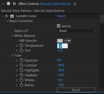

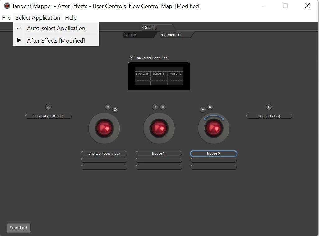

Hey Jonathan , so I work pretty strictly in AE as well and while there's no official After Effects port right now for this thing, I just managed to get it working using the Tangent Mapper App that comes with it.
Open up AE and make sure Tangent Mapper registers it as a new program.
Then head over to the Element-TK tab on the right and start mapping your knobs and buttons.
For me the most logical way to do this which I just tested and is super smooth is to map your A and B buttons as Shift-Tab and Tab, respectively.
Then I mapped my knob at the top (any one, i chose left, I'll explain why) to the Up and Down Arrows, and i said repeat Twice, just because it seems like a more comfortable adjustment up and down.
So when Lumetri's open in the effects panel just click in that first field for Temperature where you'd type in a value and you're off and running using the knob (or trackball, i found that clunky) and A B buttons.
I also then added an X mouse function to my middle knob, and a Y mouse function to my right knob so i can click and hold on my mouse a point for a curve, then dial it in in with X and Y movement on those knobs. Works pretty slick, might start trying this out here with Photoshop and whatnot too. I hope that's helpful, going to be my new workflow in AE for sure
