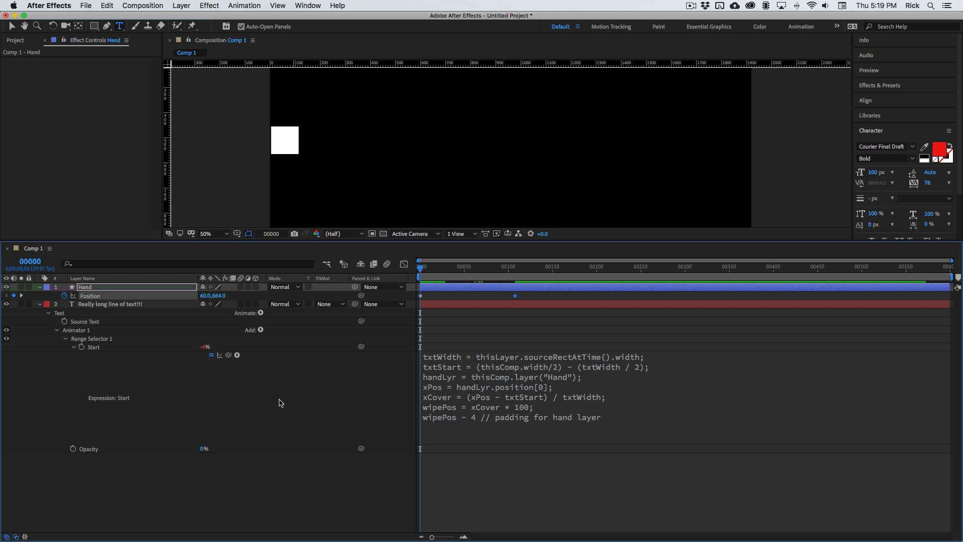

Feb 19, 2021 1:17 AM UTC
Turned out not to be that difficult.
Without taking into account the position of each layer all you need is this:
  • retrieve the txtWidth of the text layer using sourceRectAtTime()
  • Subtract half the txtWidth from half the comp width to get the starting position of the text layer
  • define the Hand layer and retrieve its position
  • get the xCover percentage of the position of the handLyr by subtracting the xPosition fron the txtStart value and dividing that by the txtWidth
  • multiply the xCover percentage by 100 to turn it into a usable value for Start
  • subtract the percentage of the hand layer's width from the wipePos and you're done.
txtWidth = thisLayer.sourceRectAtTime().width;
txtStart = (thisComp.width/2) - (txtWidth / 2);
handLyr = thisComp.layer("Hand");
xPos = handLyr.position[0];
xCover = (xPos - txtStart) / txtWidth;
wipePos = xCover * 100;
wipe = wipePos - 4 // padding for hand layer
if (wipe < 0){
	Start = 0;
else{
	Start = wipe;
 The comp looks like this:
All that is left is to add in some compensation for the position of the text layer and replace my placeholder rectangle with an image of a hand.
If you have multiple lines of text and you have created the proper path for your hand layer you can divide the sourceRectAtTime().height by the number of lines and work out the percentages so that the wipe follows the text reveal. It's just a little more fiddling.
Making the motion path of the hand layer follow the progression of the text animator would involve the same kind of thinking but a little more math. You would also have to retrieve the position of the text box. The general idea is the same. Maybe I'll try and figure that one out later.
