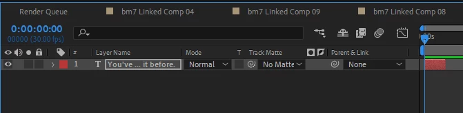

Yep, I realized that I could edit the text individually in AE.

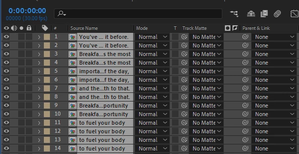

Facing another issue. All of the text layers are precomposed which means I have to manually open the layer and add in the stroke. Is there a workaround to this? Doing it manually would be very tedious
Dec 31, 2023 11:28 AM UTC
You may find this script to be useful:
https://aescripts.com/un-precompose/
