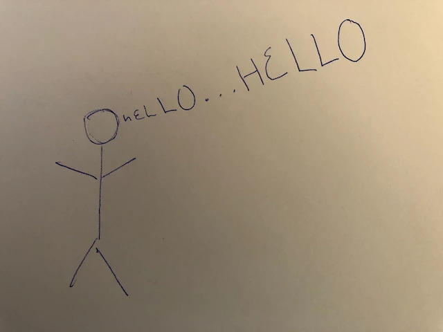

Hi: I'm trying to create an animated effect in which text comes out of a toon's mouth starting very small right by the mouth and growing as each letter gets farther away. Ideally, the tops and bottoms of the letter would be skewed in line the growing "triangle".
Relative newbie, and I have no idea how to make this happen. Any help would be appreciated.
