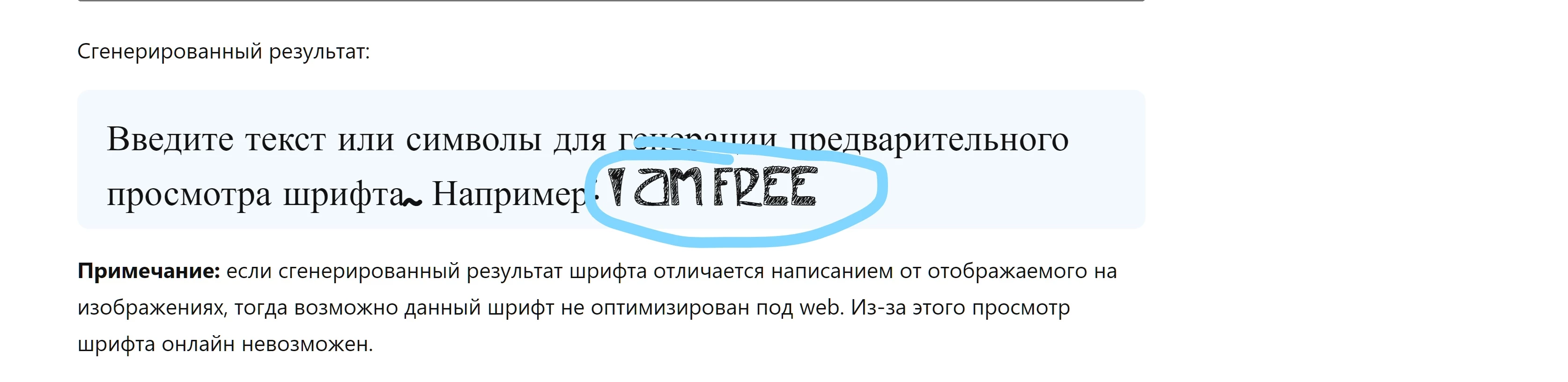

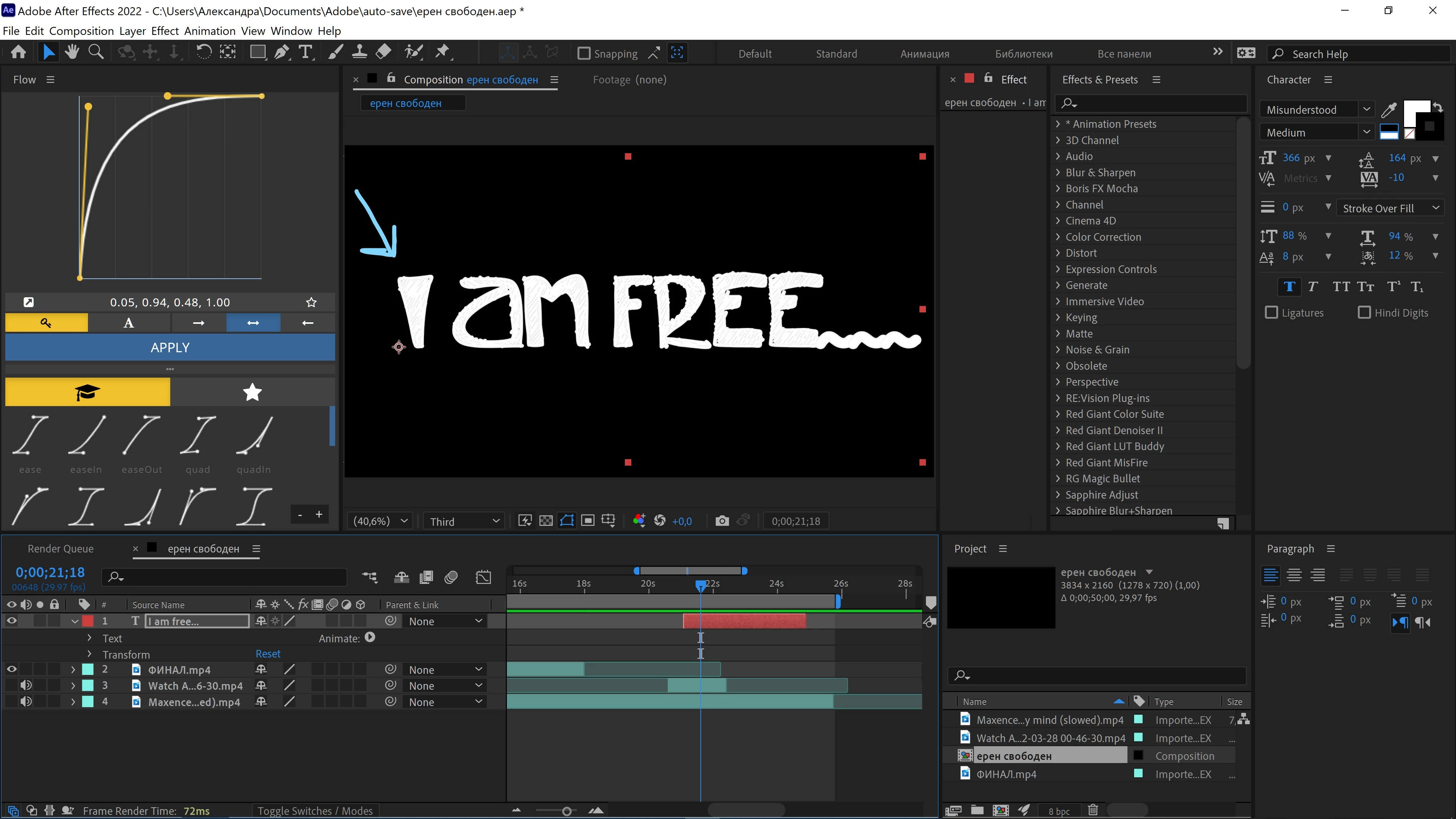

I downloaded a specific font that is shown in the first photo. you can see that it has a "texture",
but the problem is that when I apply it in a project, all that texture disappears.
what could be the problem?
Correct answer nishu_kush
Hi defaultxsfk7firmkld,
Thanks for writing in.
Try disabling the Faux Bold (bold "T" icon) at the bottom in the Character panel.
Let us know if it helps.
Nishu

cimomomiAuthor
April 1, 2022
Hi nishu_kush,
Your advice helped me solve the problem!
Thank you very much!
