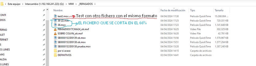

issue with the rendering of the files "SB00001523D0138.MOV" and "SB00001523D0139.MOV" in After Effects "PC 1"
  • We have tried pulling a Render "test2" using another file (with the same format as the Render that has the problem)
  • The "test2" (Different File) Rendered without problems (on PC 1)
  • The "test3" (SB00001523D0138.MOV in a New Precomposition) has the same problem (so it is not a Precomposition problem i guess)(in PC 1)
  • When launching the Render in other PCs , no problem occurs. (then the problem is not in the file i guess)

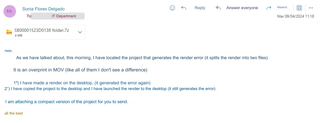

Hi @JohnColombo3491446
Thank you for your reply,
  i tried rendering in the local storage , and the same problem occurs
Here is a link to the project and the footage ...
https://mega.nz/file/YbsHDDTL#AuGGvPrUcJa2L7HaLWre3c7Q_ru0yUpFijHDwCxWEq8

Hi @Helius4k,
Thank you for reporting this issue. Would you be able to share the project file with us?
The screenshot appears to show you are rendering to a network device—does the problem occur if you render to local storage?
