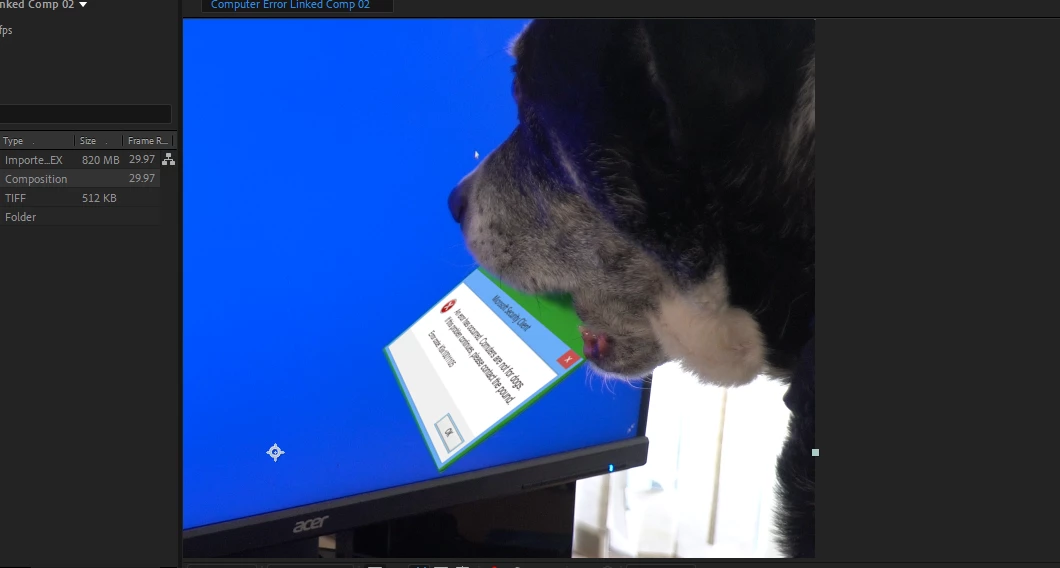

The tracker in After Effects seems to have a serious programming error causing it to be unless.
I track a item, then edit target, but when I hit "apply" the target rotates 90 degrees with out reason.  I have spent over 8 hours trying to make the tracker apply to a target with out destroying the target with out success.

Solved!
Talked to Adobe team but they had no clue.  After 14 hours and starting over 10 times, I finally figured it out through trial and error.
The solution:  AE is unable to attach horizontal TIFF or PS files to tracking.  Your file must be vertical, it's that simple.  The programmers at Adobe completely forgot to include the required orientation option into the tracking system.

With Tracking, I always set the target to be a Null Object, then parent any layers I want to that.
It is hard to tell from the screenshots if that would solve this particular problem though.  I think Rick is right and you should look at Mocha's included plugin.

If you are doing Corner Pin Tracking just rotate the replacement image 90º, Fit it to the composition, then pre-compose and corner pin the result.
I don't exactly know how you ran the tracker or why you did not try and use Mocha AE, which has much better corner pin tracking, but my guess is that you either did not arrange the four corners correctly or you failed to properly prepare the replacement image.
April 22, 2022
I tried Mocha and things ended up much worse.
