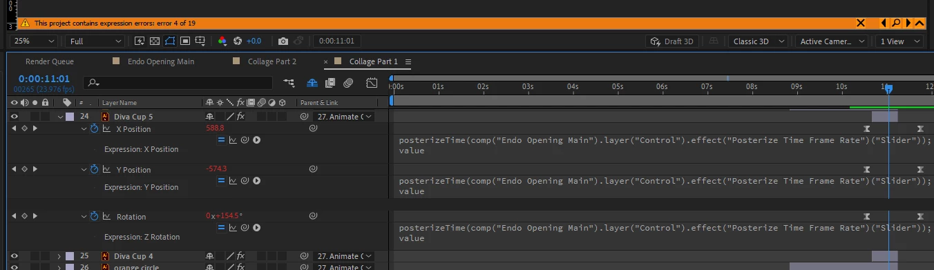

See photo: I made a change to my comp, and got the expression errors warning. But when I click on the magnifying glass for any of the 19 errors, the expressions that get revealed in the timeline panel seem fine. No yellow triangles with exclamation marks indicating an error, and the expressions seem to be working fine.
What's up with that?

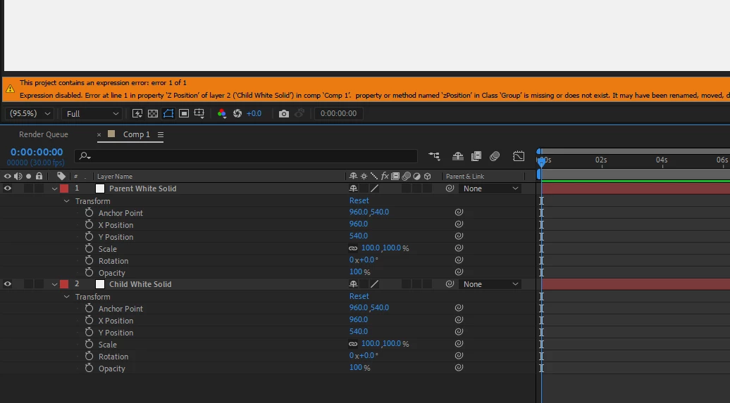

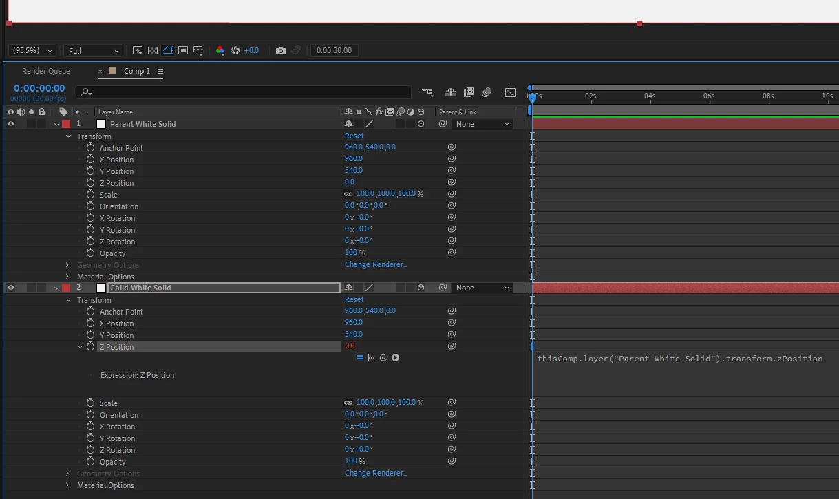

As a test, I created a fresh new project and a new comp. In the comp I added two solids. I made the solids 3D layers, and pickwhipped the Z position of one solid to the Z position of the other solid (see screenshot 1).
Then I turned off the 3D layer switch for both layers and am now getting an expression error warning (see screenshot 2).

Here is a screenshot showing that the error warning is saying there's an error on a property ('Z Position') that doesn't exist.
