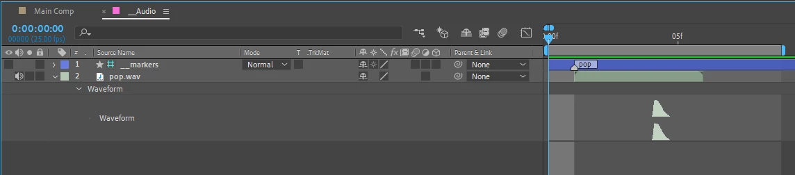

i made expression "trigger animation using markers" by Dan marker-sync which is so amazing and works well!
in this case i use it to trigger audio only. this is inside the audio precomp :
and below is what the issues about :
the "pop" marker triggers time remap perferctly but it creates kind of glitch.
because it is remaping backward (0:00:00:08 to 0:00:00:01) 
is there a way to avoid that? Any help and suggest would be appreciated!

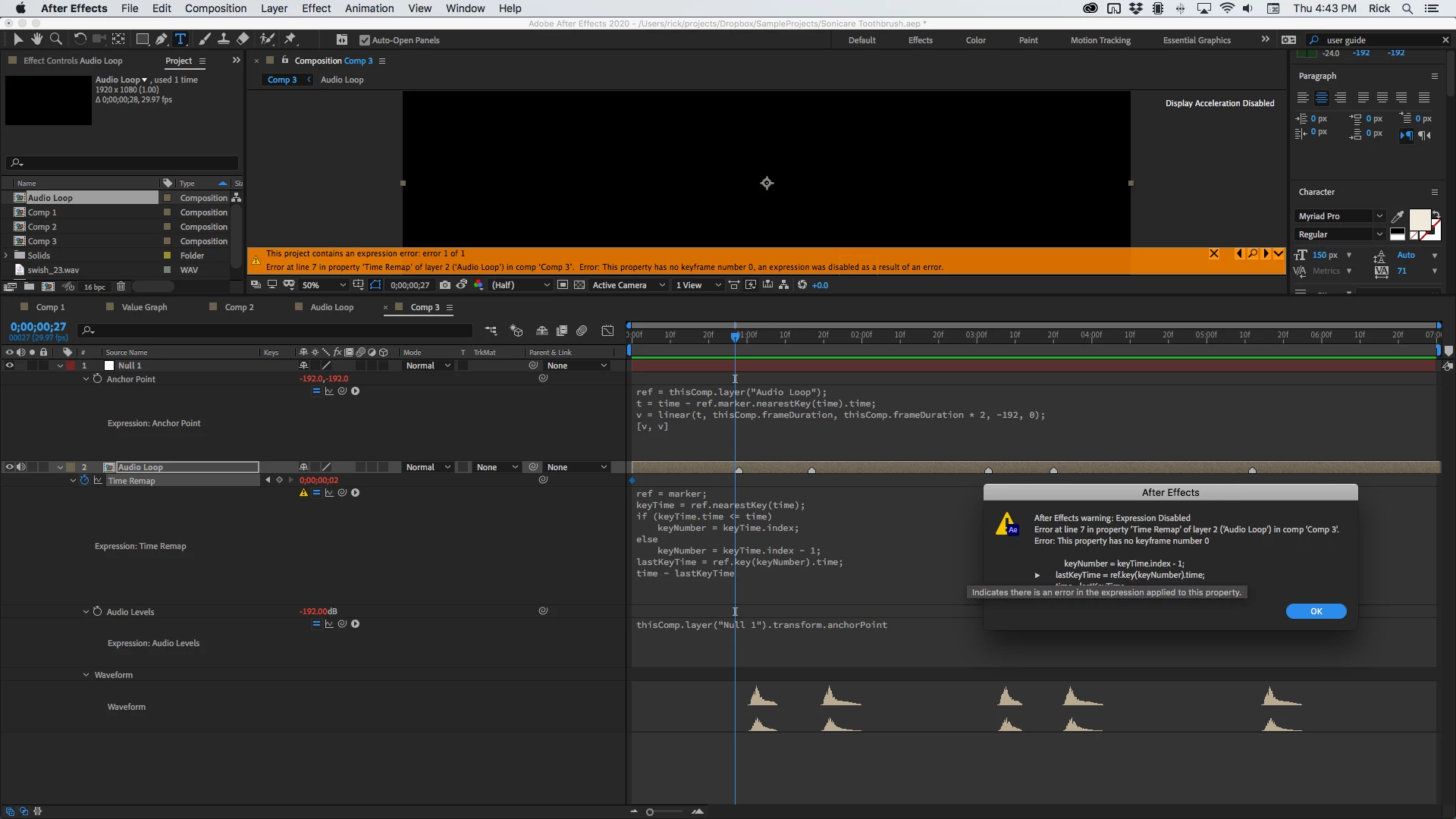

This is still throwing an error when the CTI is in front of the first marker. I have not figured out how to modify the expression so that it doesn't look for Keyframe 0. I am not sure how to handle the problem but the expression error is annoying, it doesn't break the project. Maybe Dan Ebberts has a solution. I can't seem to fix the problem.
This is what the Comp looks like:

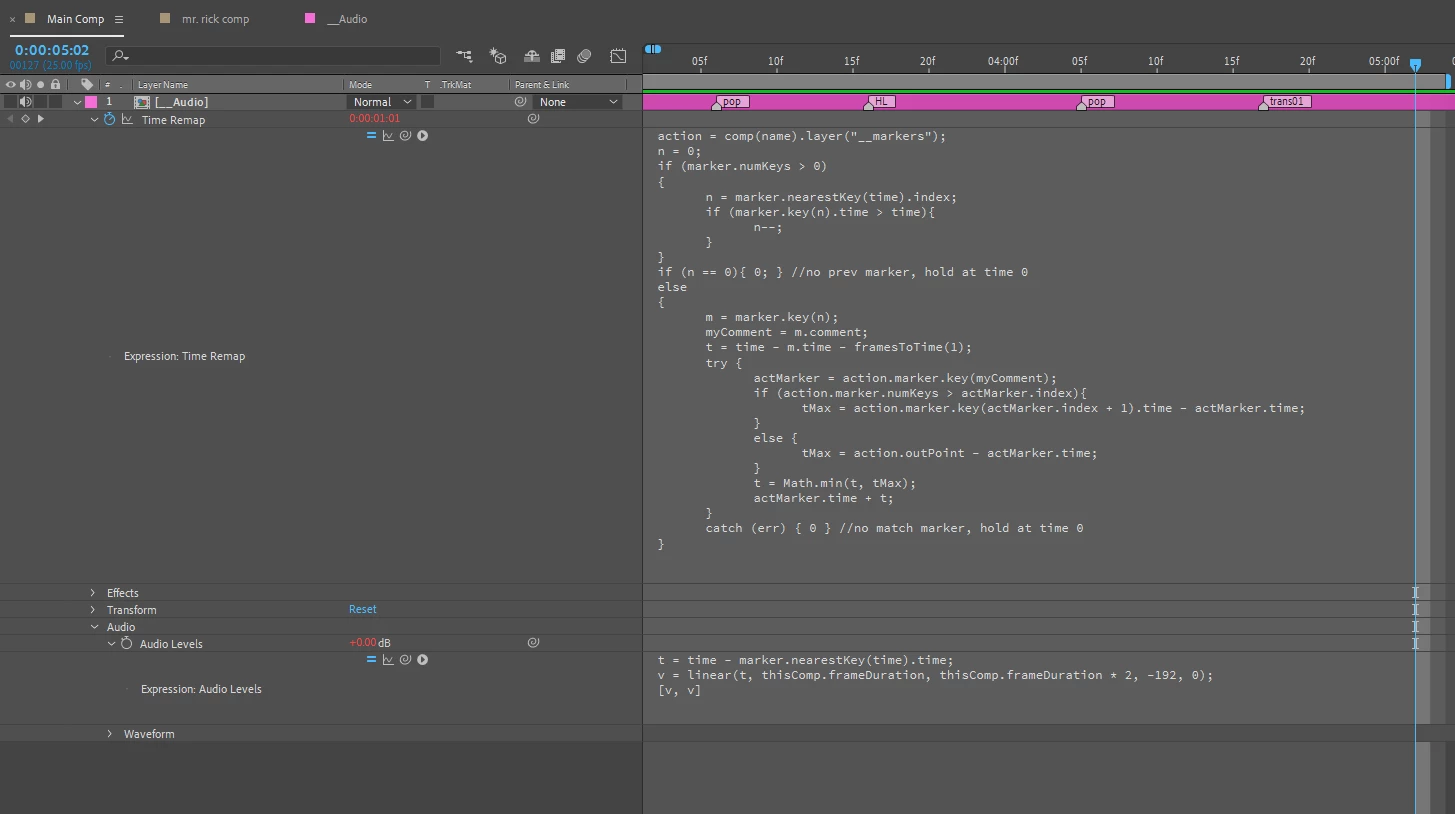

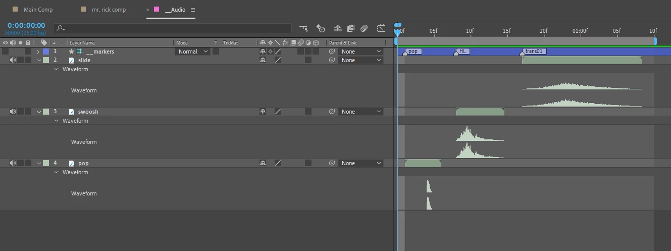

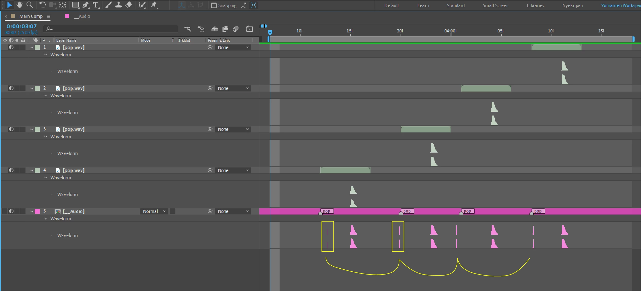

now i dont know how to edit ur expression to call another marker inside audio comp. so im back to use Dan's marker sync then add your audio lvl expression.
here's inside audio comp:
here's the Main comp: 

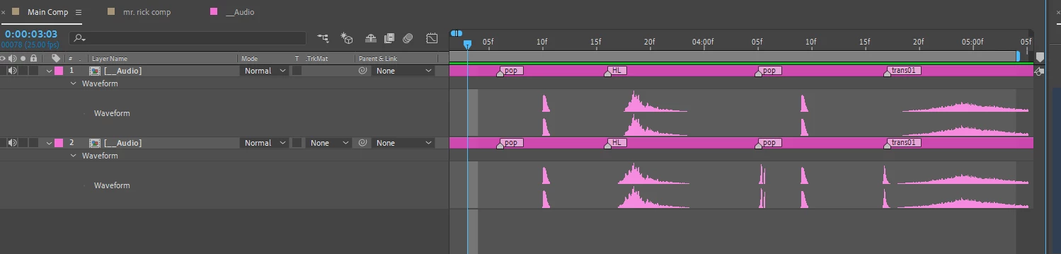

and here's the waveform comparison before (layer 2) and after (layer 1) the glicthes solved
as you see, it works like a charm!
then i found some limitations like i cant get the markers too close (at least 6-7 frames) so the current audio won't turned to -192 dB also i do offset the audio so it will play after marker.time + 1 frame
