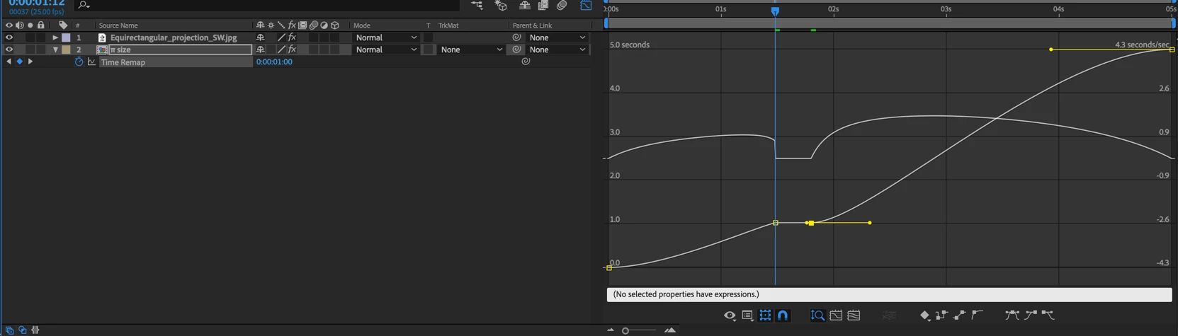

Time Remapping graph not looking right
I uploaded another project to mine and when I went to time remapping the graph editor and it looked like this.  The keyframes were eased, but it still looked this way.

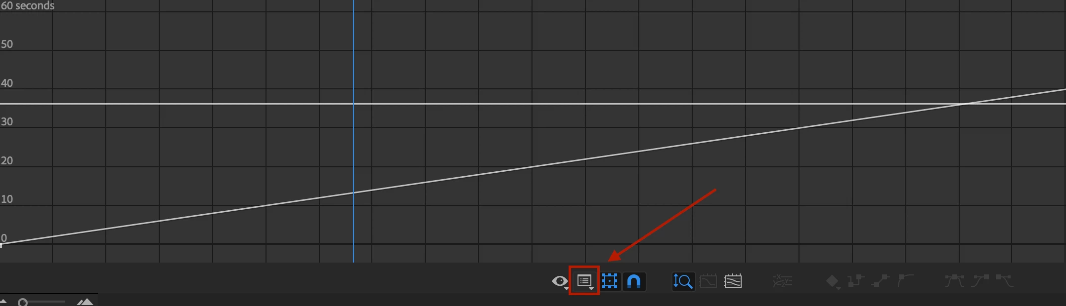

    imaan5FDDCorrect answer
    Jun 27, 2021 7:19 AM UTC
    bro all u have to do is diable "Show Graph Editor Set" everyone is making it so complicated

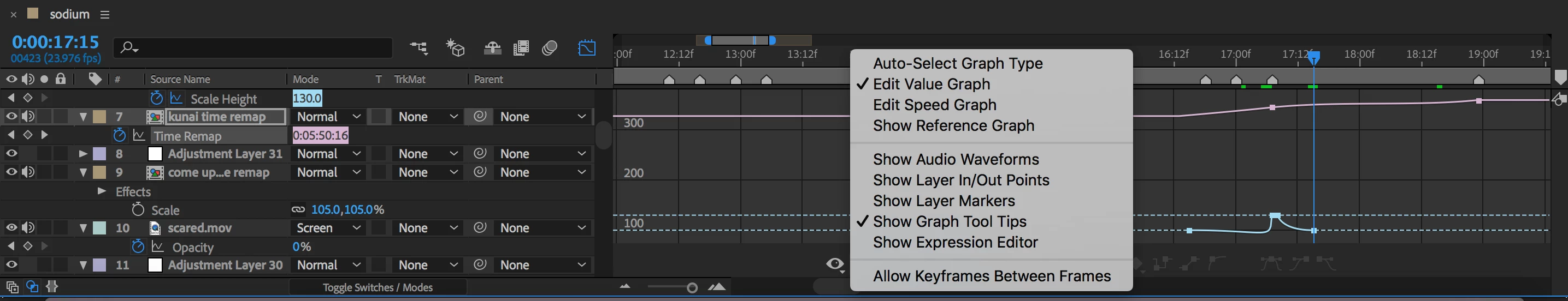

    Feb 4, 2019 7:21 AM UTC
    You are looking at a speed graph. Look at a value graph and you will see what you expect. Remember, that is 'time' that you are looking at, not speed. The speed graph is going to show you how fast time changes. Here's what it looks like with show reference graph and edit value graph selected. The clip speeds up, then freezes for a few frames, then continues and slows to a stop at the end.
    I believe you also have shown all keyframes selected.
    shixg33323884
    Feb 4, 2019 5:22 PM UTC
    It's on value graph, that's why I'm so confused
    OussK
    Feb 4, 2019 5:34 PM UTC
    You already select 2 parameter (scale hight and time remap) so try to select only time remap and check if you can see the graph as should be
    OussK
    Feb 4, 2019 6:35 AM UTC
    it's normal, the dashed point mean that this part of time is set to the beginning or ending. so their are nothing to play is this time because you simply move the first and the last time remapping keyframe to the middle of your composition, the second dashed line i think it's the reference line or so.., you can click on (chose graph type and option) and remove the unwanted guid and line.
