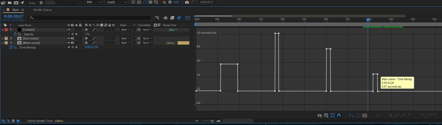

I went to check the graph editor and, wouldn't you know, the line between my "out of speedramp" keyframe and my end of clip keyframe both were set to 0.98 sec/sec or even slower. If I try and select or even direct select a specific keyframe on the graph editor and move it, Ae tries to add extra curves around the set of linear keyframes and it turns my graph into a terrifying Calc 3 expression.
I believe I understand that the interpolation between keyframes means that Ae will try to smooth the motion out between points and returning to 1 sec/sec is just trying to smooth out that transition, but even when I return both points to 1 sec/sec and smooth out their bezier handles as much as possible, there's a small (albeit imperceptible) dip between the two, Ae turns the keyframes into half-ease frames, and the issue worsens as I try to add more speedups (there are about 25 in the 8 minute segment).

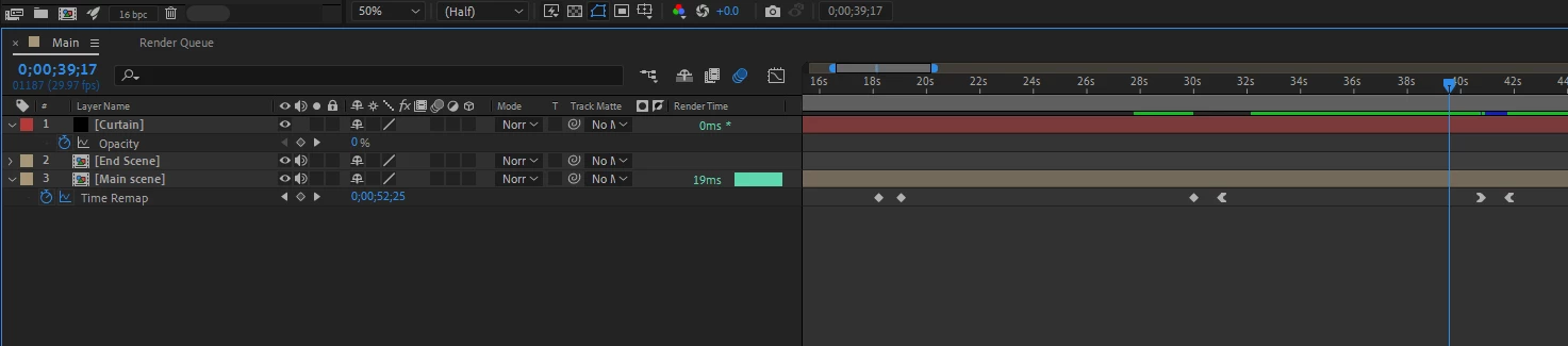

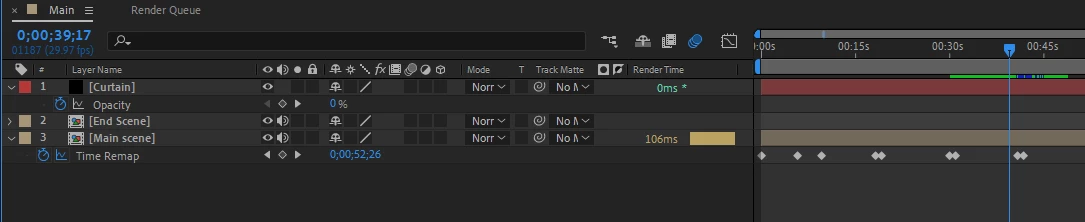

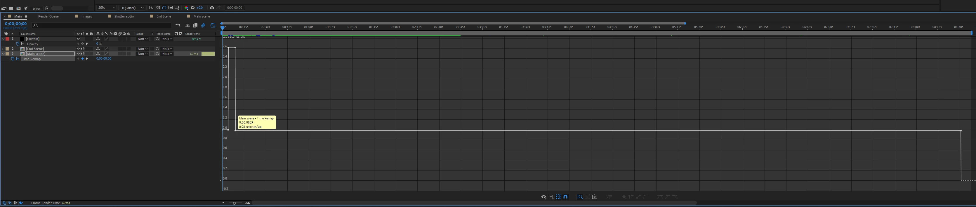

Sorry for the miscommunication. All of my keyframes start linear while I try to add the time remapping. Once I go in the graph editor to try and bring the keyframes back to 1 sec/sec, it Beziers the keyframes. If I change the keyframe back to linear, Ae shifts the keyframe back down to below 1 sec/sec. Some screenshots are attached to try and help me explain.
I also didn't know it was a bad workflow, that's why I'm here 🙂 to me it seemed better to have one clip with keyframes rather than 50 layers since I am speeding up 25 times. I know I can still precomp after and clean up the master comp, I was just looking to keep it from getting too messy. Thanks for your help.
