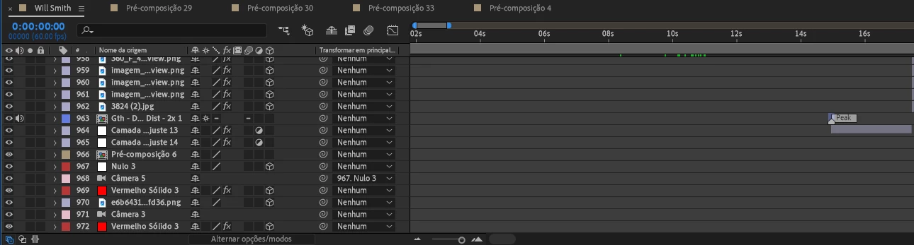

timeline disappeared
A part of my timeline disappeared, I think I pressed a button by accident, and it disappeared, does anyone know how to fix it?

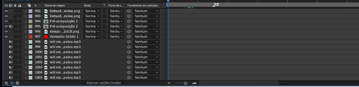

May 1, 2024 7:16 PM UTC
Simplemente está muy grande a lo ancho la línea de tiempo, debes reducirla de tamaño o desplazarte hacia la izquierda para poder ver tus Layers.
Byron.
thepixelsmith
May 1, 2024 6:46 PM UTC
I don't know if this is it but you are zoom in on the time line a lot.
The scroll bar on the bottom of the time line, the one with the large and small triangles. Drag the slider towards the small triangle.

May 1, 2024 3:59 PM UTC
Was it F4? That would swap the layer switches (shy, fx, motion blur, etc) and the blending modes. You can also bring them back by using the small buttons in the lower-left corner of the Timeline.
Cheers,
- John, After Effects Engineering Team
May 1, 2024 4:37 PM UTC
I believe it wasn't f4, the problem is that the files don't appear in the timeline (so you can't cut them for example) but this is only in some files at the beginning of the video, the rest is normal
JohnColombo17100380
May 1, 2024 4:45 PM UTC
Ah, is it possible you've trimmed or moved those layers in the Timeline before the beginning of the composition? Try selecting the layers on the left, move the CTI to the first frame of the composition, then use the open bracket key [ to set their inPoints to the start of the composition.
