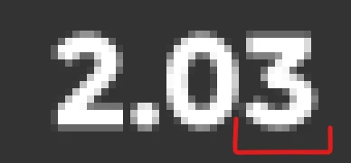

Okay, here's my expression. It makes the timer start counting at every "switch" Checkbox ODD keyframe and stop at every EVEN keyframe.
s = effect("switch")("Checkbox");
n = s.nearestKey(time).index;
if (s.key(n).time > time) n--;
t = 0;
if (n%2 == 1) t += time - s.key(n).time;
for (i = 2; i <= n; i++){
	if (i%2 != 1) t+= s.key(i).time - s.key(i-1).time;
t

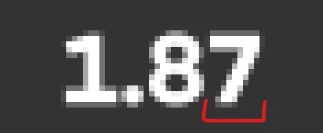

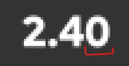

The 2nd decimal of the timer/stopwatch only shows 0, 3 and 7 (instead of showing all numbers: 0,1,2,3,4,5,6,7,8,9):
I think the expression doesn't have any rounding functions. But i'm pretty sure it has something to do with the frame rate.
November 12, 2022
You are calculating time, and keyframes always start at the start of a frame. 1 second / 30 = .3333 so the time is going to be rounded to the nearest 30% which is .00, .03, .07. for 30 fps.
