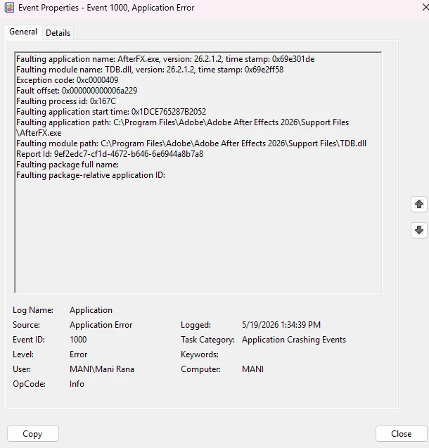

    Mani Rana
    Mani RanaAuthor
    May 19, 2026 8:20 PM UTC
    You can send this to Adobe support or post it on forums:
    I have tested After Effects versions 2024, 2025, and 2026, and all of them keep crashing during normal use. Even when I am doing simple work, After Effects suddenly crashes after around 1 minute or more. The application closes by itself and shows different error messages almost every time.
    I also tested After Effects without any plugins installed, including without Element 3D, but the crashes still happen. I already contacted Adobe technicians, but they were not able to help me solve the problem.
    My PC specifications are:
    • CPU: Intel Core i9-14900KS
    • GPU: NVIDIA GeForce RTX 4070 Ti
    • RAM: 64GB
    • OS: Windows 11 Pro Version 25H2 (OS Build 26200.8457)
    I do not understand why this keeps happening even after paying for Adobe software. A lot of my work is currently pending because After Effects is too unstable to use properly.
    Please help me find a permanent solution.
    here crash report
    Log Name:      Application
    Source:        Application Error
    Date:          5/19/2026 1:34:39 PM
    Event ID:      1000
    Task Category: Application Crashing Events
    Level:         Error
    Keywords:
    User:          MANI\Mani Rana
    Computer:      MANI
    Description:
    Faulting application name: AfterFX.exe, version: 26.2.1.2, time stamp: 0x69e301de
    Faulting module name: TDB.dll, version: 26.2.1.2, time stamp: 0x69e2ff58
    Exception code: 0xc0000409
    Fault offset: 0x000000000006a229
    Faulting process id: 0x167C
    Faulting application start time: 0x1DCE765287B2052
    Faulting application path: C:\Program Files\Adobe\Adobe After Effects 2026\Support Files\AfterFX.exe
    Faulting module path: C:\Program Files\Adobe\Adobe After Effects 2026\Support Files\TDB.dll
    Report Id: 9ef2edc7-cf1d-4672-b646-6e6944a8b7a8
    Faulting package full name:
    Faulting package-relative application ID:

    Nishu Kushwaha
    May 20, 2026 5:01 PM UTC
    Thanks for getting back and sharing the details. This is not the crash report we’re looking for.
    Do you get a crash reporter right after the crash? If yes, please provide your email id to it and submit the report. Let me know once done. If there’s no crash report, here’s how you can collect the crash log and share:
    1. Start AE
    2. Help Menu > Enable Logging
    3. Restart AE
    4. Work until AE crashes
    5. Relaunch Ae and go to Help Menu > Reveal Logging Files...
    6. Find the "After Effects Log.txt" file and copy/paste the content back to this forum thread.
