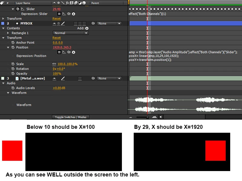

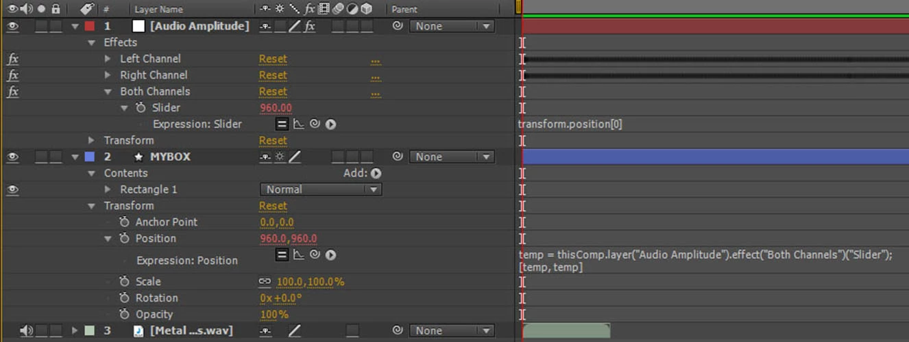

I still trying to figure out how to make a shape of whatever move horizontally ONLY to the beat of music.
I had been using a linear formula like this: linear(value,45,65,0,100) for other things, and understand a little bit.
Reading a book I try something different ( Look at the photo ) but my box ( shape ) when down and stayed there LOL.
How can I make for example using vlaues from the Graph Editor, for example 45,65 as above, to move the shape horizontally?
I know I getting close, but may go crazy without the help of you folks here........

Progress:  Now we getting somewhere.
Look at the photo, everything seen to works ok.
Look at the formula: (amp,10,29,100,1920)
I tough the box will move from X=100 to X=1920
However look at the bottom of the photo, at min peak the box is completely to the left
while at full peek does not reach right border.

G-PersonAuthor
February 23, 2017
Thanks, do NOT get mad with me, I trying to understand, but some people post one way or another and in mean time I go nuts!!
Someone told me something like that, but did not give me much info.
For example, your lines:
amp = thisComp.layer("Audio Amplitude").effect("Left Channel")("Slider");
posX= linear(amp,0,50,0,1920);   posY = transform.position[1];    [posX,posY]
1:Do this lines replace the text on "Expresion Position" on the pic above?
2: I get confuse with this 2 lines... ( Remember I learning from you )
To me you moving X position for 50 1920, however in the bottom then you said transform.position[1];
which will be "Vertical Coordinates" Right?
3: create a variable to store the Amplitude.
amp is the variable created for the audio Amplitude.
Sorry for so many question and I don't mean others are good or no good
but I can understand what you trying to tell me, better than others.

February 23, 2017
The Position is related to the Anchor Point of the layer.
You can either  offset your anchor point or changed the value you entered (100,1920) to something that fits your need better.
I would changed the anchor point position.
