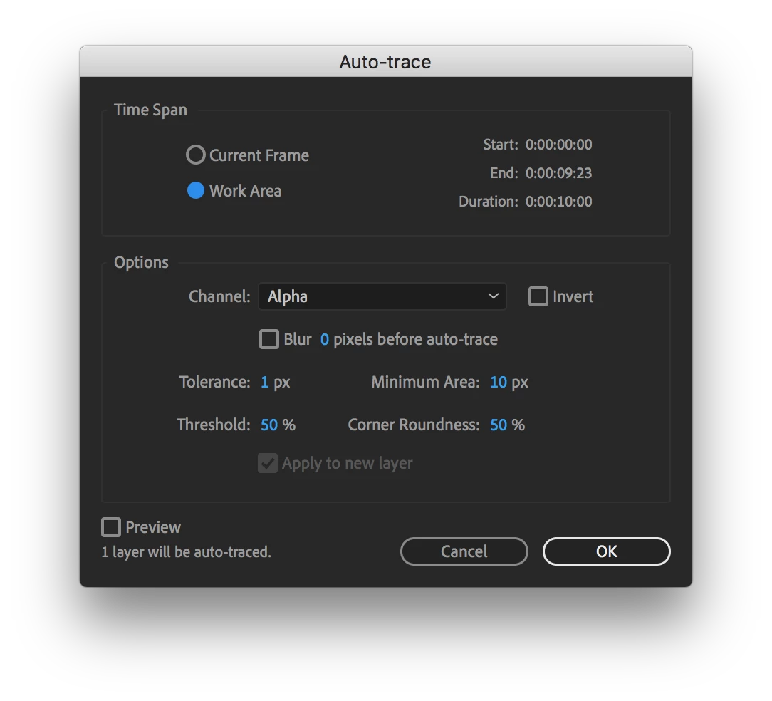

There's something i need to make and I can't work out how to do it.
I have a footage of some paint dripping. I was able to delete the background so its footage on transparent.
I need to create a mask path around the silhouette. So basically autotrace, but not just one frame- for a 4 second footage.
Does this exist?
I tried tracking the mask and it hasn't worked well and also tried rotobrush and that doesnt work either.
Any other solutions would be highly appreciated!
Warren Heaton
July 30, 2020
Yes, you can auto-trace more than one frame by setting Auto-trace to use the Work Area (Layer > Auto-trace...).  In this case, set the Work Area to the 4-second range of footage that you want to trace.
