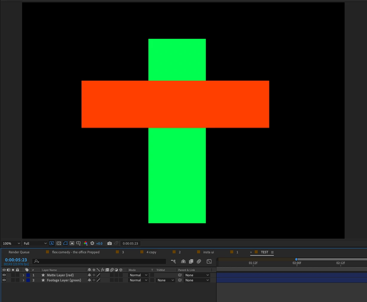

Parrotface
March 25, 2021
Sorry, ignore what I said about "formerly stencil alpha"). But yes, it's TrkMats, not blend modes. Here's a couple screenshots using shapes:
In the first one, Layer 1 is the matte layer, in red. Layer 2 is the footage layer, in green.

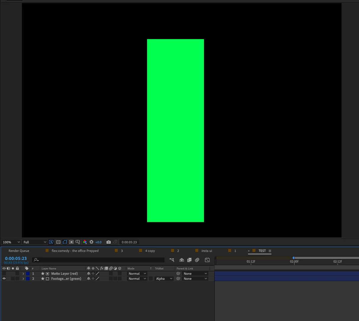

In the second one, I've set the TrkMat of Layer 2 to Alpha Matte, which turns off Layer 1 of course. But Layer 2 is still visible in its entirety. We should just be seeing it where it intersects Layer 1.
Both layers are at 100% opacity and show as solid white alphas against black in the Show Channel button.
