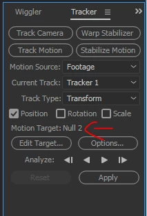

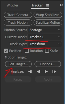

Roei Tzoref
May 6, 2017
make sure you are setup this way:
then you would see it set:
now you hit Apply.
you might want to read this through: Tracking and stabilization motion workflows in After Effects
