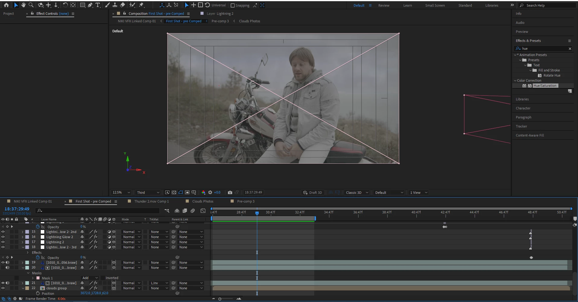

Hello community,
I'm currently working on a music video of mine where I'm co-editor and also decided to do some VFX where appropriate. I have shots in the open where the wheater was kind of dark and cloudy (as you'll see from the screen recording I'm uploading), so I thought I would add some more clouds and create some lightning here and there. I looked for a way to isolate the sky by  duplicating original footage, working with the tint/levels effects to make the sky very bright, use luma matte, and substitute it with other assets.
I saw in tutorials that 'd have to camera-track the original shot, then create a null and a camera. Then, all I need to do is make the sky-replacement asset layer a 3D one, and it would move accordingly with the camera. However, in tutorials people use video assets for replacement, whilst I'm using dark cloud photos with a bit reduced opacity so they would kind of blend with the original video clouds. So when the camera is moving for example to the left, the original sky of the shot looks like it's going to the right, and the photo assets look like they're moving to the left (compying with the actual tracked camera movement), which creates a discrepancy between the two. So my question is - is there a way to make it look correct, using the static cloud photos I've already placed, or should I replace them with some sort of dark clouds footage?

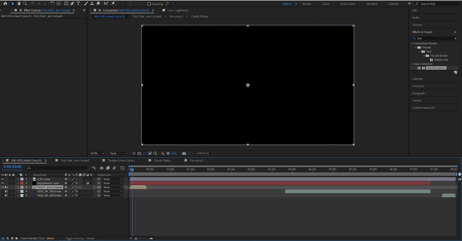

My 2nd question is -When I turn on the 3D tracker camera layer, the whole precomposed comp I'm working on makes the main comp have a blank preview as you can see from one of the screenshots. Why would that happen?

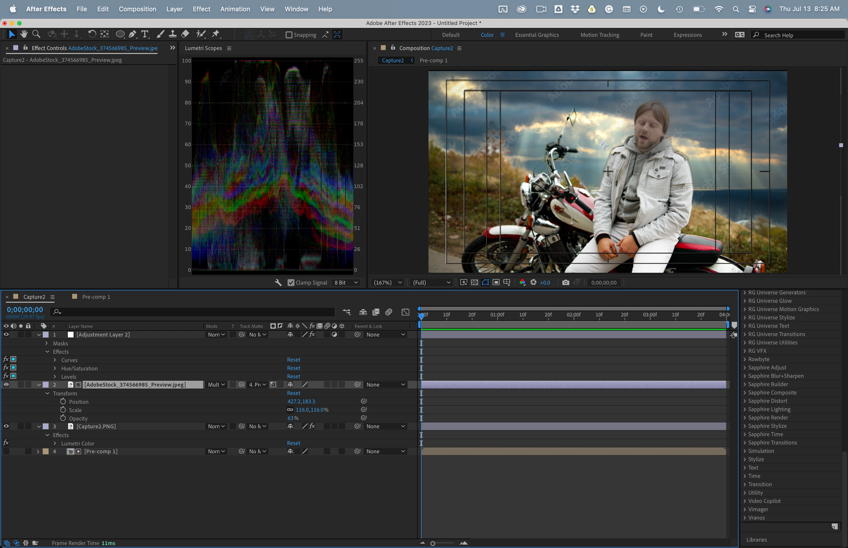

I downloaded one of your low-resolution screenshots and this Adobe Stock image to create a quick procedural matte and color correction workflow.
If I had the footage, the first thing I would do would be to motion stabilize the footage using Mocha AE so that the motorcycle does not move in the frame. I did not show that in the sample comp that you can download.

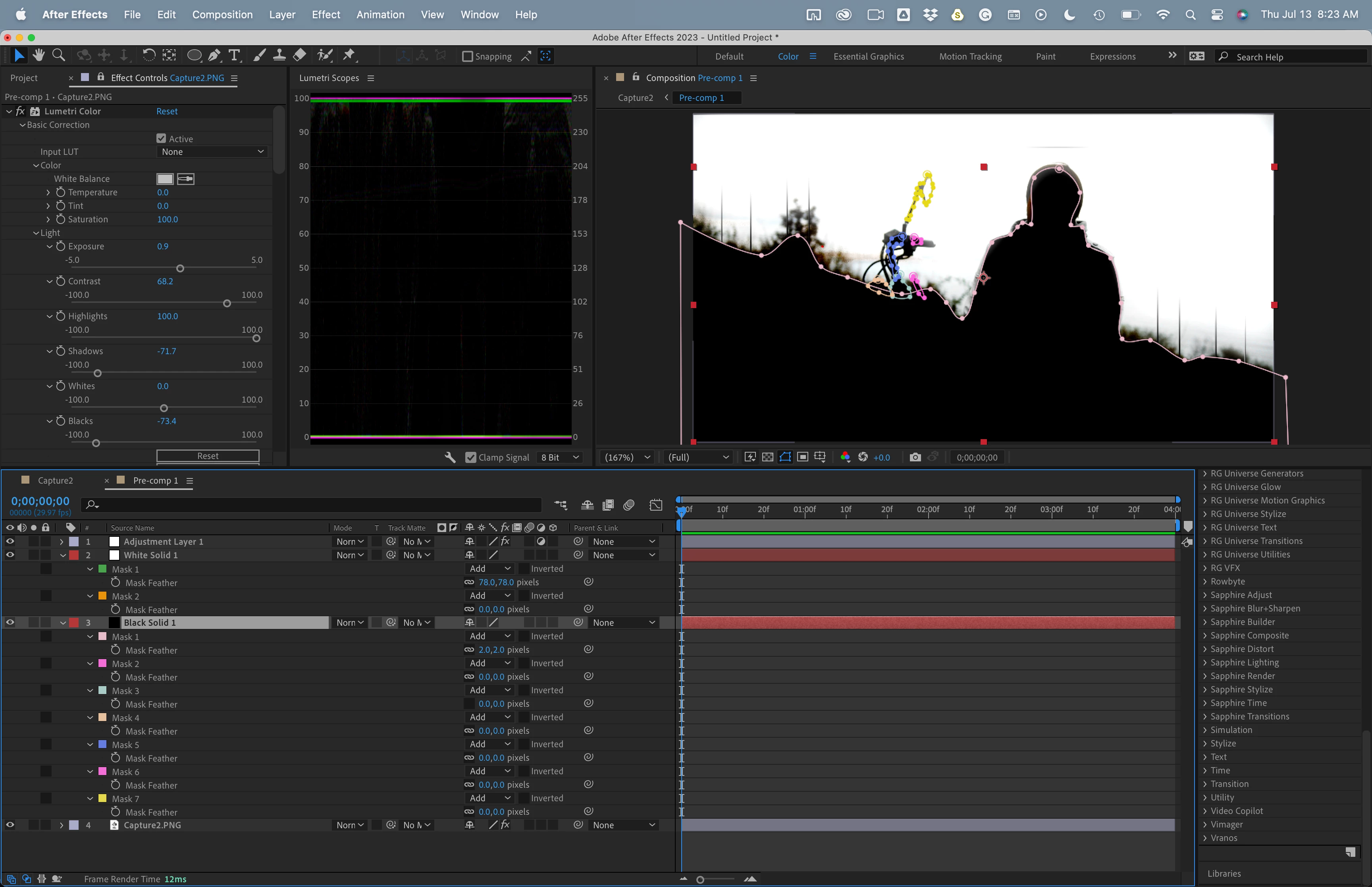

After Adding the footage to a comp, the first thing I did was apply some color correction to increase the contrast and give me some edges to work with. Then a Black solid was added, and the hand Rotoscope was completed to black out the foreground and the reflections on the motorcycle. Then I did the same thing with a white layer to clean up the sky and poke a hole in the mirror. I would have used Mocha AE to do the Roto if I had a movie instead of a still to work with. Rotobrush would be useless on this shot.
Now that I have a matte created, I drop the original footage and the replacement sky in the comp, pre-compose the layers sit took to make the Matte, and use the Pre-comp as a Luma Track Matte for the replacement sky. A bunch more fiddling with opacity, a master adjustment layer, some more masks, and I ended up with something like this.
To really sell the shot you'll need some more work on the Luma Matte, with some more layers. You will also need to have a separate roto of just the mirror and another copy of the sky that is flipped and motion tracked to put some realistic storm sky reflections in the mirror.
If your shot is 7 or 8 seconds long, and you get fairly comfortable with the workflow i would guess that it may take up to a half a day to perfect the shot because of the cmaera movement and the required Roto work.
If you download the project and fiddle with the controls it may give you a start on the techniques you will need to add some elements to the sky. The most time consuming part of the project will be the Rotoscoping, but Motion Stabilizing the Motorcycle will and Mocha AE will make that workflow a lot easier.

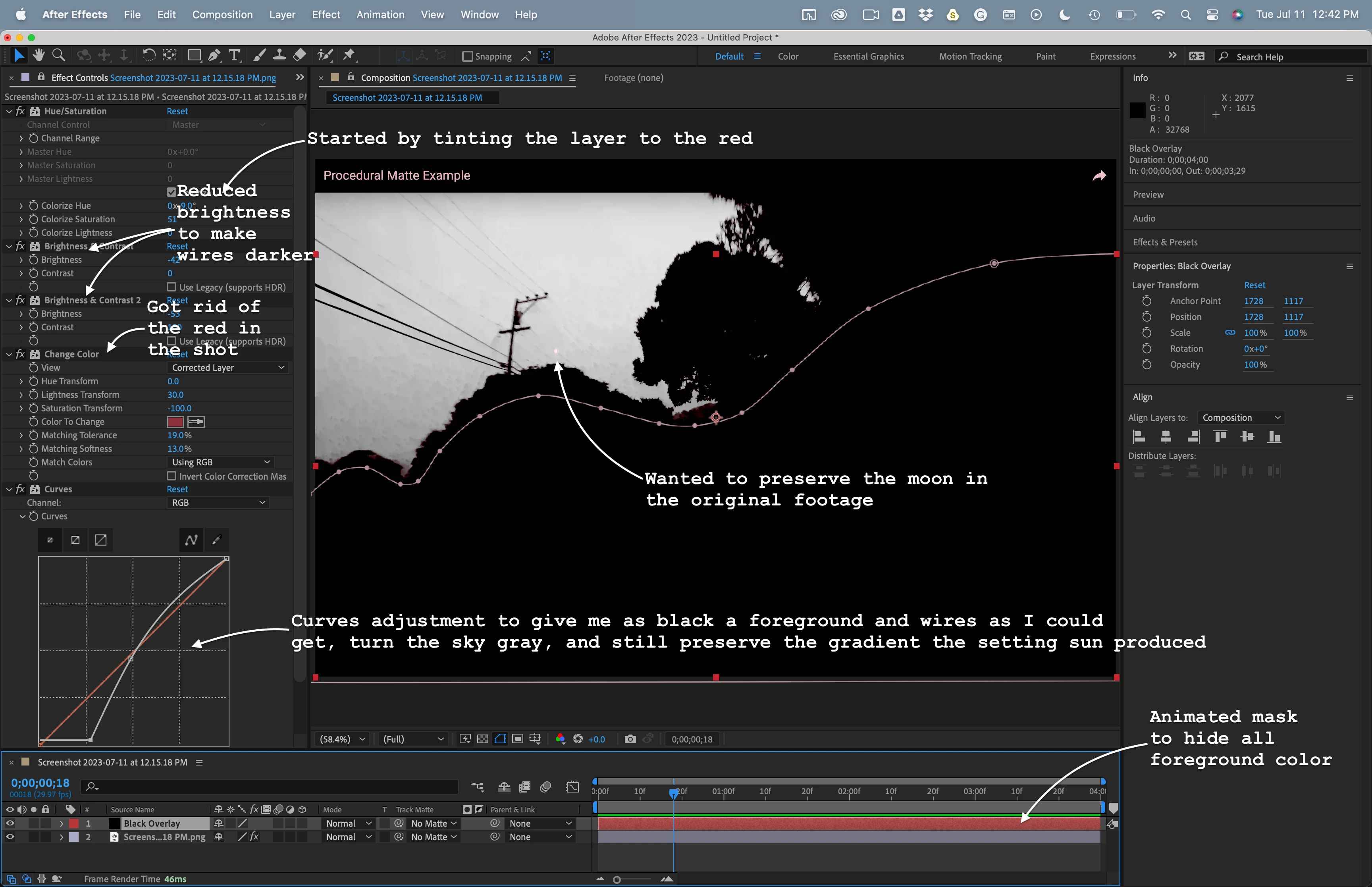

The original sky looks pretty blue, but I did not use any keying. A copy was color corrected to give me a solid white sky and a black foreground, A Solid Black layer with a mask covered all of the brighter details in the road. Then that layer and two copies of the original color corrected original shot were pre-composed and used as a procedural matte for the replacement sky. The Track Matte layer looked something like this:
Because the camera was moving, I also had to motion track the shot using Mocha AE and then add that motion to the replacement sky shot. By the time I was done, I had preserved the haze, most of the powerlines, and the moon and added a much more interesting sunset. The entire shot was then color-corrected using Lumetri on an adjustment layer at the top.
I keep trying to find the time to do a concise procedural matte tutorial. I'm asked to do a lot of this kind of work, and no one recipe works with all shots. I've been able to create the masks with nothing more than Curves and Levels, but on other shots, I have needed a stack of four or five layers with a half dozen color correction effects on each and some Rotoscoping to get a believable matte.
