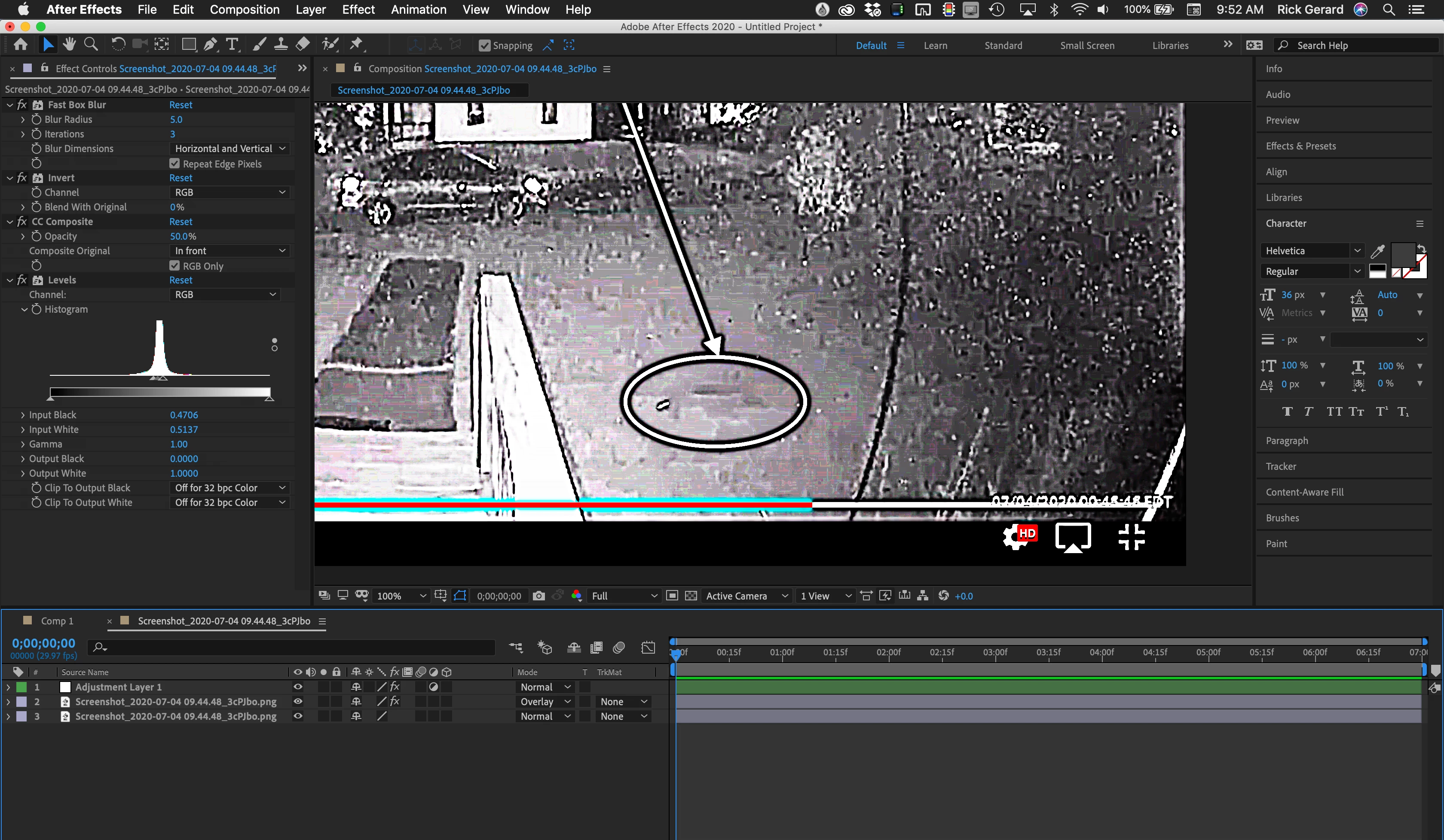

I hate to say this but have you watched any tutorials on Camera Tracking. I don't see you opening up the Advanced secetion, checking the accuracy or trying any other options. There are no track points on the car so you'll have to do something to the shot before you run Camera Tracking. Here's the workflow that I would follow with that shot.
  • Duplicate the footage layer and rename the duplicate something like "track this"
  • Add color correction and or other effects to try and bring out as much detail as you can in the shot, I would have to play with the footage a bit but I do this all the time on difficult to track shots
  • Pre-compose the 'track this' layer and move all attributes to the new comp
  • Run a Camera Track on the pre-composed 'track this' layer
  • Explor all the options and verify that you have an accurate camera track before the next step
  • Pick a spot to set an origin and ground plane, set a layer marker, then pick at least 3 points that make the target look like it is attached to the ground
  • Set the orign and grouind plane then immediately add a Camera and a Track Solid
  • Make sure that the first track solid sticks to the ground. I usually add the Grid effect to the layer then set it to a Guide layer
  • When the track is good add additional track solids to the surfaces you want to add things to. I never use nulls because it's almost impossible to see if they are properly sticking to the surfaces
  • Set all tracking solids to guide layers then start adding your additional layers
  • When you add artwork or a text or shape layer, make the layer 3D then hold down the Shift key and Parent the new layer to the appropriate guide layer
  • The marker lets you return to the place where the camera is at it's starting position and the origin track solid is at 0, 0, 0 so you have a frame of reference for other 3D layers
When you are ready to render none of the guide layers will render. You can turn them off if yu want, but it is a really good idea to keep them in the comp if you need to come back later and make changes. You can also add a 3D null to 0, 0, 0, parent all of the other 3D layers to the null, then move the null to comp; center. Any new 3D layer you add will now be at comp center so it's a lot easier to get things lined up.
I hope this helps. This is an image from a post a long time ago. I've seriously cranked on the image to bring out some detail that can be tracked. Maybe it will give you some ideas.
