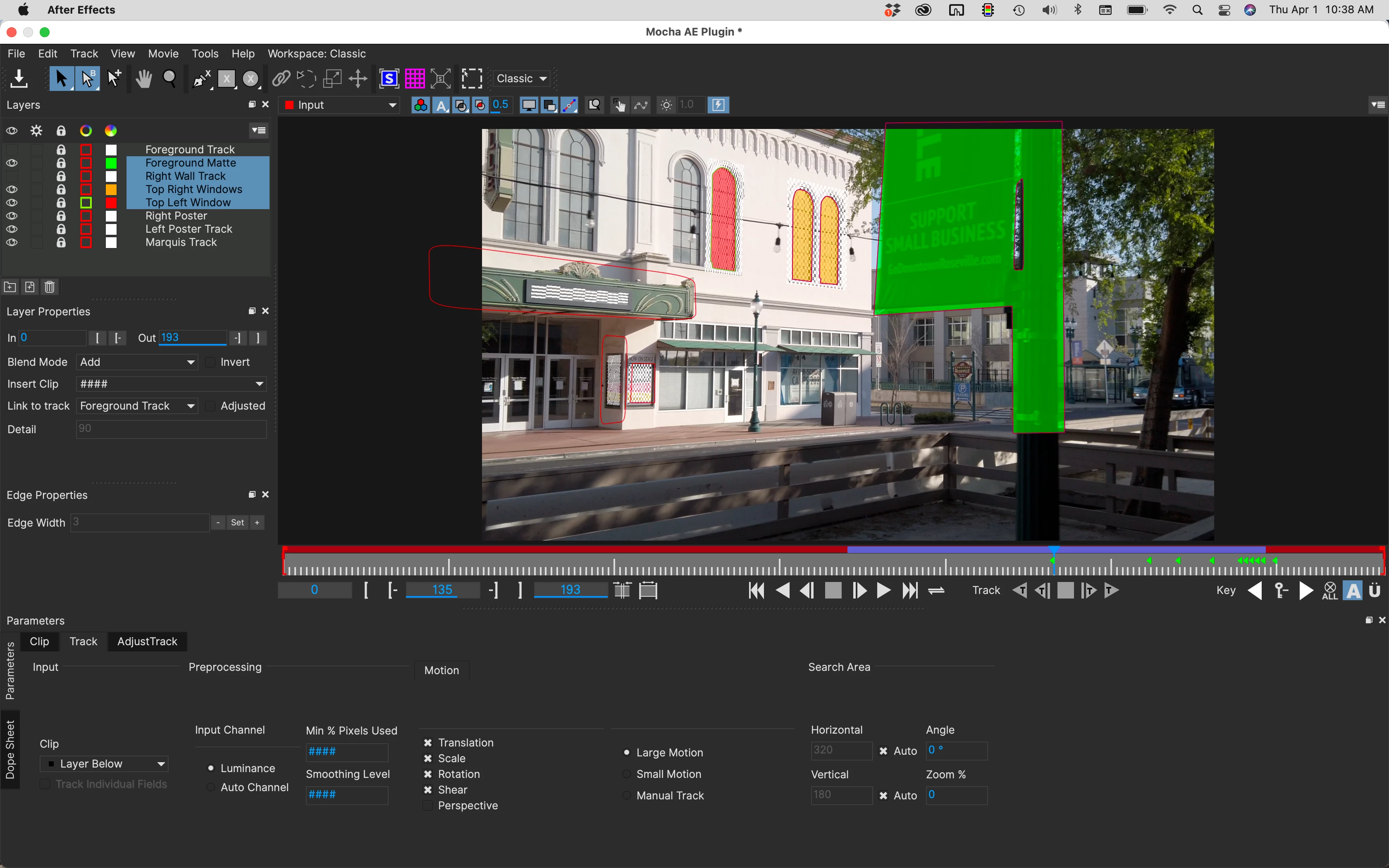

The first thing I did, the top layer in Mocha, was to track the foreground flag, then lock the layer, then create 2 masks for the flag and the pole and lock them to the Foreground Track layer. It required a couple of keyframes for the masks to be tight enough. That layer was not tracked but locked to the track and named Foreground Matte (2).
The next step (layer 3) was to track the left wall of the building. I used a couple of splines and perspective tracked the wall, then locked it and turned off tracking. Then I created a pair of masks for the right windows on the same layer (4) Right Windows because I have a shot of two dancers that will work for those two windows, Because of the parallax change for the inset windows, after locking the window masks to the wall track I needed a few keyframes, but it only took a minute to setup. I did the same for the next window because the other shot I have is just for one dancer. Then I added another layer for the right poster and adjusted the surface to cover the poster. There is a grid on that shot. The Left and right window layers and the right poster are locked to the wall track because they are all on the same surface. No tracking was necessary.
Then I created s spline for the inside wall and a surface for the second poster. That layer was tracked and locked. Then I tracked the Marquis and added a surface to act as the lighted sign.

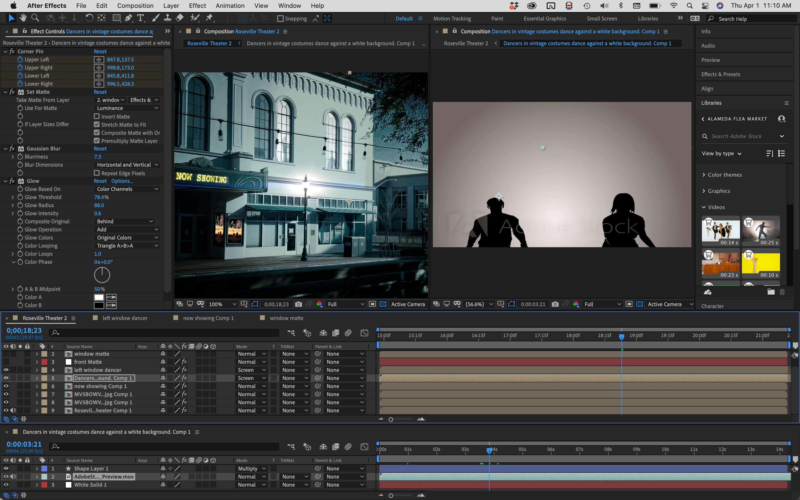

Back in After Effects, I started building the comp by creating the matte layers for the foreground and the Right Wall.
I added my footage for the pair of windows on the right, pre-composed, opened the pre-comp, added a viewer, split the timeline so I could work on both layers, and set up the composite. This screenshot shows the composite with a few of the elements turned on. A scratch Day for Night Lut is applied to the bottom layer (the original shot). One of the streetlights has been added and it follows the streetlight by simple motion tracking. The footage has been added to the windows, and the lighted sign and posters have been added. You can see how I scaled the footage of the dancers to fit the window. The Cancers comp was corner pined using the two window surface I set up in Mocha, I added a few effects. and the composite looks pretty good for this point in the process.

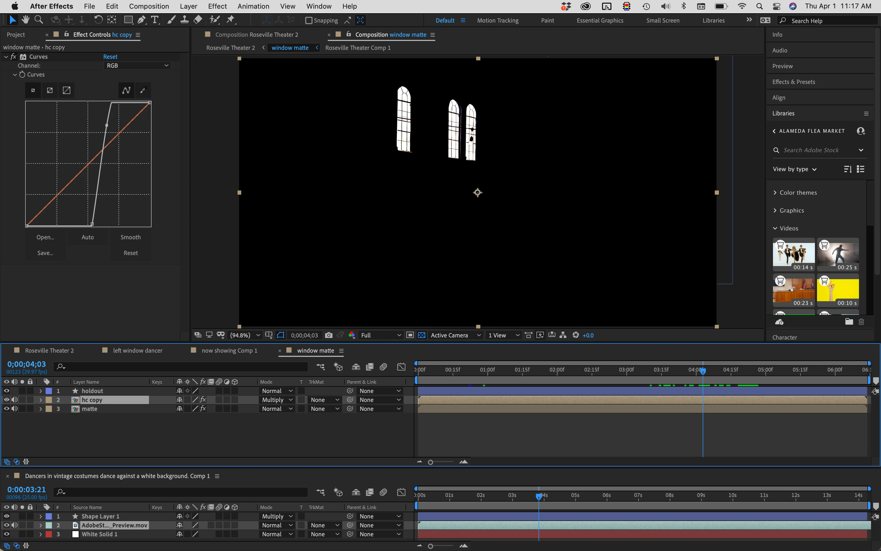

The thing that makes the composite work is the Matte I created for the foreground so I'll explain that. I took a copy of the original footage and added curves to get a very high contrast version of the footage that I could lay on top of the footage to preserve not only the window frames but the light bulbs and wire for the hanging lights. That composite looks like this:

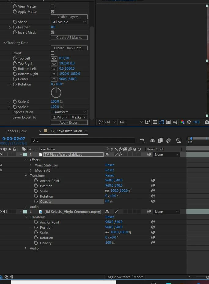

I assume Layer 1is the shot with all the Television sets stacked up that you are corner pin tracking with Mocha AE. You have added Warp Stabilizer to the shot so you should either take it off and motion track or pre-compose the footage moving all attributes to the new comp before you do the corner pin tracking. Warp stabilizer is going to throw off the
Corner Pin tracking a little bit, so either get rid of it or pre-compose.
I assume that Layer 2 is the replacement screen, but its scale is 100%. It just looks like a movie, not a movie of something happening on a TV screen, but a movie of somebody in a room. If you apply the corner pin track to Layer 2 it will line up with the surface you setup in Mocha AE. If the surface needs to be smaller, make it smaller. If it needs to be bigger, make it bigger.
If you need to scale Layer 2 so that it is smaller, then you either have to use the Stabilized corner Pin workflow I outlined or you are going to have to scale it down and pre-compose it before applying Corner Pin. The layer will match the size of the surface you defined in Mocha AE.
If you need to motion stabilize Layer 2 and scale it, the same thing applies. Do all that work, then pre-compose, then apply the Mocha AE corner pin to the pre-comp.

I did download and look at the comp you posted and tried to apply it to my comp. But I have to scale down the video to 10 (90% down from original size) to fit in my target screen but it falls apart when I scale it down. The Mocha AE tracking data does properly track the video clip at normal size but it won't allow me to modify, to scale down the video clip. I have tried six ways to Sunday to track the scaled down clip.  A simple like this should be simple to achieve. Hence, my doubts that Mocha is the right tool for this job.
Your workflow works for still images but not for a motion video source that is scaled down. And if I transform to fit the comp, then I will be working with an comp only 190 or so pixels wide. It doesn't make sense. I guess I don't understand the logic involved, it's way to convulted.

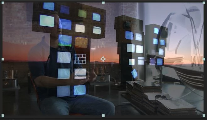

In any case, I keep deleting the comp and starting from scratch with no results. Here are the images of a simple test comp that isn't working as well.
I lowered the opacity of the TV installation so you can see what I am dealing with. Notice that Mocha data does not scale down the background video to fit inside the mask. That should a simple process. Again, I don't think Mocha can track scaled down video. I read elsewhere that it can't.
A pic of the controls.
