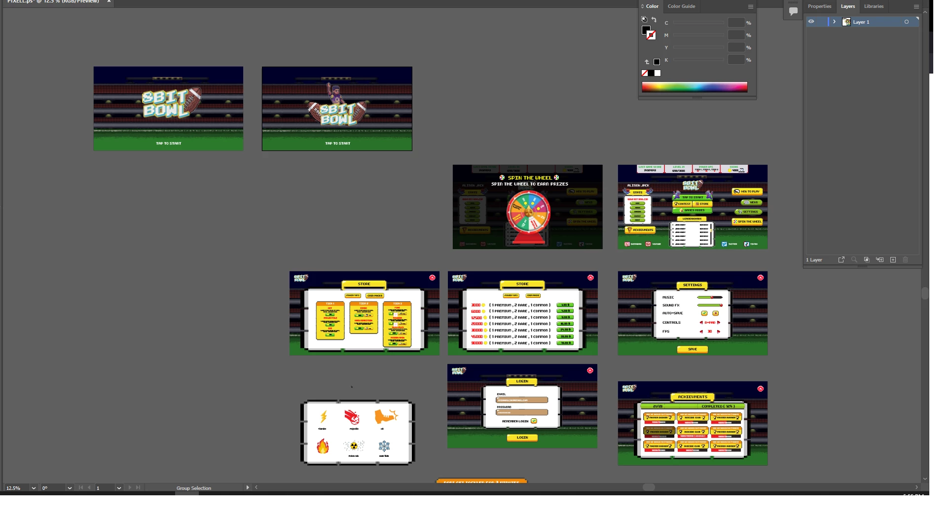

How do I transfer files from Illustrate to After-Effects if everything is on the same layer? My UI guy put everything on the same layer but I can't transfer anything to After-Effects.
July 2, 2022
It looks like the Illustrator file has multiple artboards. That is the first mistake. If you want to fix it, you must have Illustrator installed. The first step is ensuring that the Document Settings are in pixels or points. The second step is to check the size of the Artboards. The third would be to go to the Layers panel and see if you can make sense of the layers. The end goal is to have every element you want to animate on a separate layer. If there was some planning and grouping, you might be able to get away using Release To Layers Sequence in the Layer Panel Menu and then dragging all of the new layers that were created when you Released to Layers above the original first layer. If there is no planning, you will have to make a bunch of new layers, then drag objects into the appropriate layer using the Layer Panel.

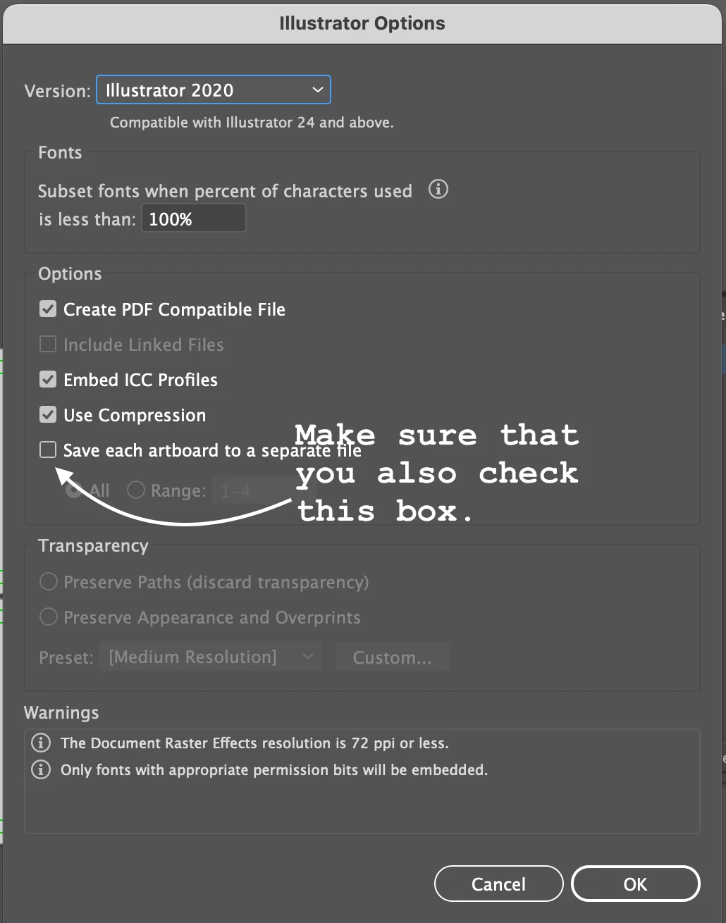

The last step would be to do a Save As and carefully check the Save options. It will look like this:
