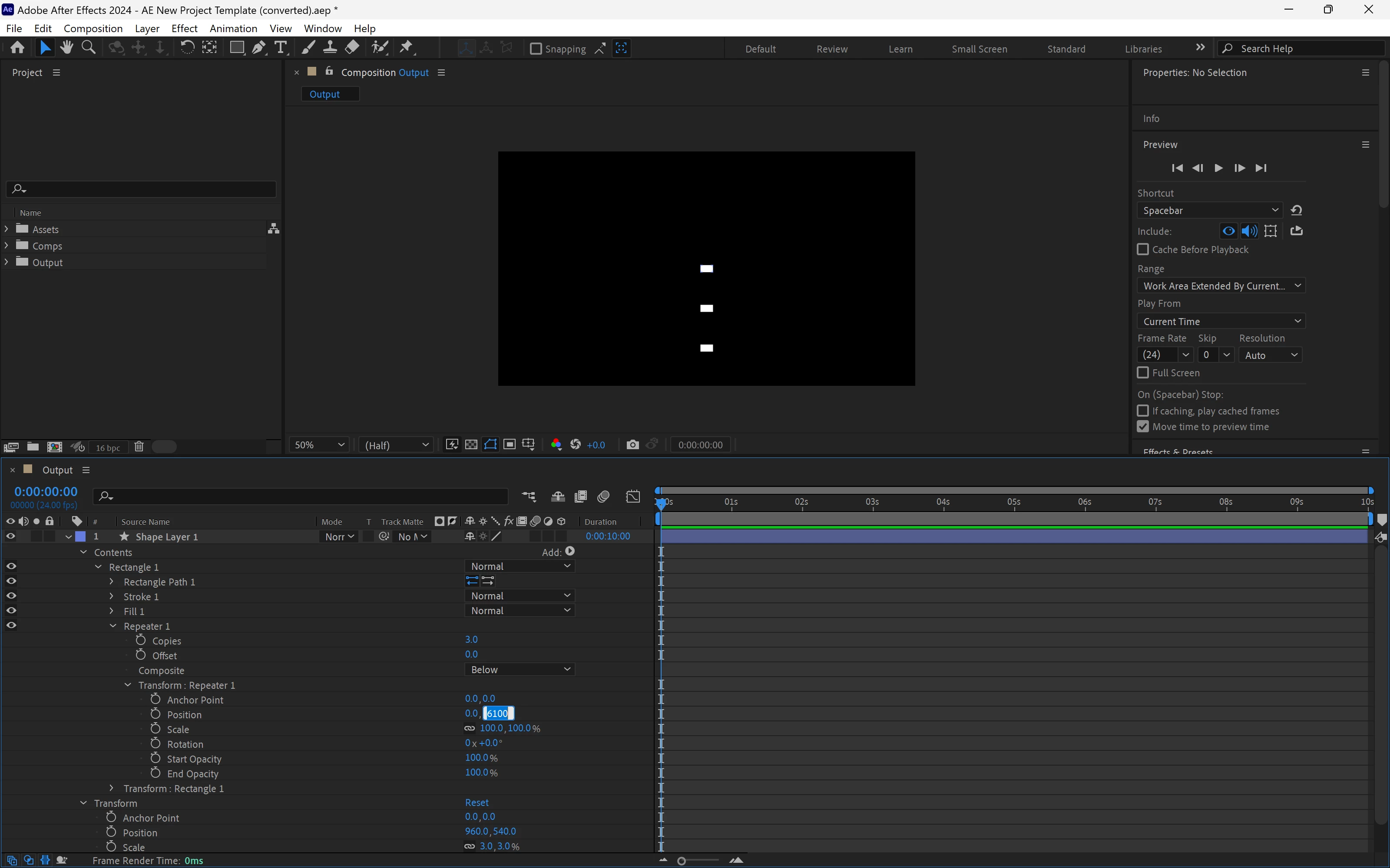

Resizing the Rectangle 1 shape will be more efficient than scaling the layer down to 3% and then adding the repeater. The renderer looks at every pixel on every frame and then runs calculations. The render time will increase if you scale the layer down by 3% instead of reducing the Rectangle size by 97*.  When the offset value is 6000 it doesn't take many copies to exceed the maximum frame size that After Effects supports.
Reduce the size of the rectangle, and then hold down the Ctrl/Cmnd key while dragging the Y position offset to accurately drag a value by 1/10 of a pixel instead of a whole pixel.
I multiplied the X value of a comp-sized rectangle by .03 to give me an effective scale of 3%. Then I added a Repeater, changed the Transform Position value from 100, 0 to 0, 100, then held down the Ctrl/Cmnd key and clicked and dragged the Y value to get this result:
Unless there is a specific reason that I don't understand, just reducing the size of the rectangle and setting the scale to 100% should solve your issue. I hope this helps.

Oh wow thank you so much for such a detailed answer! I really appreciate you taking the time to do a screen recording. Yes - rezing instead of de-scaling solved my problem. Again, thank you!! I wish you a good day~

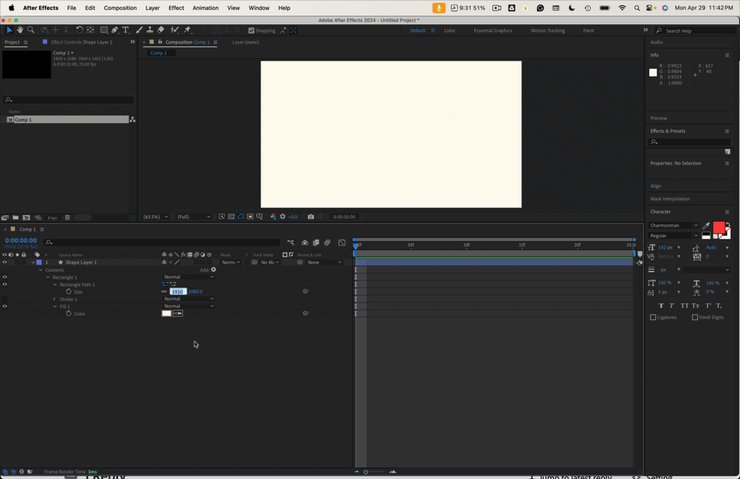

Here's the screenshot example:
