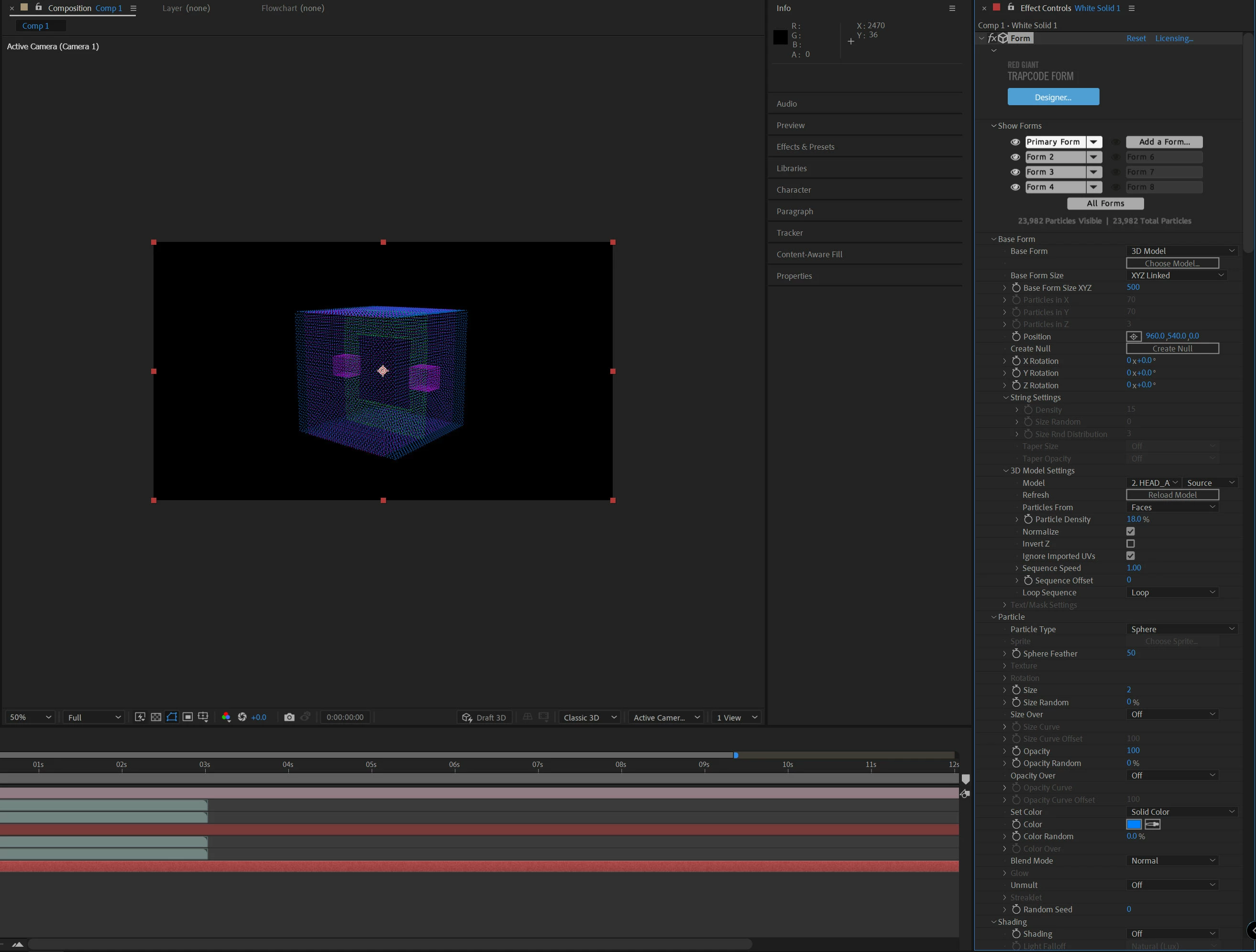

I have a 3d logo face c4d (example) with separate layers I want to rotate on the head axis 0,0,0 but there’s a problem.
1. the c4d setup has all the layers with the same axis point as "head" (refer to pic 1)
I've exported each 3d layer as a separate cineware c4d file, imported them into ae and made 4 layers in form

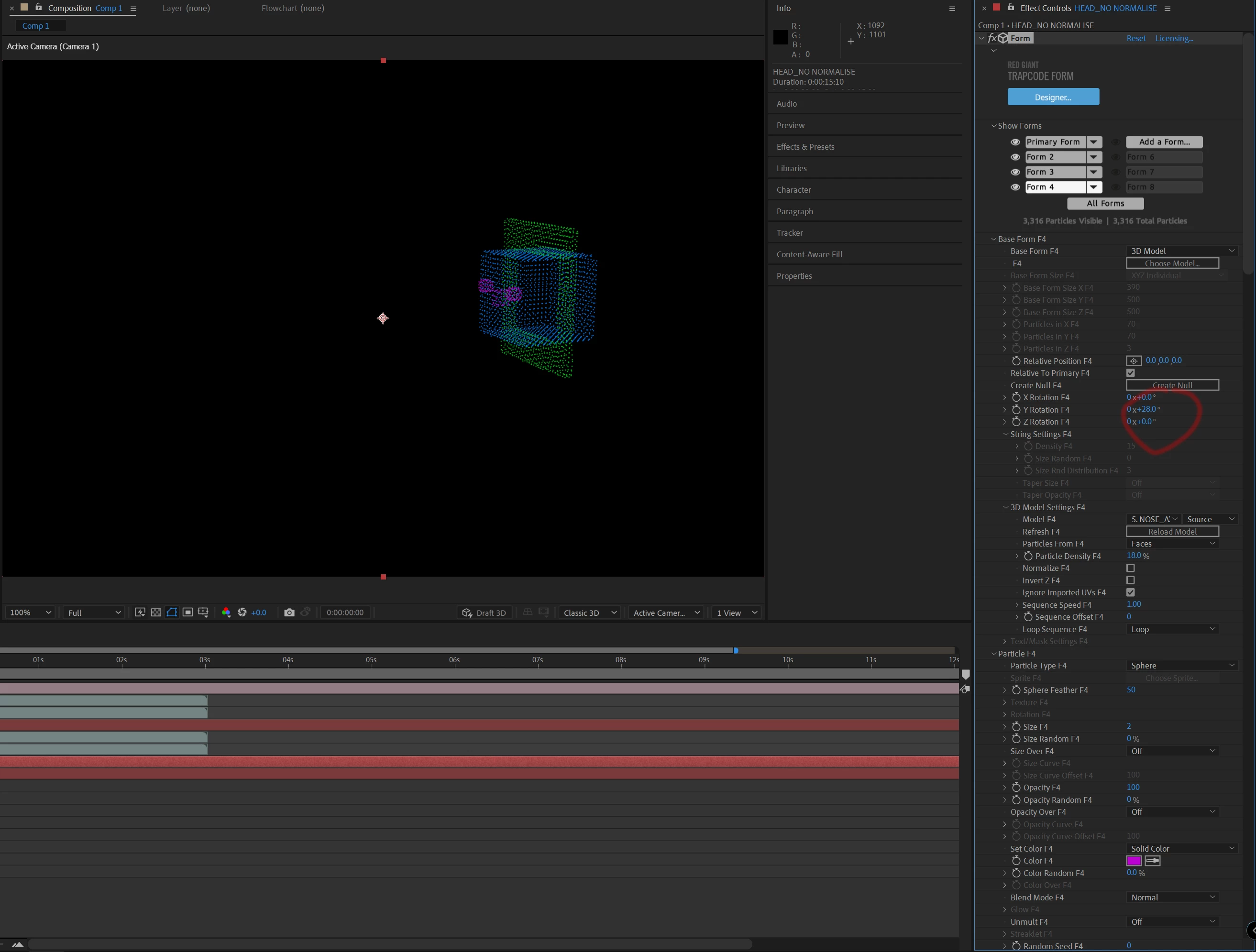

  1. if I don’t normalize all the layers I bring in, they line up perfectly and looks like this: (refer to pic 2)

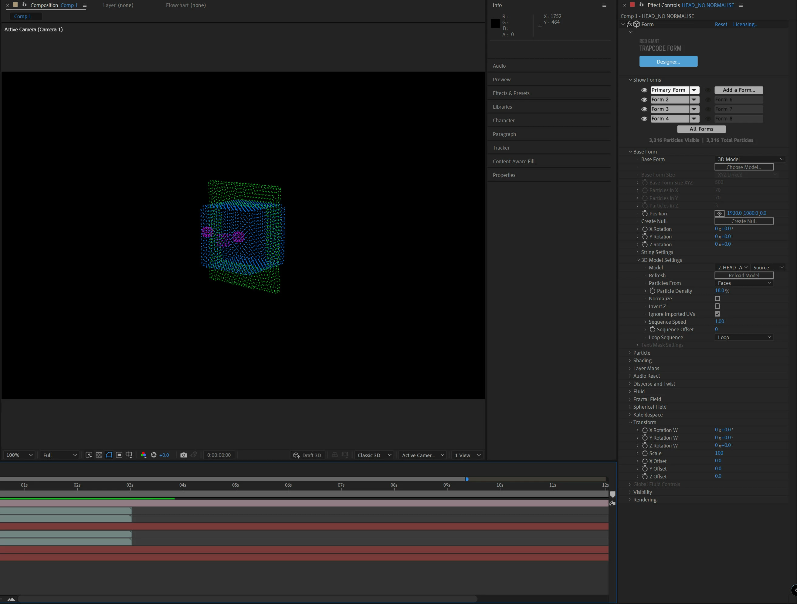

3. If I normalize them all it looks wrong like this: (refer to pic 3)

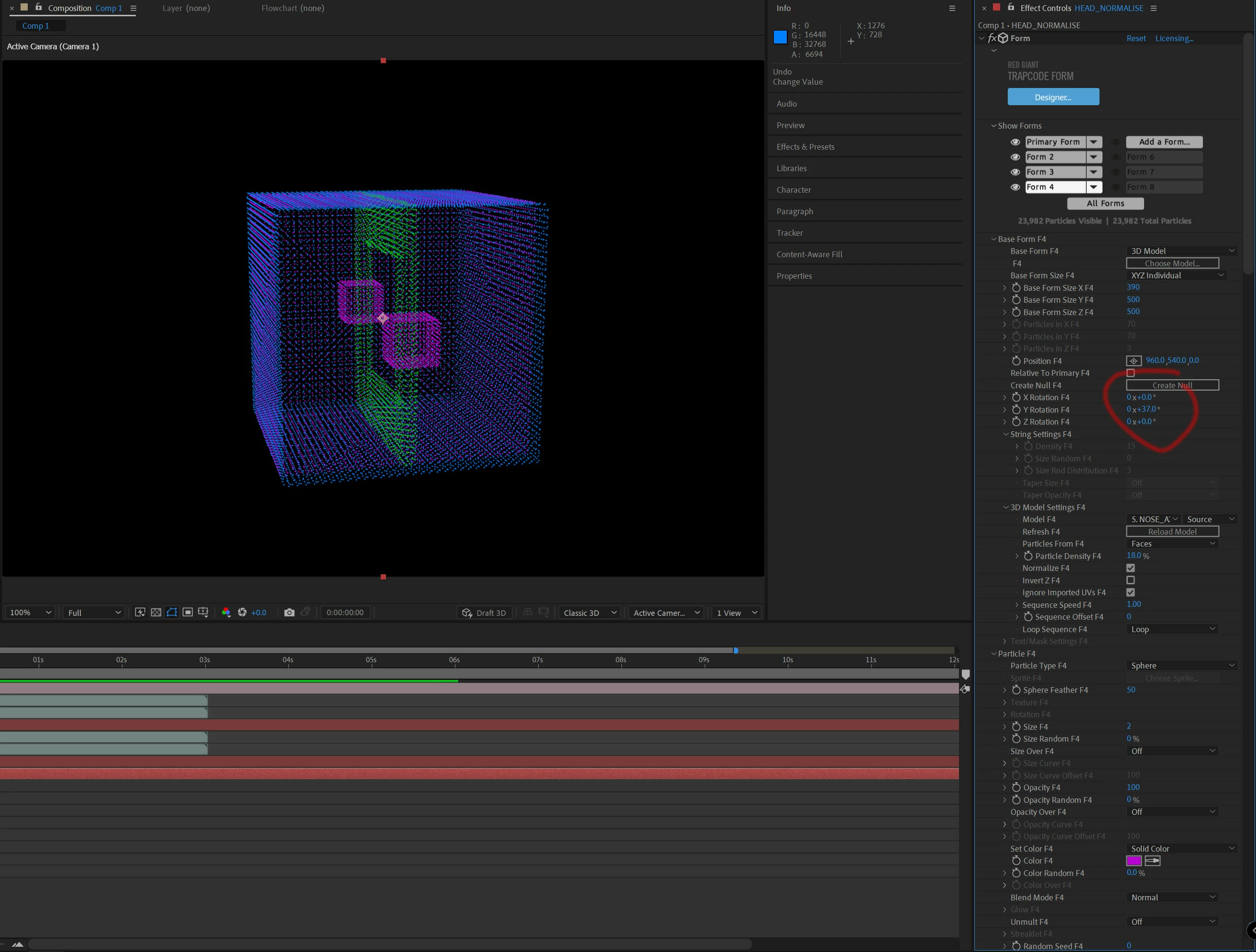

4. So the non-normalize looks correct so i use that, but when i rotate on the axis it has a weird axis it defaults on : (refer to pic 4)

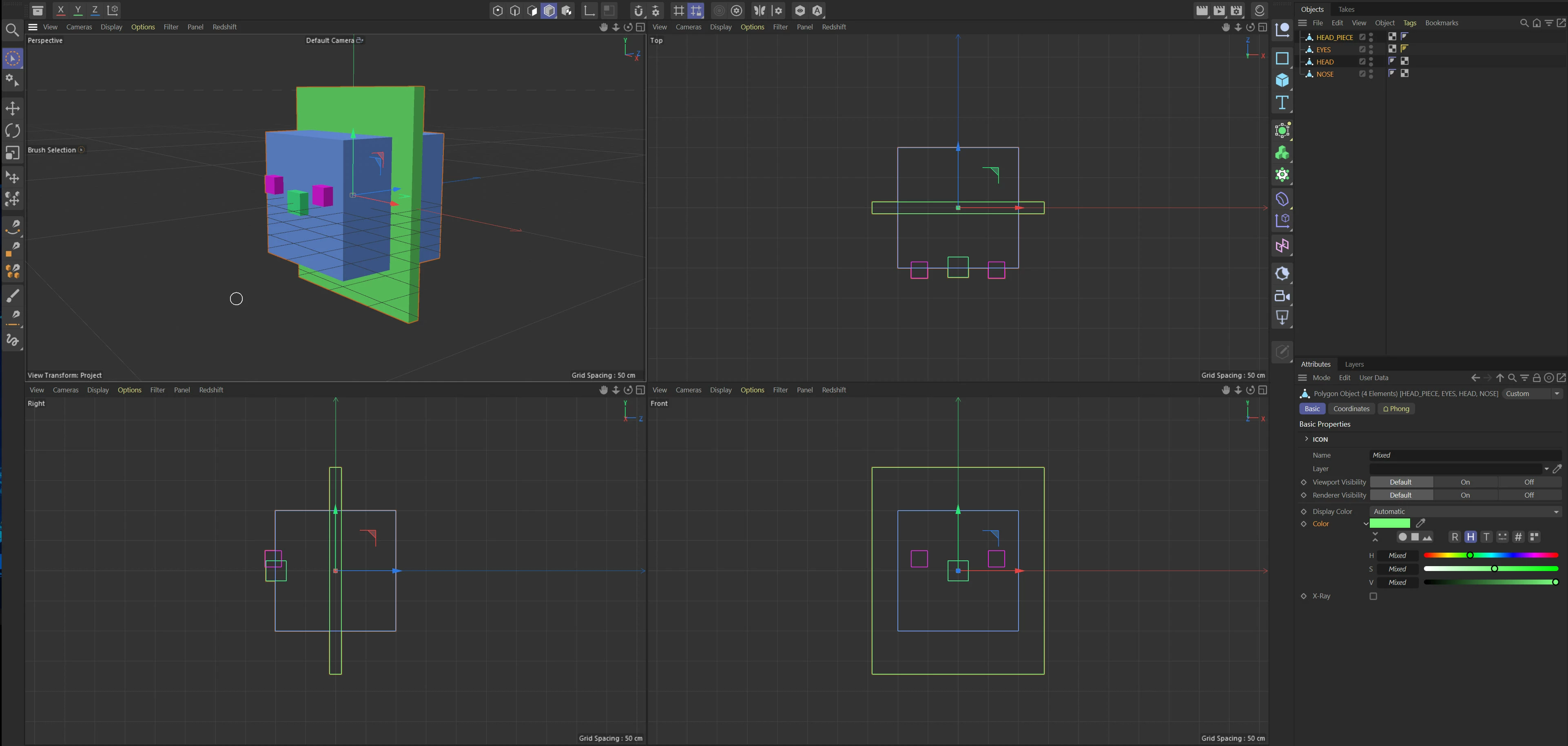

5. the normalize version rotates perfectly on the axis: (refer to pic 5)
So the issue is how do i have each 3d layer placed properly in the normalize version to use the perfect axis rotation i need? Or how to use non-normalise and change its axis point to the center of the head?
