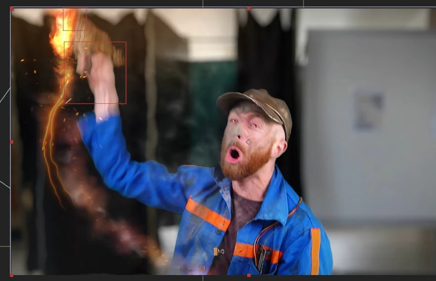

Here's how I made it work with particle world AND the fire comes from particular (I found that it works with this sprites and presets) :

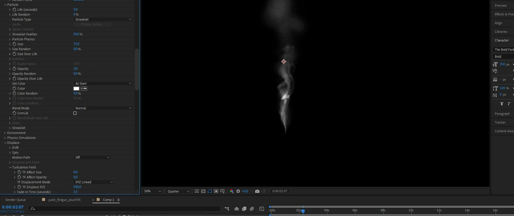

Here's the setting pannel for the smoke I wanna use, I tweaked it a little since, to thicken it, but it's essentially the same :

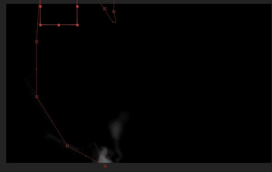

And here's a test I made, you can clearly see that the smoke is here but it scatters in strange ways and don't follow the path as well as the other smoke from particular world :

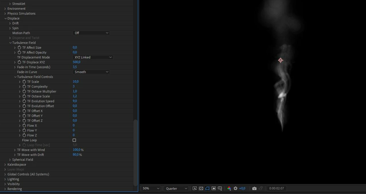

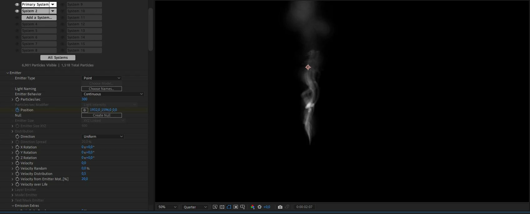

PS : Here's the particular setting in full res, sorry for that I screwed up
Particular 1
Particular 2
Particular 3
