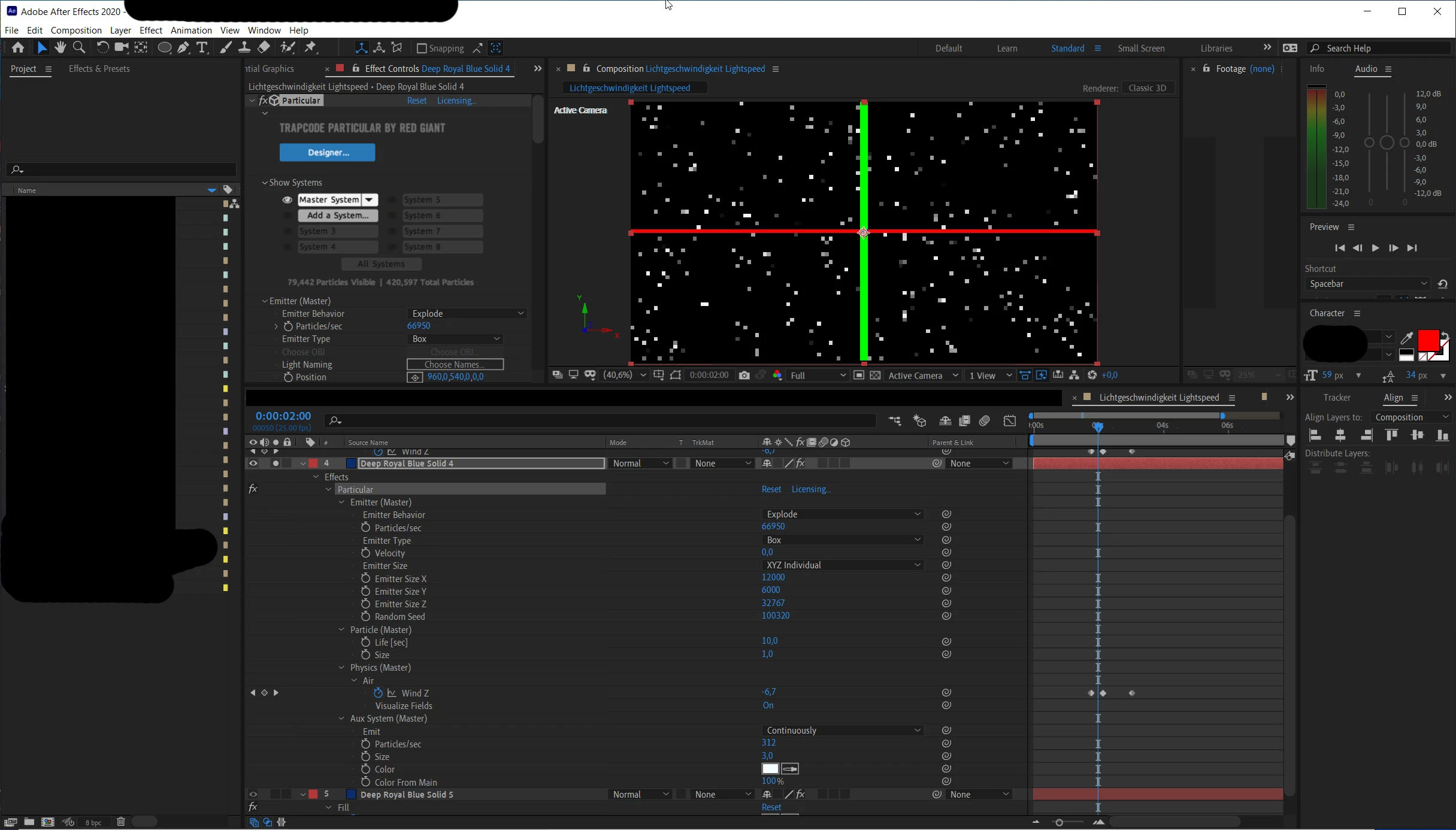

I created a solid and dropped Trapcode Paticular on it. As usual there is a green/reed marker that shows me where the center of the emitter is. For some reason this marker gets rendered into my video. I even asked trapcode and they said it's an Adobe thing as the marker comes from After Effects. How can I get rid of this in my export?! As the camera flies towards this the marker gets bigger until it passes it. (Image is attached)
Setup is After Effects 17.1.3, Particular 4.1.5, Geforce RTX2080 Ti (with latest geforce driver), Ryzen Threadripper 3960X, 128gb ram

Hi Richard, thanks for getting back to me. Here is a better screenshot.

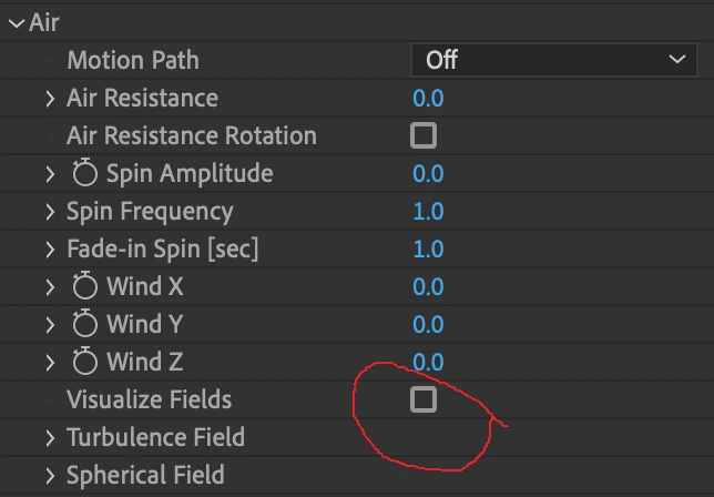

Yep, I see in your screenshot that visualize fields is on. You need to turn that off.
Szalam
September 23, 2020
If I'm seeing your screenshot correctly, that's not an AE thing and that's not a marker for the emitter. That's the turbulence field visualization. Under the physics>air section, there's a tickbox to visualize the fields (it shows the turbelence, spherical field, etc.). You need to turn it off.
September 23, 2020
Thank you so much!!!! That's it. 🙂
