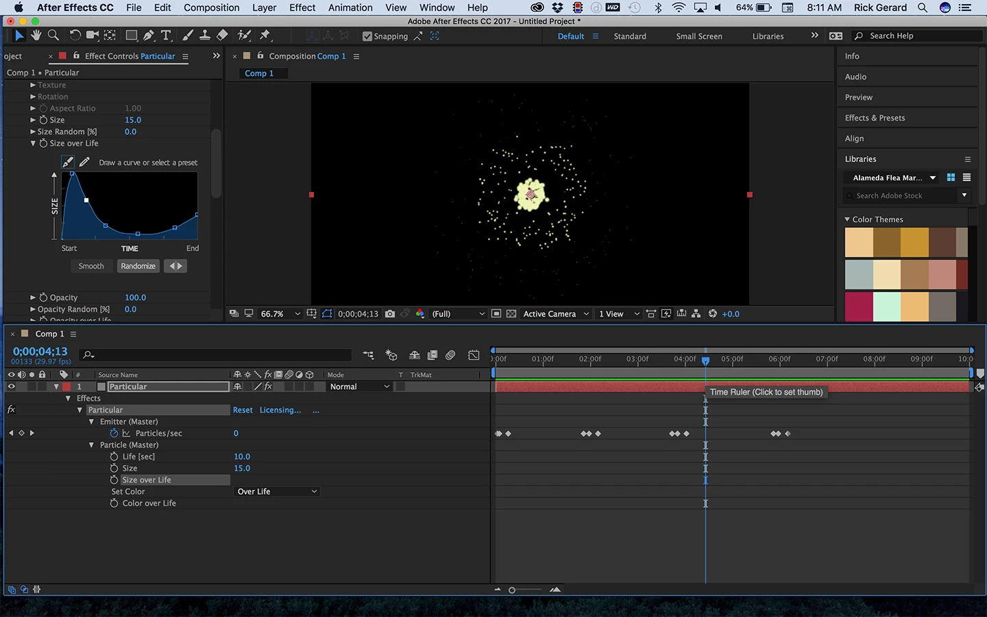

Something like this would get you started on seeing how animating the number of particles per second makes them behave.
The sets of 3 keyframes go from zero and 1000 and then back to zero. The size over time is animated by the curve you see in the effects control panel. Every time there is a group of 3 keyframes a little explosion happens, the particles get bigger very quickly then the size goes down. The results look something like fireworks going off. There are remnants of the first explosion on the outside, then the second explosion a little bigger and closer to the emitter, then the third explosion is just getting started.
The visual perception of motion is delayed compared with the keyframes so when you are using sound keys to generate the keyframes you'll have to shift some things around in time so the movement matches the beat.

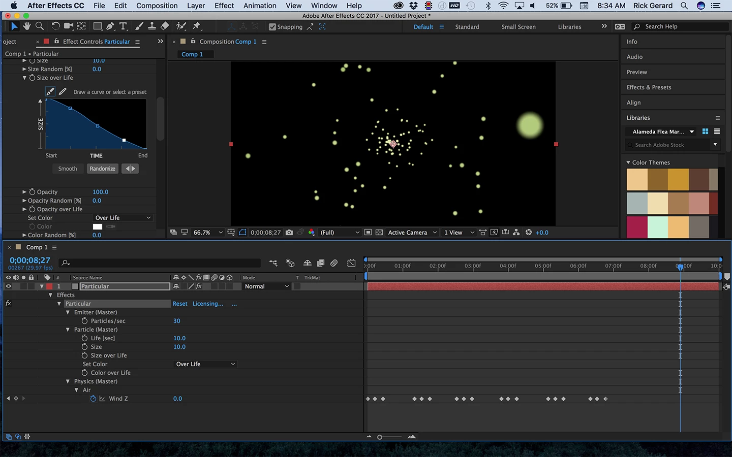

Your example video does not show an increase in the number of particles, it shows a change in speed towards the camera. One way to do that using Particular would be to animate the speed of the wind in the z direction with the default camera. Here's how you would set that up to experiment with the range of values you would need sound keys to generate. Size over time may help keep the particles from getting too big as they approach the camera.
In this case the groups of 3 keyframes for Wind Z go from zero to -6000. Your values depend on how much you want the speed to increase.
Once you figure out how to move the particles in their 3D space you can figure out the range of values you need to set to get the movement you want.
