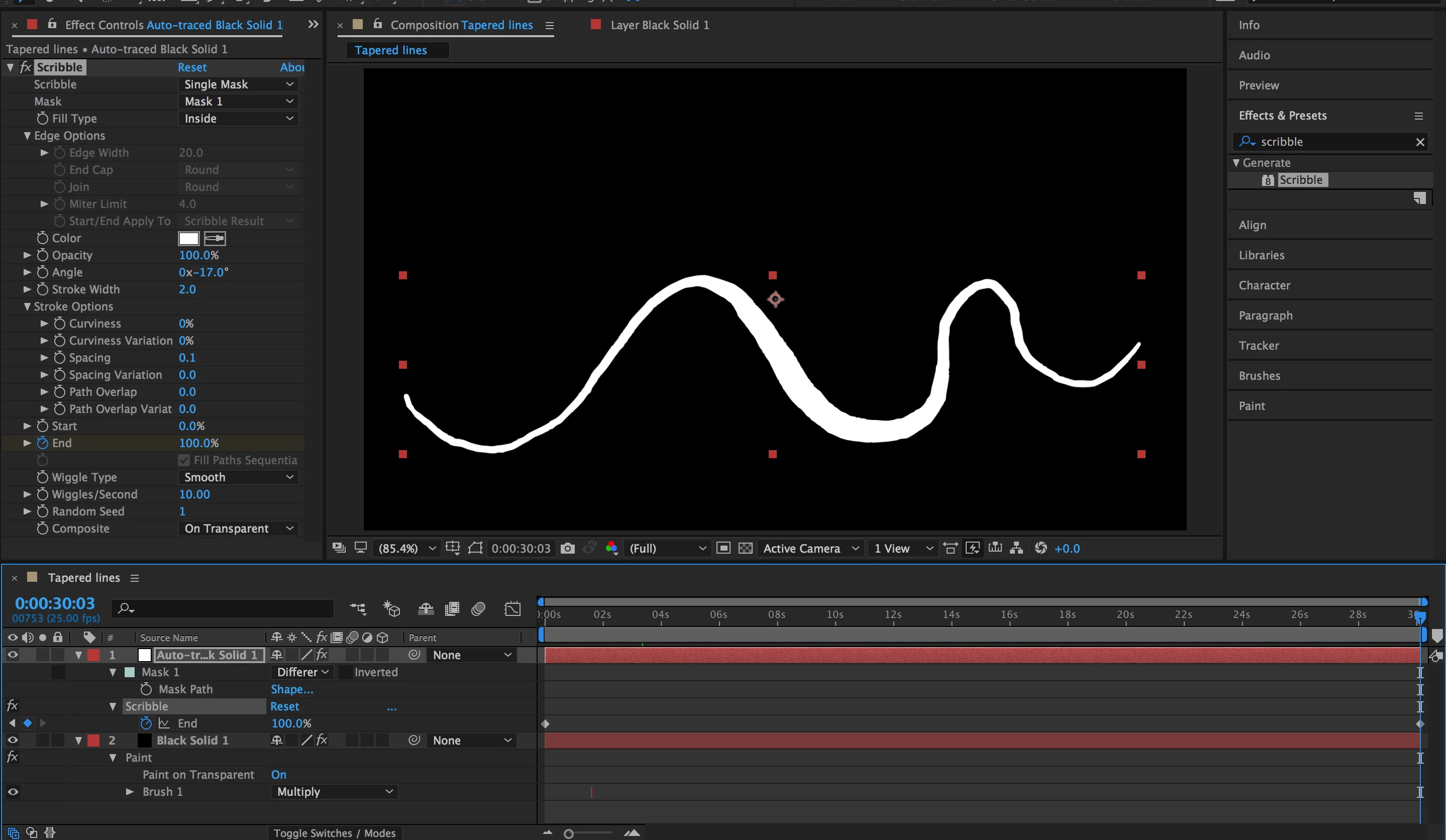

    You can't do this with a Shape layer but what I've done in the past is to use a pressure-sensitive brush to draw a tapered line. You'll need a steady hand and a wacom tablet to do it. Once you've drawn it you can then Auto-trace it onto a new Layer as a mask. Then Apply the Scribble effect and zero all the Stroke variation settings (as in the diagram) Animate the End value to make it reveal. You may need to also animate the Angle setting to get the leading edge to look right.
