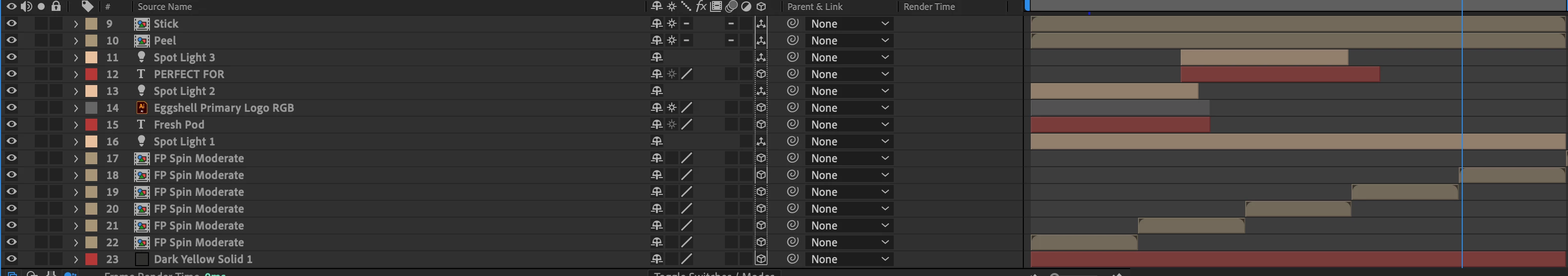

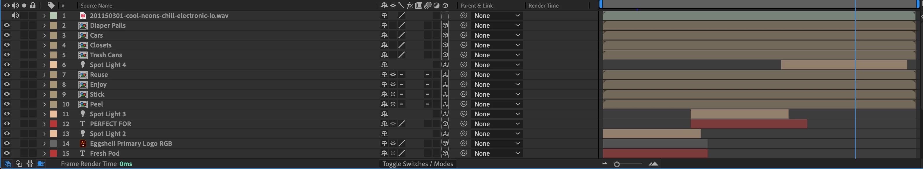

Every time I export my file via Media Encoder (as an .mp4) or the Render Queue (as a .mov), my video comes out either white (.mov) or just black (.mp4). I have 4 Spot Light layers in my file that look amazing in the AE working file, there's nothing wrong there. When I export, they disappear. How can I successfully export this will all the Light Layers appearing as visible, as they do in my working file?
For reference, I have the camera angle/view set to "Front"
I've included photos of my timeline and layers below.

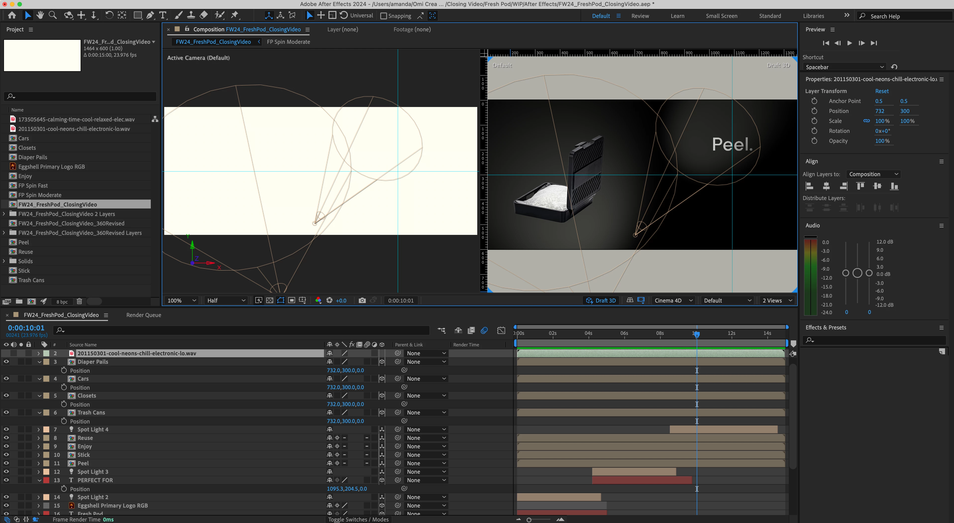

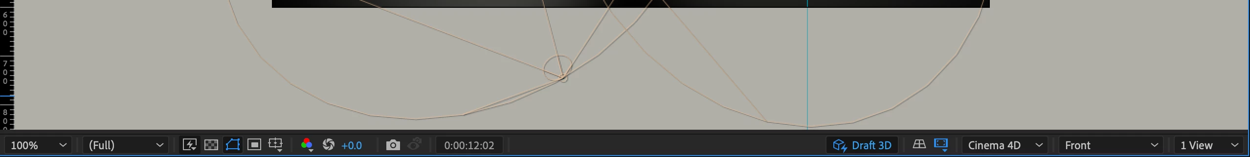

Front and any other view are just for reference. You need to set your view to Active Camera to see what your comp actually looks like. You also need to turn off Draft 3D, as that's a preview mode made to help you work faster, but it's not your final render. I'm guessing if you change these two options, you'll see the same thing as when you export from AME.

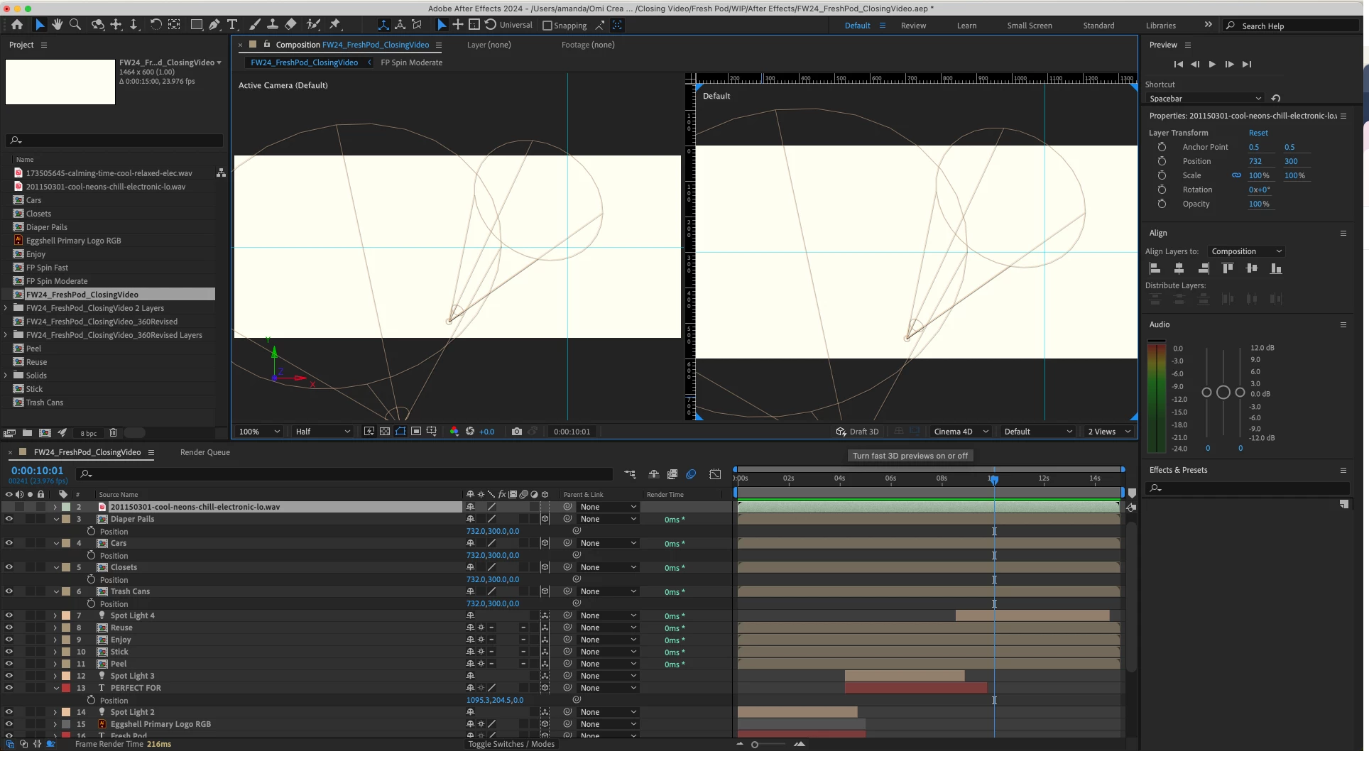

Thank you, David! I'm relatively inexperienced when it comes to using layers that provide 3D effects. After doing what you suggested, my file is now showing exactly what has been rendering, which is just a white screen basically. Do you think that if I'm missing a camera layer, that could also be why this is not rendering out correctly?
I think I'm going to start from square one and restructure the file. I am determined to get this video exported.
May 30, 2024 2:13 PM UTC
Even when you don't have a camera layer, there's actually a default comp camera. So it seems like you moved that. Yes, you can add a Camera to fix this, but it's still good to understand what's going on. If you go to Layer > Camera > Reset Default Camera, I'm guessing you'll see your objects again.
