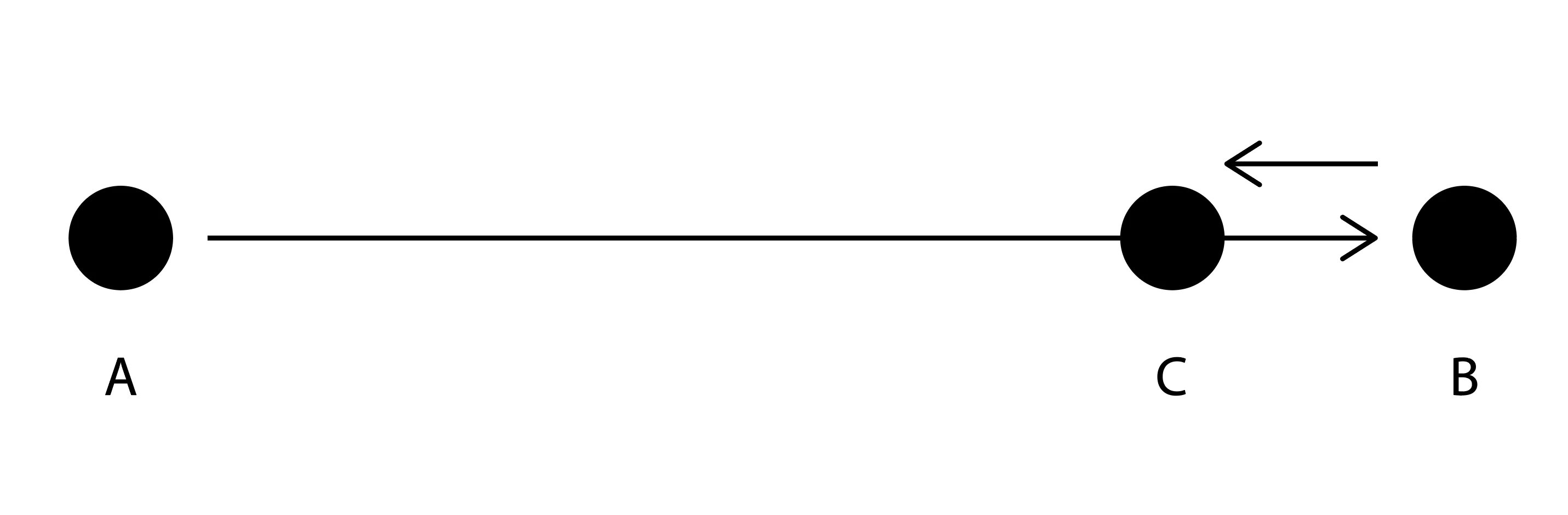

I am trying to make a very simple position transition as below:

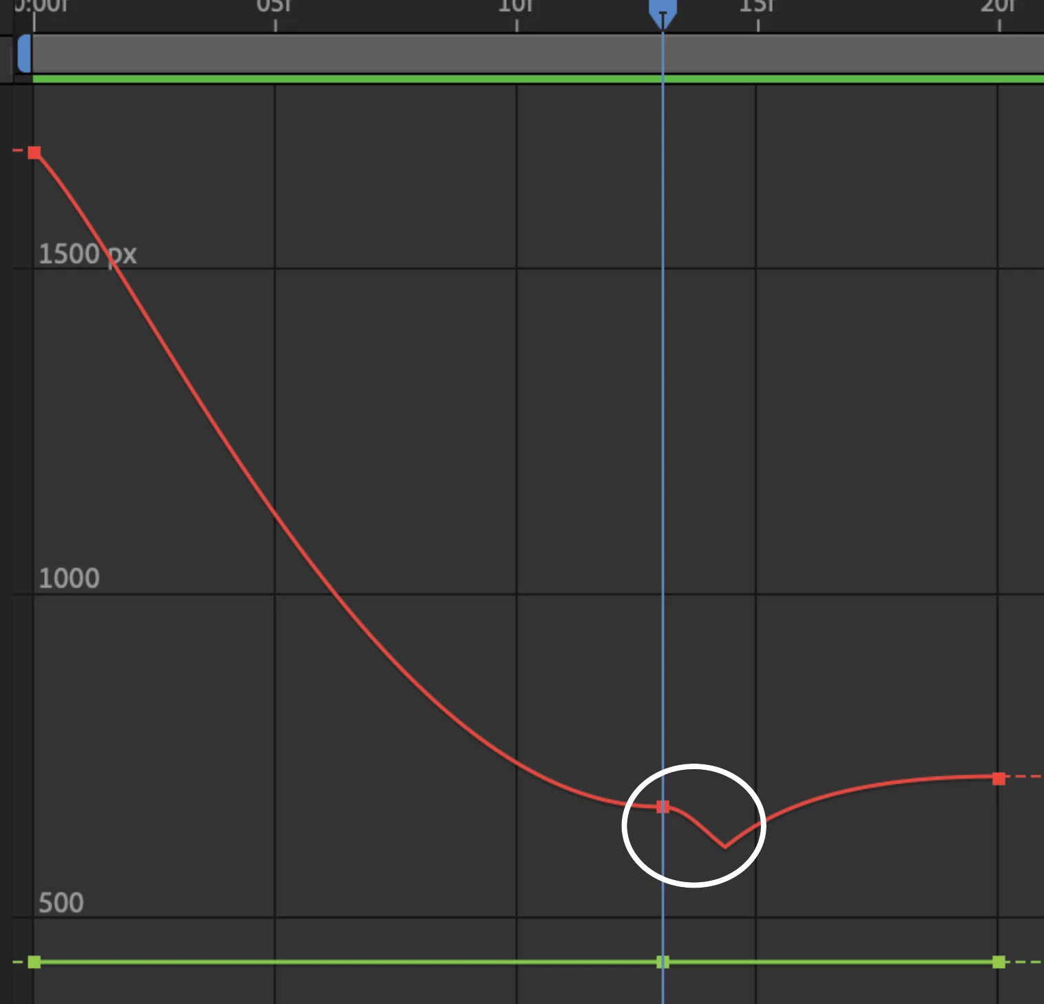

Animate an object from point A to B and then back to point C a bit. After set up those keyframes, I found the animation is not smooth, so I opened the value graph and found:
There is a "tail" after point B, so I am wondering how can make it smoother?

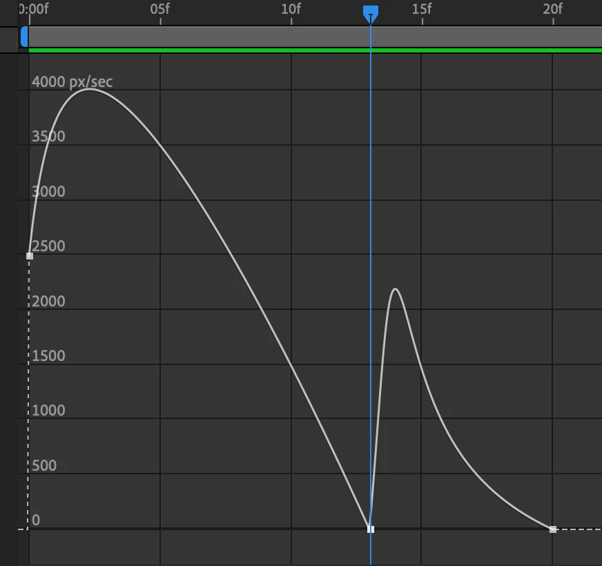

More reference, the speed graph is like this:

The answer is pretty obvious even if you did not select any points to show the tangents: These are tangent kinks because the incoming tangent of point C is wayy too far extended and interferes with point B's out-tangent. You need to tweak that stuff suitably or add an extra inbetween keyframe if necessary.
