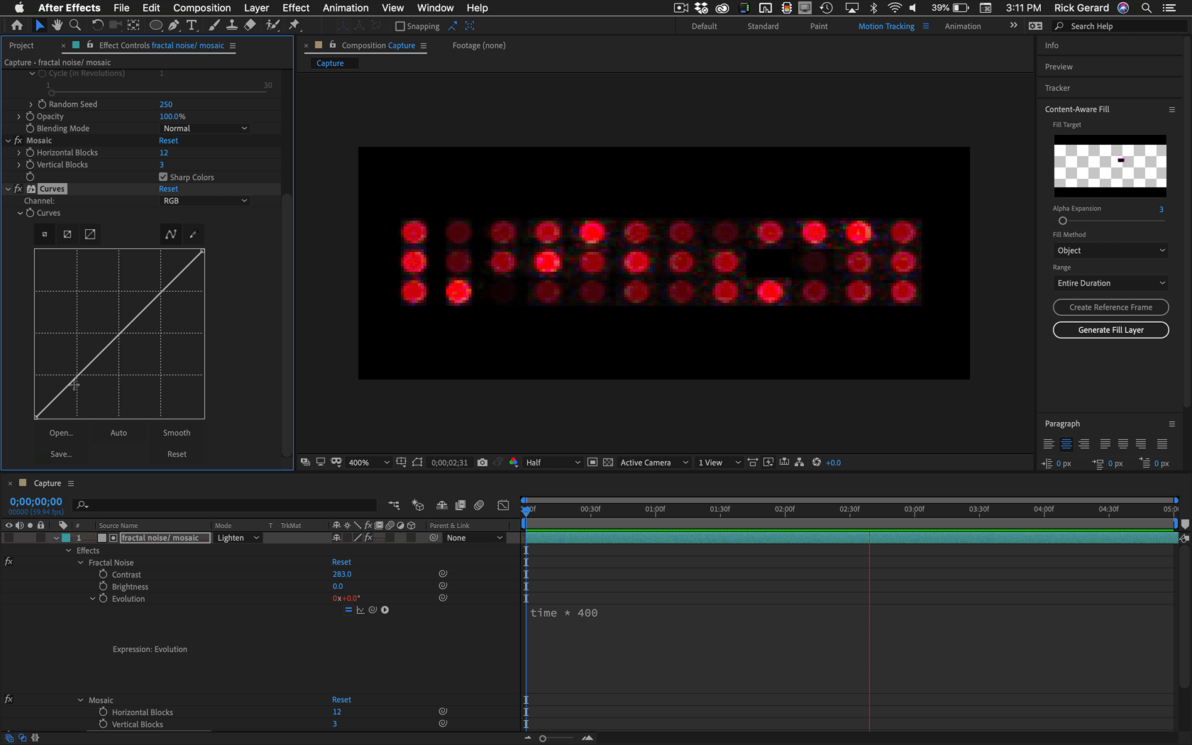

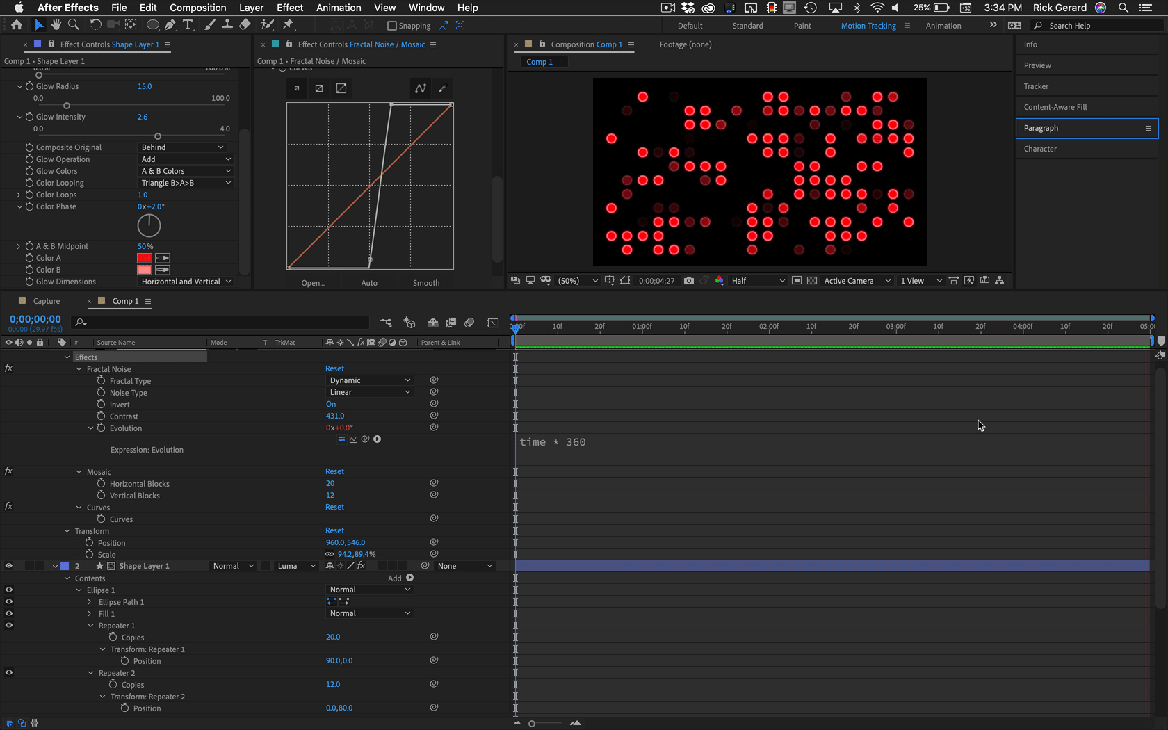

  • Create or scale a gray layer so that it is the same size as your array of dots
  • Set the blend mode to overlay so you can see through the gray layer
  • Add Fractal noise and Mosaic
  • Set the rows and columns in Mosaic to match the rows and columns of dots
  • Animate Fractal noise to get a random pattern you like
  • Set the animated solid as a luma matte for the dots layer
All done. Add exposure or glow to the dots layer to enhance the effect. Adding curves will also help adjust the look.
It should only take you a few minutes. It will be a lot better if the dots are on a separate layer. One shape layer, one ellipse, two repeaters, one scaled solid, 5 total effects and about 5 minutes will give you something like this:
Rick GerardCommunity ExpertCorrect answer
