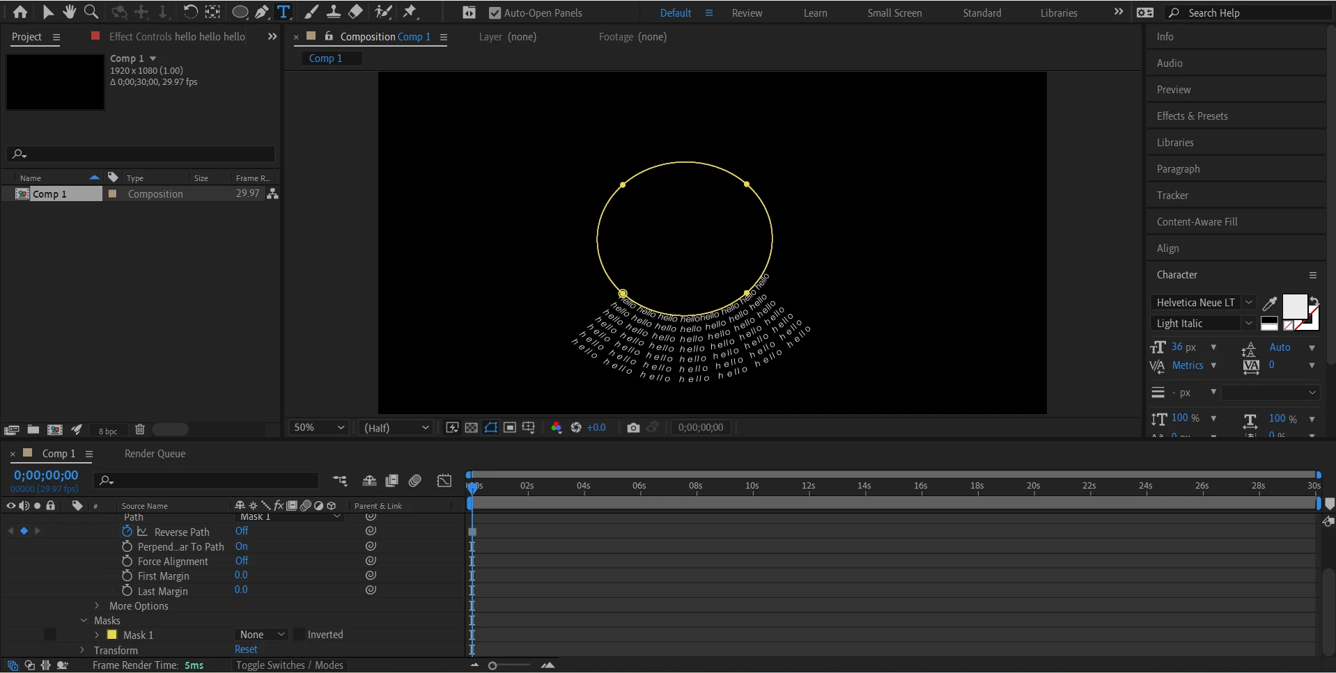

Hi there I was hoping someone could help me with a problem that's driving me nuts. Ive created this animation before but for someone reason the type isnt following the whole path.
For example I create the type, create the circular mask the type will follow, but when I want to fill type round the whole circle it just creates another line instead of following the circular path.
I know this must be an easy solution but im at a loss on how to fix it.
Correct answer Rick Gerard
You probably created a type area by dragging out a rectangle when you created the text layer, or you hit return. You won't get the type to stick to the path unless it is all on one line.

Thank you Rick, I knew it would be something as simple as that. Much appreciated!
