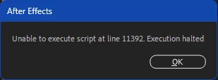

Unable to execute script at line ####. Execution halted.
When I move a layer down more than one or two steps using the shortcut Ctrl + [ .. this message appears.
Note: this doesn't happen when:
- I move the layer up.
- I move the layer down using the shortcut Ctrl + Alt + Arrow down

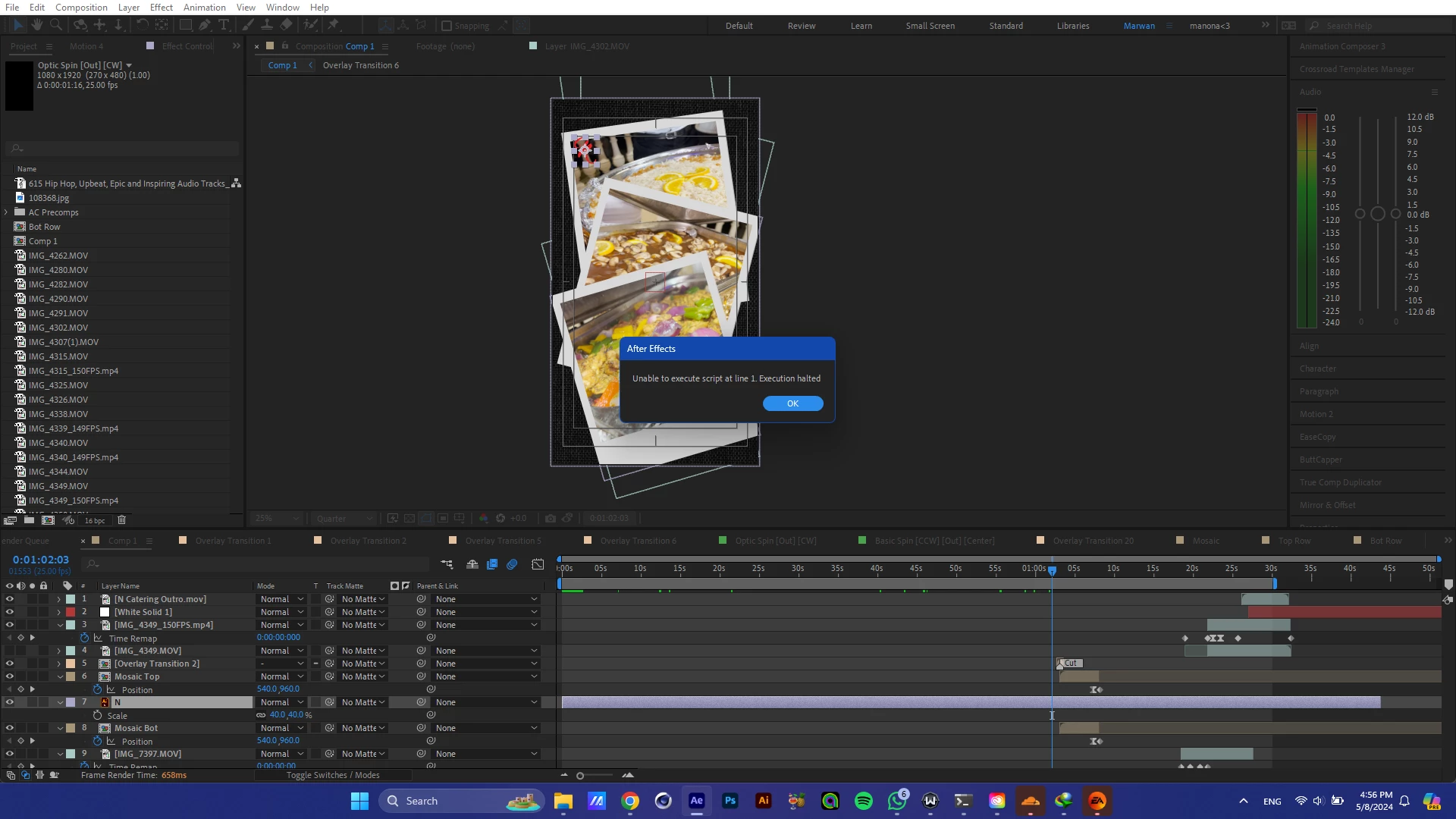

Thank you for the system info and the screenshot, @Marwan167. I don't see any third-party panels docked in your workspace, but do you have any third-party extensions, panels, or plug-ins installed currently?
I ask because After Effects on its own does not run any scripts when you reorder layers with Ctrl + [. However, some third-party tools continually "watch" the project for changes, and this might be a case where a quick action is causing the third-party tool to fail.

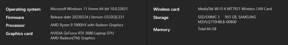

I am using After Effects version 24.1.0 (Build 78).
I am operating on an Asus Rog Strix G15 laptop
and these are the specs :
The error happens when I press Ctrl + [ quickly or keep the buttons pressed.
and this is a full screenshot of my whole workspace:
Thank you.
