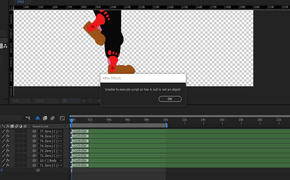

Hello!
I'm trying to write my first script for after effects but I keep getting this message 'unable to execute script line 4. null is not an object.' What does it mean?
Thanks!

Yes, fair point. I want to add an expression to the position property of a selected layer, but obviously I am not selecting the property correctly. For example:
var comp = app.project.activeItem;
var layer = comp.selectedLayers;
var prop = layer.selectedProperties;
function bdy(){
    prop.addProperty.expression =
    'y=Math.sin(t*2*Math.PI)*10;\n' +
    'value + [0,y]'
bdy();

Take a look at line 4 of your code.
Say line 4 looks like this:
layer.name = "new name";
then the error means that "layer" is null and not an object that has properties like ".name" (and it is your job now to figure out why it is null).
Typical scenarios for this are that app.project.activeItem is null, for example, when there is no active item (i.e. no active comp and nothing selected in the project panel).
